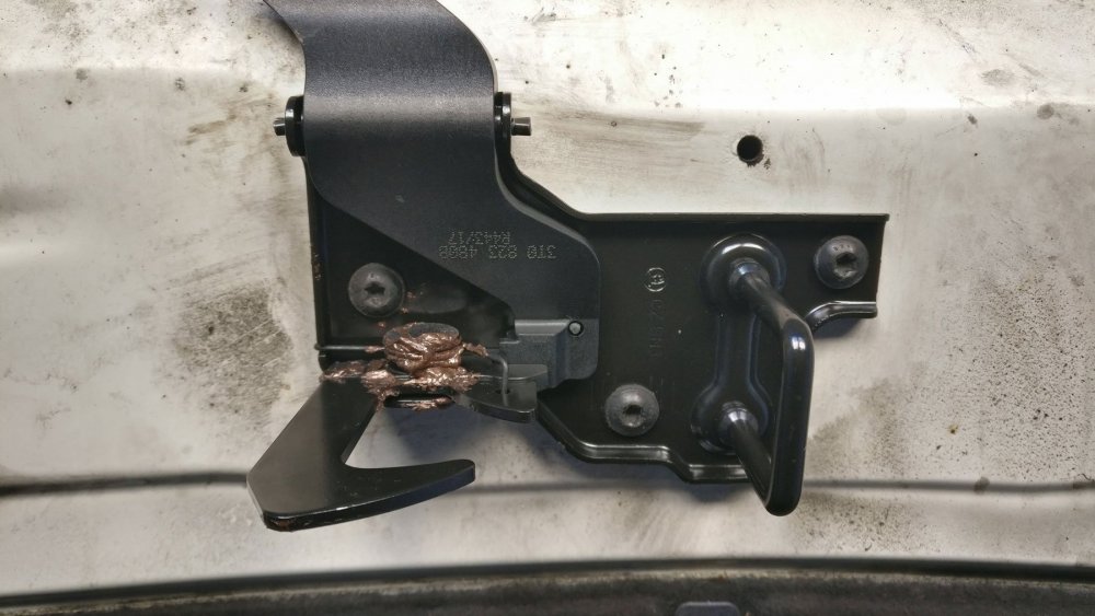

This image may help.
The lever is just off the top of the image, but you can see how lifting the lever moves the catch or 'hook' to the left...
skoda-hook.jpg.b7bdfb9d25f44400a59cd346387f314f.thumb.jpg.9a2ac9c8022e26d779438f04b967f92e.jpg
Just now, blueboy1970 said:
Thanks for th ephoto- yes Mine looks very much like that once I got to it and greased it. I'll certainly be keeping an eye on it in future- thanks for the help.
