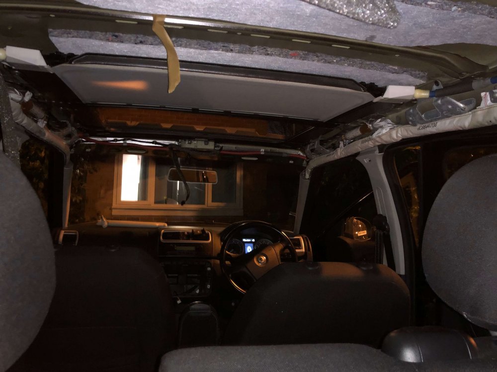

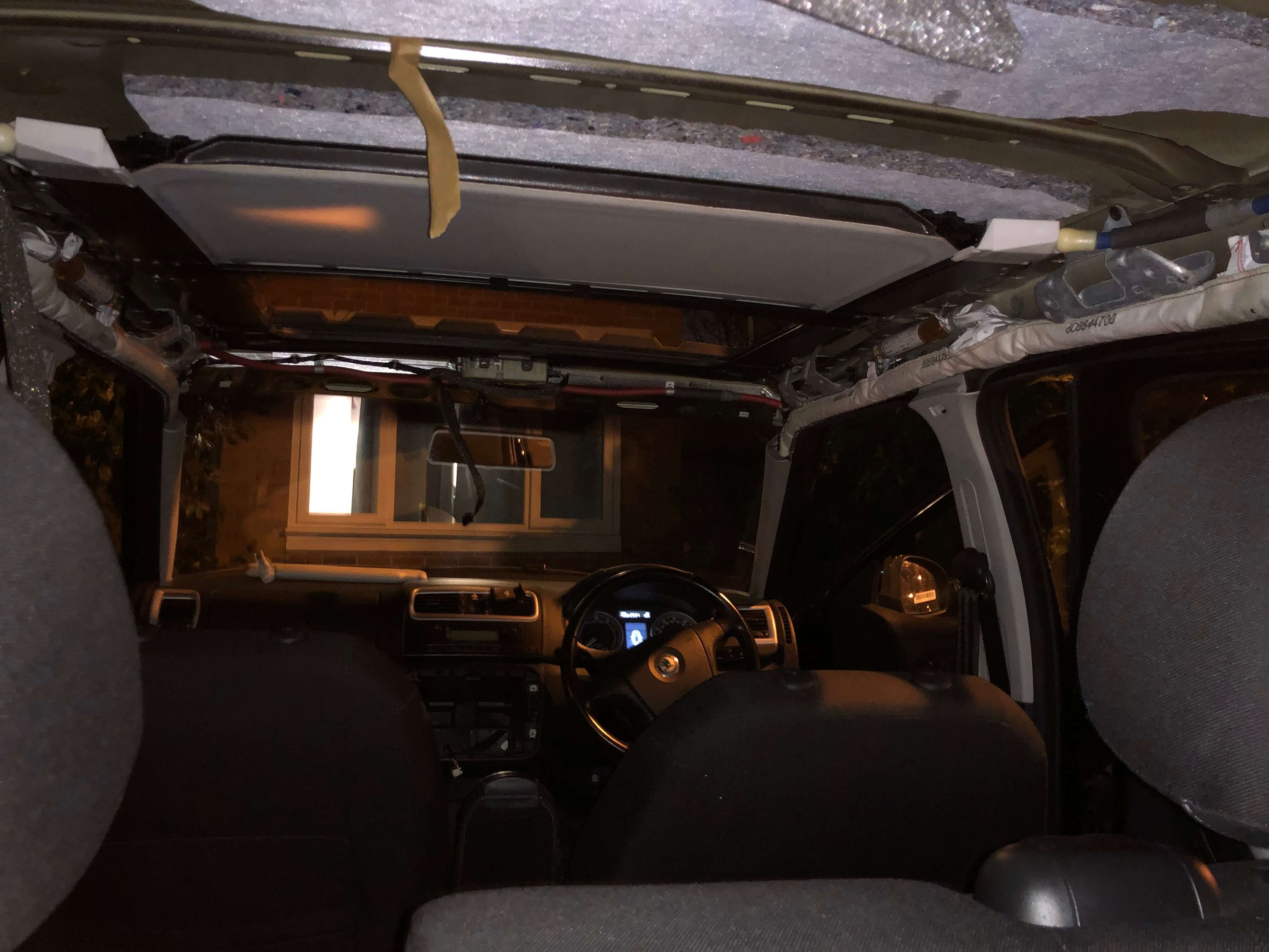

I ended up taking out the headliner. I took my time as you said and fortunately, I haven't destroyed anything, apart from chipping the airbag clips a bit.
Here's a video with the leak.

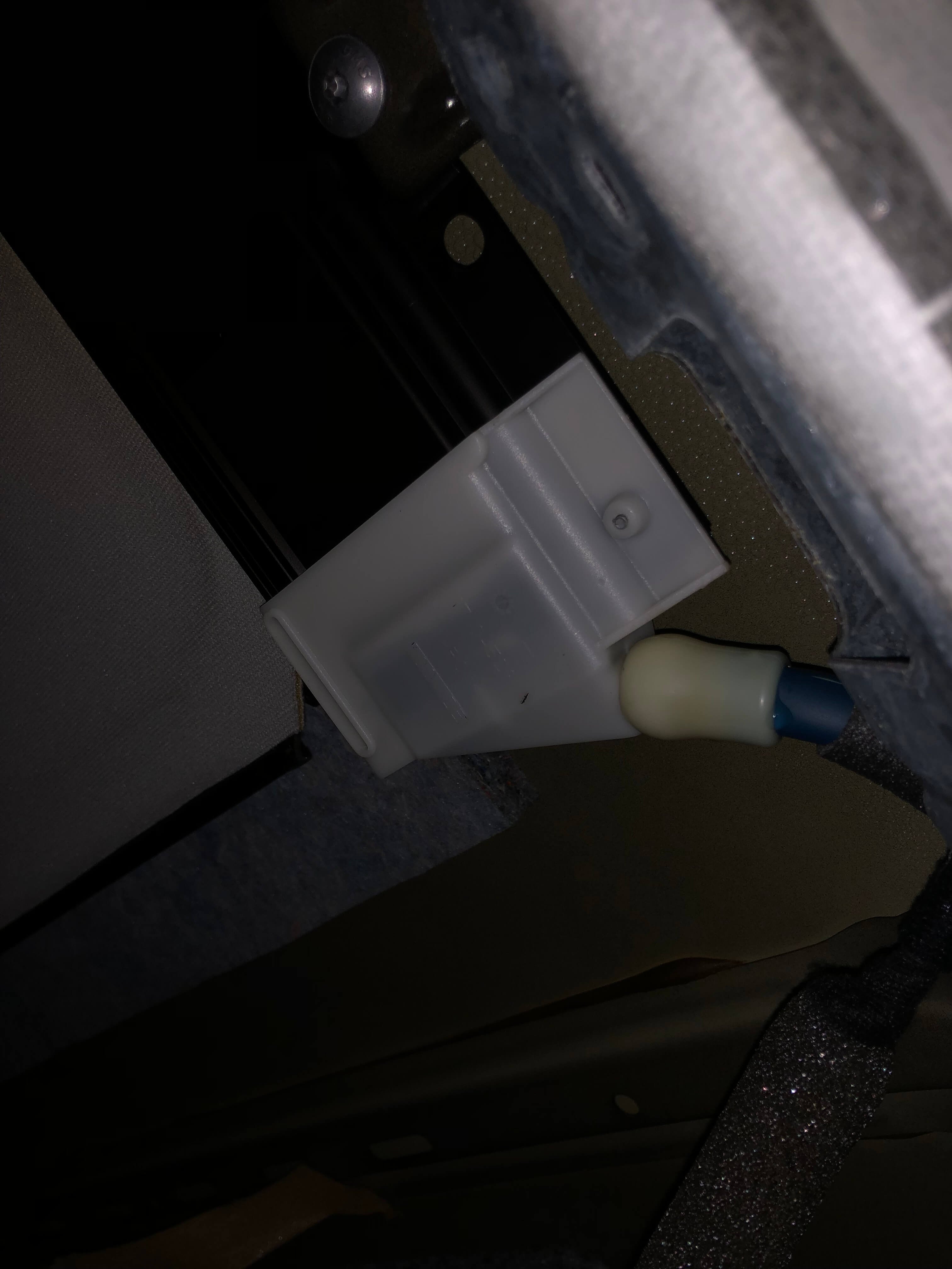

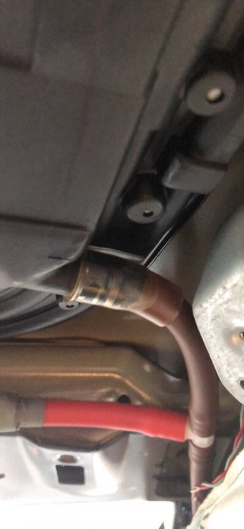

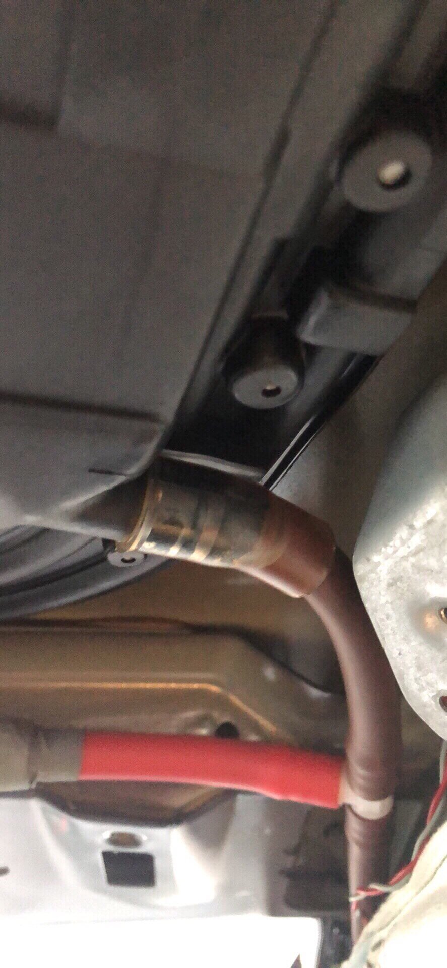

I've added some pictures as well. Blue tubes are the rear ones.
@spartacus68 Yes, that's the roof. I think you were right; the drainage tubes' connection with the sunroof cassette is poor -- on both left and right rear drainage tubes; the leak comes from there. I presume this is due to a bad design.
The connection for the rear drainage are made of plastic as you can see in the pictures (brown tube), whereas the front ones are with a silicone rubber. The front ones seems like a much better choice.
How do you reckon I should fix this?
Should I add some silicon sealant OR buy & fit similar connections as the front tubes have? OR do you have an even better idea?
Wanted to add that some of the water does go through the tube, thus the tube isn’t blocked.
Blimey, that's a trip and a half! Amazing just how much water damage can happen if the car was left for a prolonged period, say airport car park while you enjoy a fortnight in the sun.
I'd use a specialist marine sealant, such as Sikaflex 291. Do it on a dry day, pull front drain tubes off, dry, then add a light bead of Sikaflex on the plastic cassette drain, then reapply the drain tubes. I'd add a light bead of Sikaflex around the drain tube edge to completely seal. You can smooth off with white spirit. Wear nitrile gloves.
