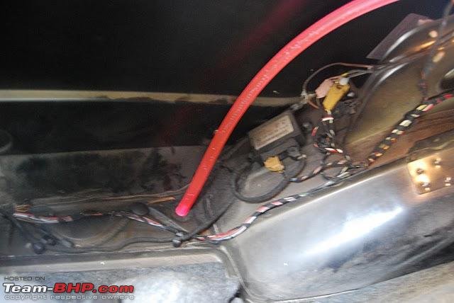

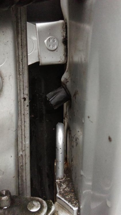

If you look on the pillar between the hinges you'll see a rubber tube sticking out. That's the drain for the sunroof, you need to squeeze the pipe and what's stuck in there will eventually come out. I've added 2 pictures of the locations of the drains front and rear.
Brilliant that's exactly what I did. There was soft mud squishing out of the rubberpipe ends I pushed a curtain track down the sunroof holes then poured water in and it eventually came out washing the rest of the debris out. I think that's sorted it I'll just wait for next downpour but there was water all the time on the well and I used a spongy to soak up.  There's hardly any now I put electric fan heater in for while and fairly dry cheers
