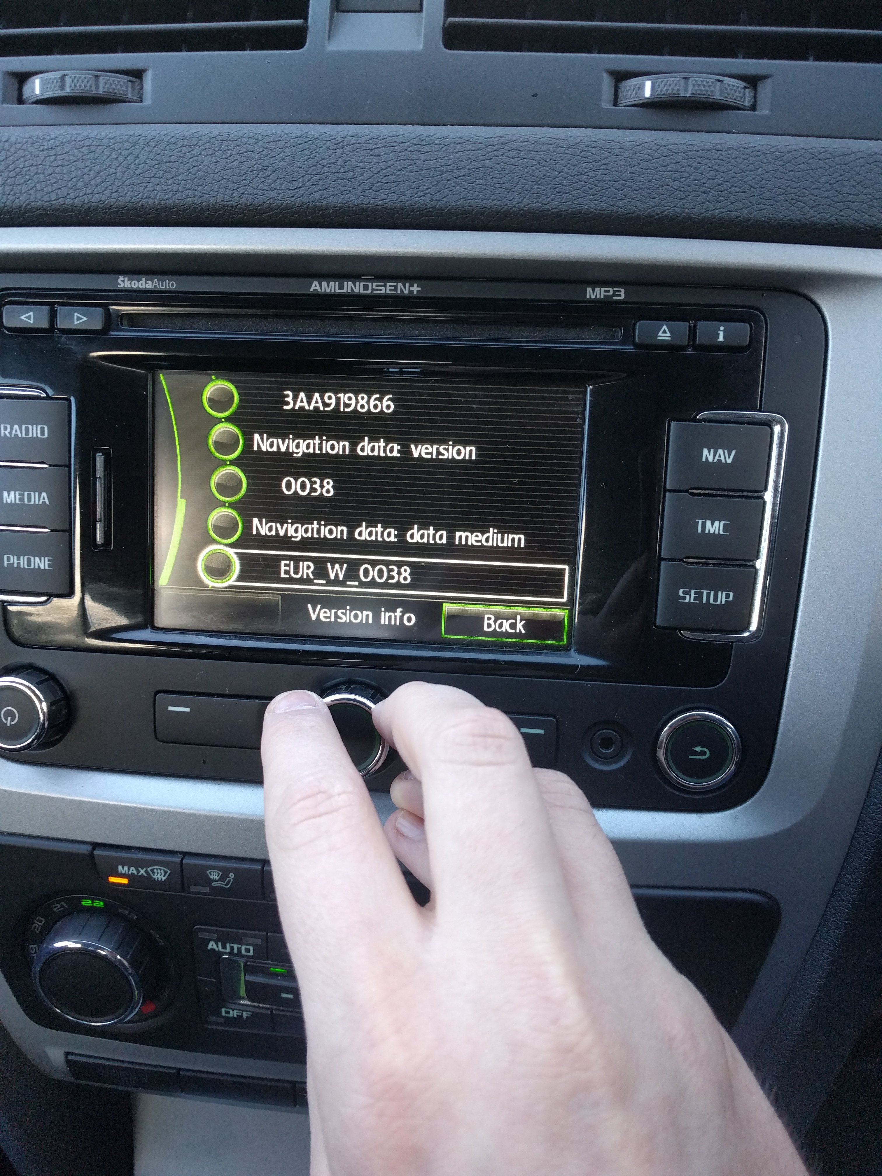

Does anyone know how to check what the current version is installed? Mine just says 038 or something under map nav info...
(Apologies for slight necro..! :blush:)
0038 is V3, so quite outdated.
Ah! Thank you! :)
Ordered V9 just now so hopefully should have me up to date enough!
