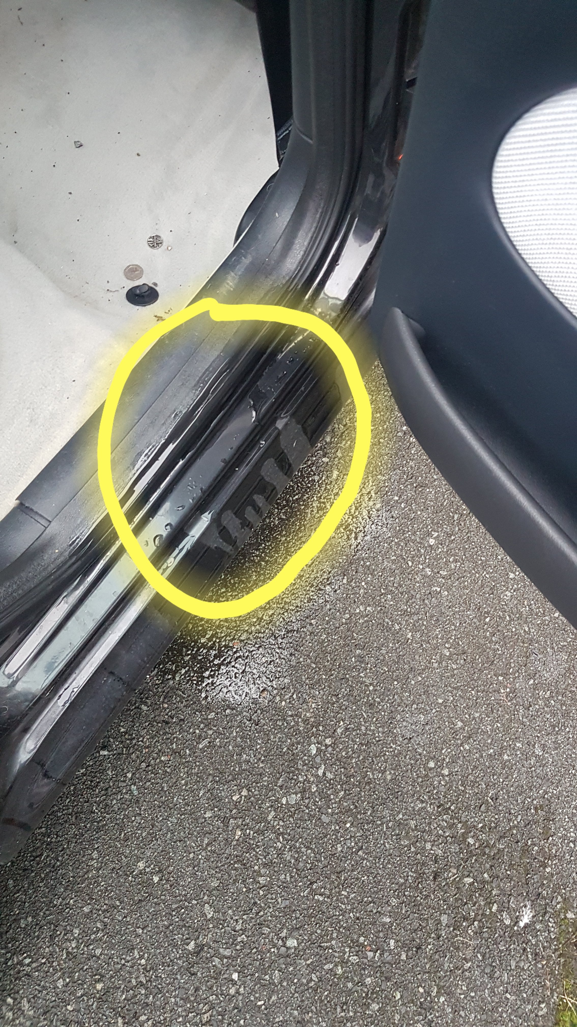

hi all,
yes I know this topic has been covered numerous times but I still wanted to ask on here.  there isn't a puddle but it is definitely wet. where should I start from?
  • There is no water at the front so cant be pollen filter
  •  more water seems to be  getting in if the car driver side is on the curb whilst parked?
  • please see the picture attached, the water seems to be sitting on the door sill
  • where do I start from? garages don't like doing this job as its really time consuming for them and even if they did do it, it would cost too much. I am based in Manchester if any one is willing to assist?  at a reasonable cost may be
what could it be guys? any help is appreciated

I'd suggest starting where this fellow Briskodian did, here:
@hussair5
I'd pop the door card off and check that the plastic membrane  is intact and sealed fully to the metal of the door frame...
It may only be a sheet of plastic but my god its important!
If any works been done inside the door, the membrane has to be opened to get at it... even changing speakers..

 thanks for the reply
door card easy to take off?  any instructions or "how to" please ?
Thanks
Thanks
Sticky thread about changing door lock micro switch has a nice door stripping guide.
