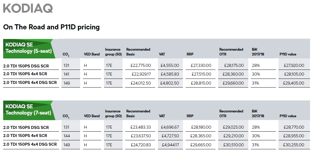

From January 2018...

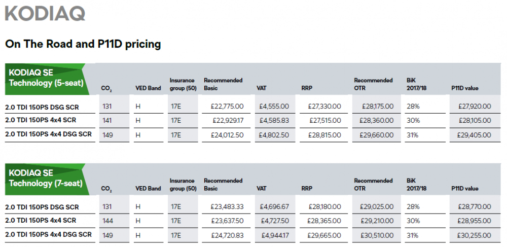

Wow. Didn’t realise it was that much...
Only being available as a diesel (thanks to being aimed at company car drivers and so low BIK) doesn’t help - a petrol SEL would actually be a lot better value thanks to retail promos etc.

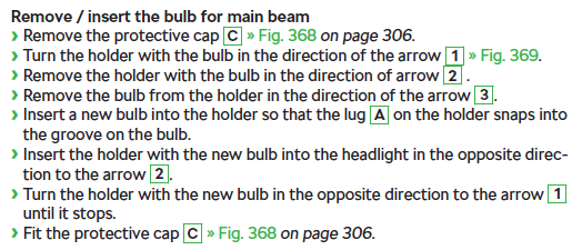

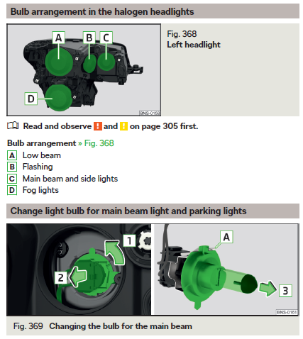

Presumably you have the entry level halogen (non-LED) headlights?
From the owner's manual...

OK, thanks - bad choice of words.  For the avoidance of doubt, I was referring to the dipped low beam bulbs which are a pain to change. The high beam ones are however very easy to access.

Sorry for the concussion, I was referring to the low beam (dipped) bulbs that are very difficult to reach. I'm thinking for Led bulbs with new chip technology that give better concentration of the light.
If you replaced with same length halogen bulbs then you was ok as you just turned the holder left and put it out. Hope will last long.
But led bulbs are bigger in length and have different base so another issue is if I will need to unscrew the base you see in front of the holder. This cannot be done for sure...you can't even put a screwdriver over there.
