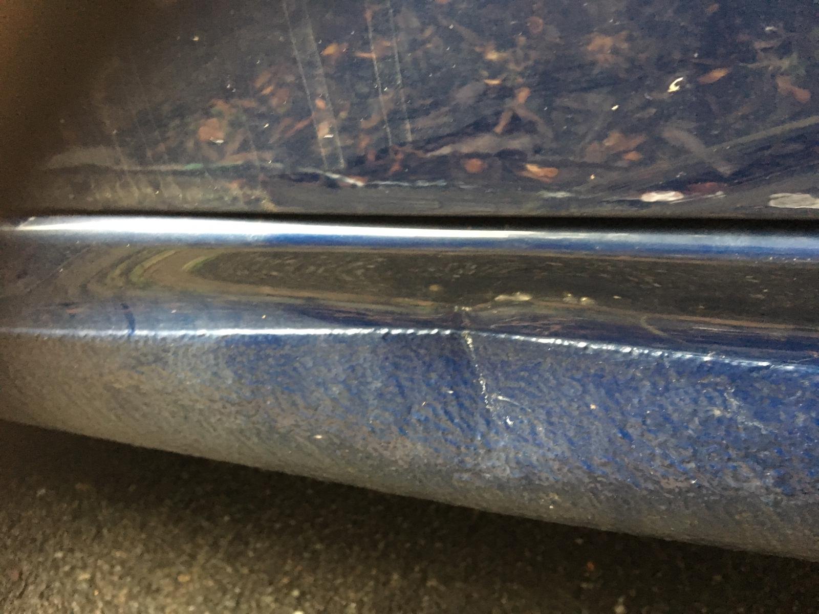

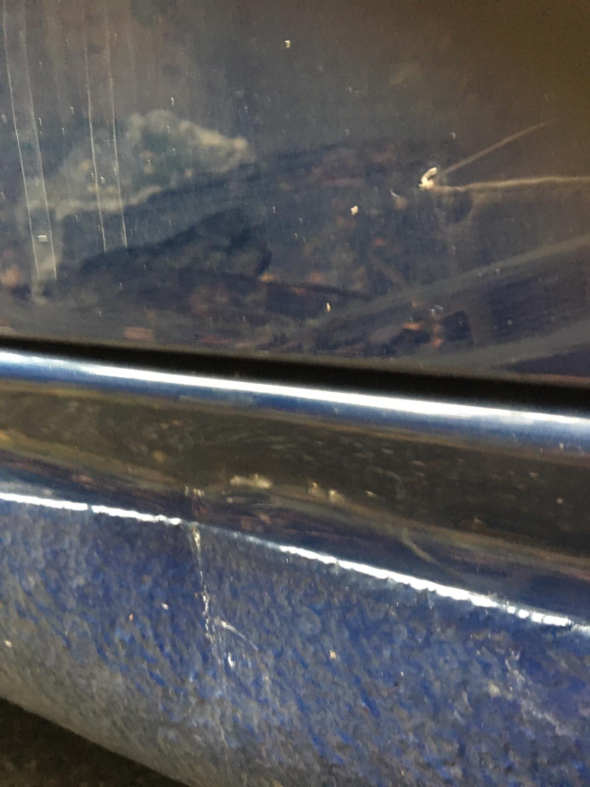

Hi,
I got dent (a big on in the outer sil). I was reversing and could not see a low brick wall. (Kicking myself).
Anyone know best way to fix this? (Photos attached.) Its about an inch I believe.
Its 2014 TDI Octavia UK
Any help is much appreciated.
Thanks
Oops!  Top face of sill is clearly distorted upwards.  I think the normal procedure is to drill into the sides and use a puller of some sort whilst  simultaneously applying hammer taps on the top face. Then use filler to fair it back to original appearance.  I managed to put a longitudinal gouge in one of mine and a local independent body-shop did the repair it and re-spray for around  £150.

Thanks, Can I not open cover from underneath the car and hammer from inside?
Also I take this shouldn't effect an MOT? There are no sharp edges exposed.

The sill is a structural part, not a sheet metal part so a suction puller won’t work.

Does it looks like MOT failure issue (from looking at the pics) ?

Also a suction cup would need a smooth surface. No hope of creating a good seal against that mottled texture.
