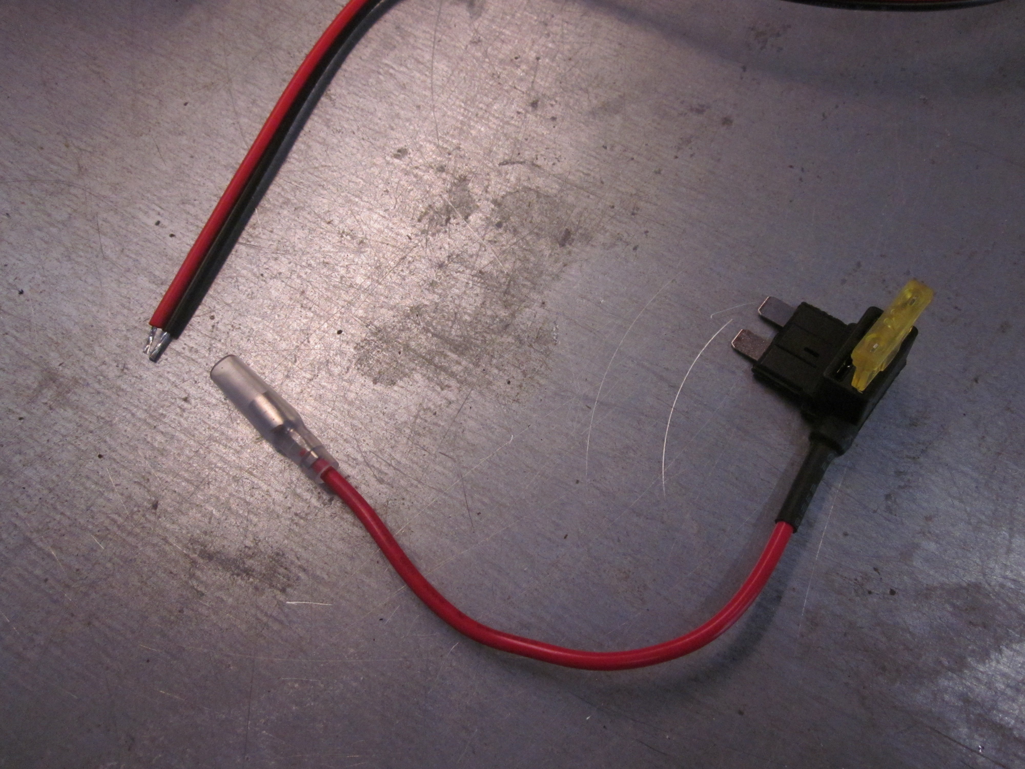

You need a piggyback fuse holder...
The original fuse would mount to the piggyback fuse holder next to the yellow one in my picture, and the black part would slot into the now vacant slot in your fuse box.

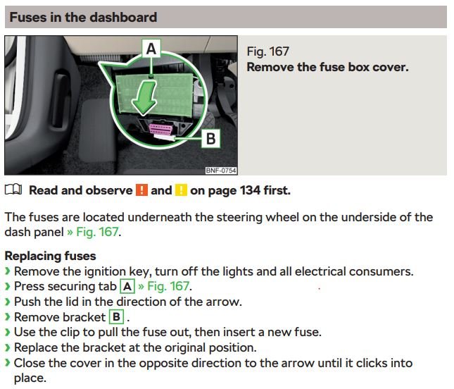

 @silver1011 The fuse box on the 2018 GitiGo  is now down by the accelerator peddle. If you remove the cover and fit a piggy back fuse the fuse box lid will not go back on as the Piggy back fuse sticks out too much

Thanks guys. There’s not enough room for piggyback fuses.
