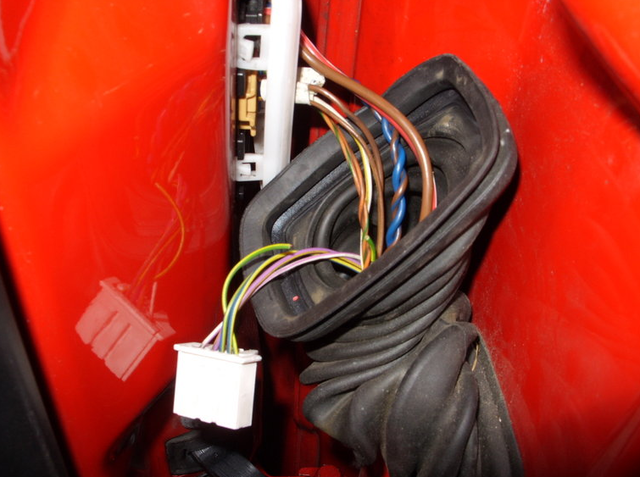

Have you checked the wires inside the rubber door bellows? They can break and make intermittent or no connection at all.
I had a yellow and green one snap which affected the central locking.

The switches do fail but in my experience it's usually just on one side (of the driver's switch). Check carefully for broken wires in the door bellows, they can even be broken inside the insulation. Also remove the plugs and check for corrosion and apply some contact cleaner. Don't go the expensive route before ruling out this stuff.

I had the look out of the door holes and checked but no visible broken wires. I attempted to test the wires with a multimeter today also, but couldn’t for the life of me work out how to work the thing! The main power wires seemed ok.

Unplugging and plugging the black connector at the top inside the door gaiter
