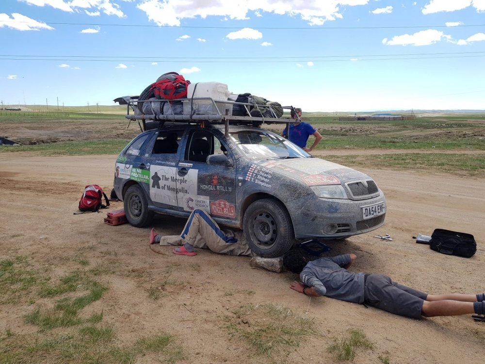

I have recently received my car back from Estonia where it has been sitting for the last few months. I completed the Mongol Rally for the second time this summer, both times in my Skoda.
During our adventures in Mongolia we developed a bit of a rattle in the engine bay which has continued to rattle of the remaining 1500 miles of the trip.
I've been going through and trying to fix bits of the car up to make it usable on the road again, such as filling the holes from where a roof rack was welded and most importantly installed a new rear speaker.
We had hoped this low droning noise had something to do with the exhaust as it fails to really build any pressure unless revving pretty hard. I did find a leak just before the flex pipe, I've temporarily patched this with a few layers of duct tape. Having got under the car and removed the sump guard it appears the main drone is coming from the gearbox, I think belt may also be squealing.
I have recorded the noise and I am hoping one of you has some experience with what may be the issue and how you resolved it.
I've attached a few photos for you to see what I've put this car through!
