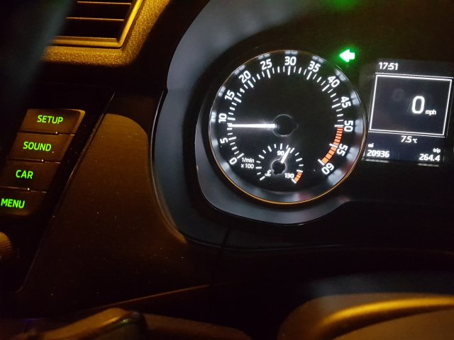

I guess I'm not the first to suffer with the mk3 Fabia diesel getting a bit too warm, it seemed to start about three weeks after it come back from hayseldens after they replaced a split hydraulic clutch pipe. The temp gauge climbed slowly & seemed to hover around 110 & then dropped back to 90 after about ten minutes & it was fine for about a couple of weeks, then it started to do it again but only when I opened it up on dual carriageways or fast roads & the temp gauge was fluctuating between 105 - 110 & the oil temp climbed to 110 as well, checked under the bonnet & couldn't see any coolant leaks etc. Then it seemed to start doing it more at low speeds, the coolant temp would climb & the drop back to 90.
Then I decided to give it a motorway run to see if it was the dpf that was trying to regen so went down the M1 keeping a constant 70mph & sure enough the coolant temp went up & sat at 110, then when I checked the oil temp it was showing 122 so I pulled off the motorway & carried on using slow roads, the car sat about two hours & decided to see if I could replicate the fault on my way home so come back up the motorway but the coolant temp sat at 90 & never went over & the oil temp peaked at 102 & never went any higher, but since that trip the coolant temp seems to rise intermittently so I'm not sure if the thermostats at fault or the pump, or is it a faulty sensor somewhere, I should mention that when it was running hot the fan was running at full speed.
So the car is currently sat in another skoda dealership over the new year waiting for the fault to be diagnosed, at least Ive got a new Citigo monte carlo to drive around in.
So is it suffering the infamous water pump issue or is it something else, I should add that it was recalled for the coolant change & the engine was also flushed apparently.
TIA
