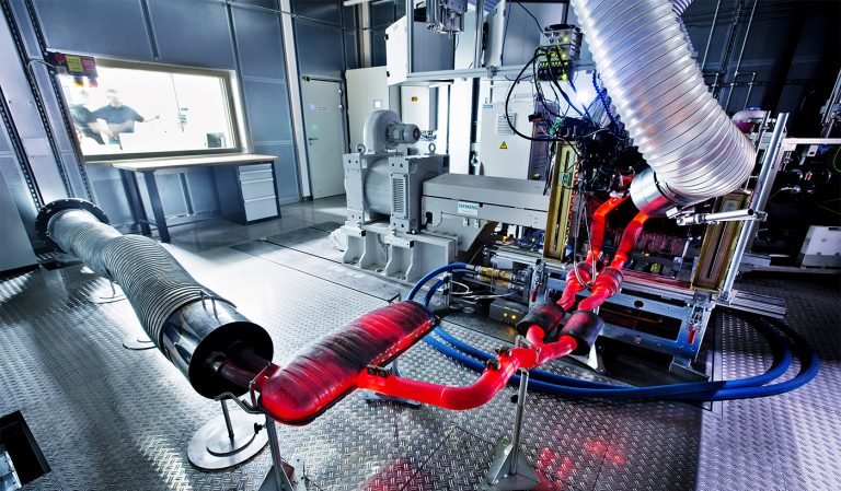

You mean solenoid controlled vacuum operated ones, much weaker forces than electric actuators.
The difference is you are probably thinking about old diesel engine turbos. Much lower operating temperatures than petrol.
Incredible what they can put up with really, including the oil and seals

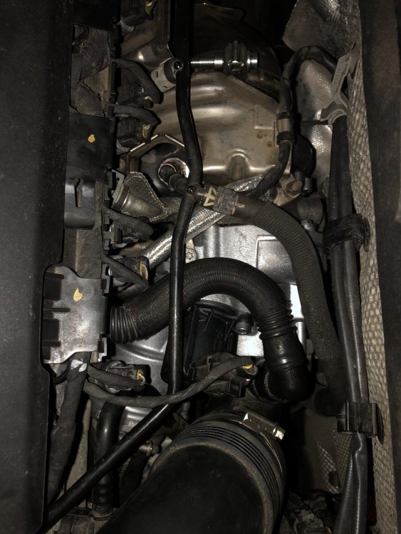

Picked the car up tonight. New turbo fitted. Asked what was wrong with the old one and it was something like this. Faults were actuator rod (waste gate) in incorrect position, remedy, "replace turbo unit" new shiny one fitted!
