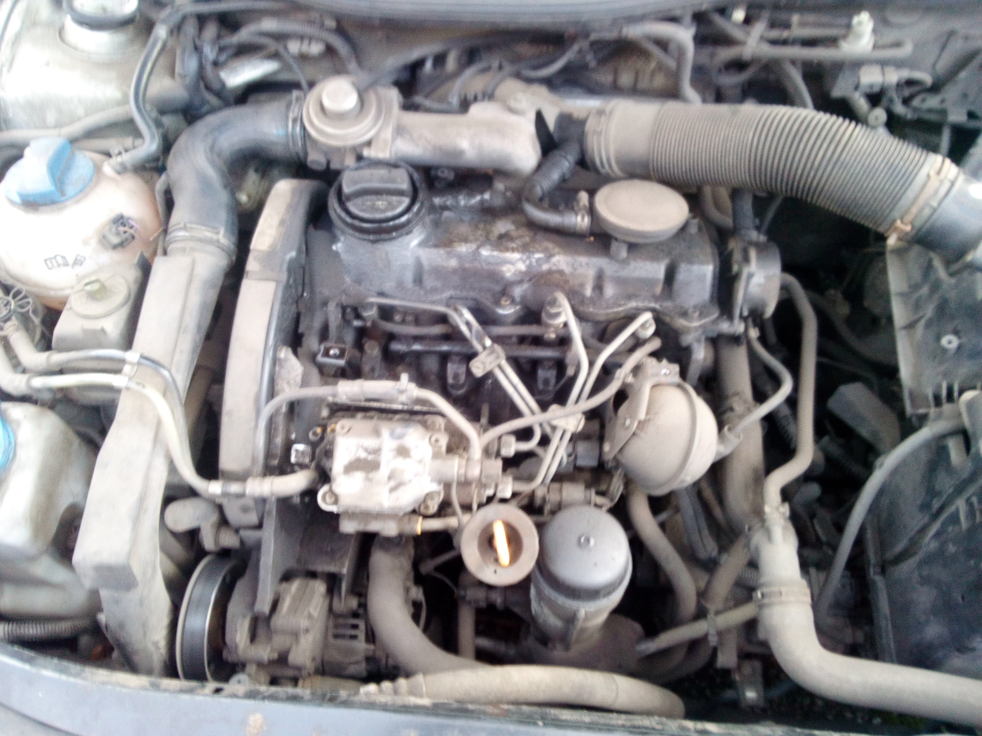

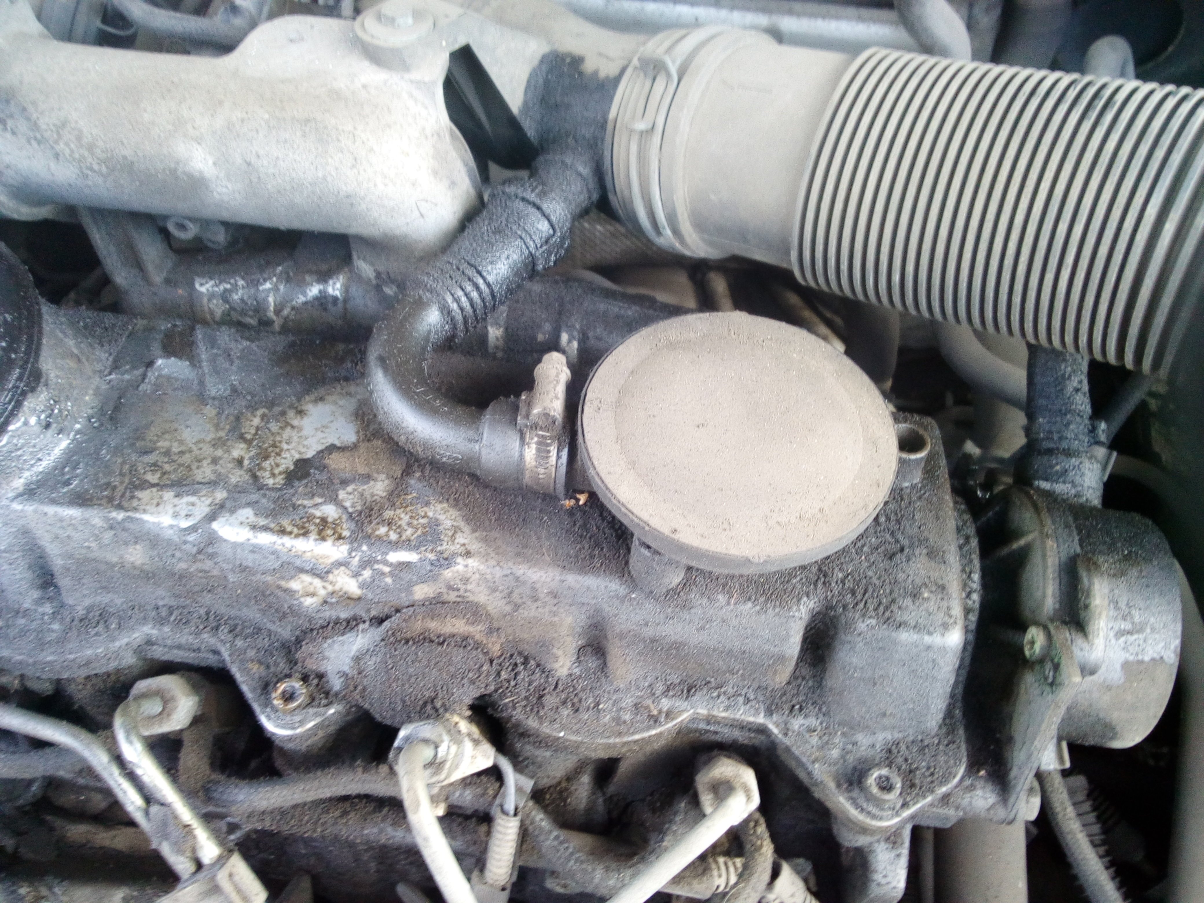

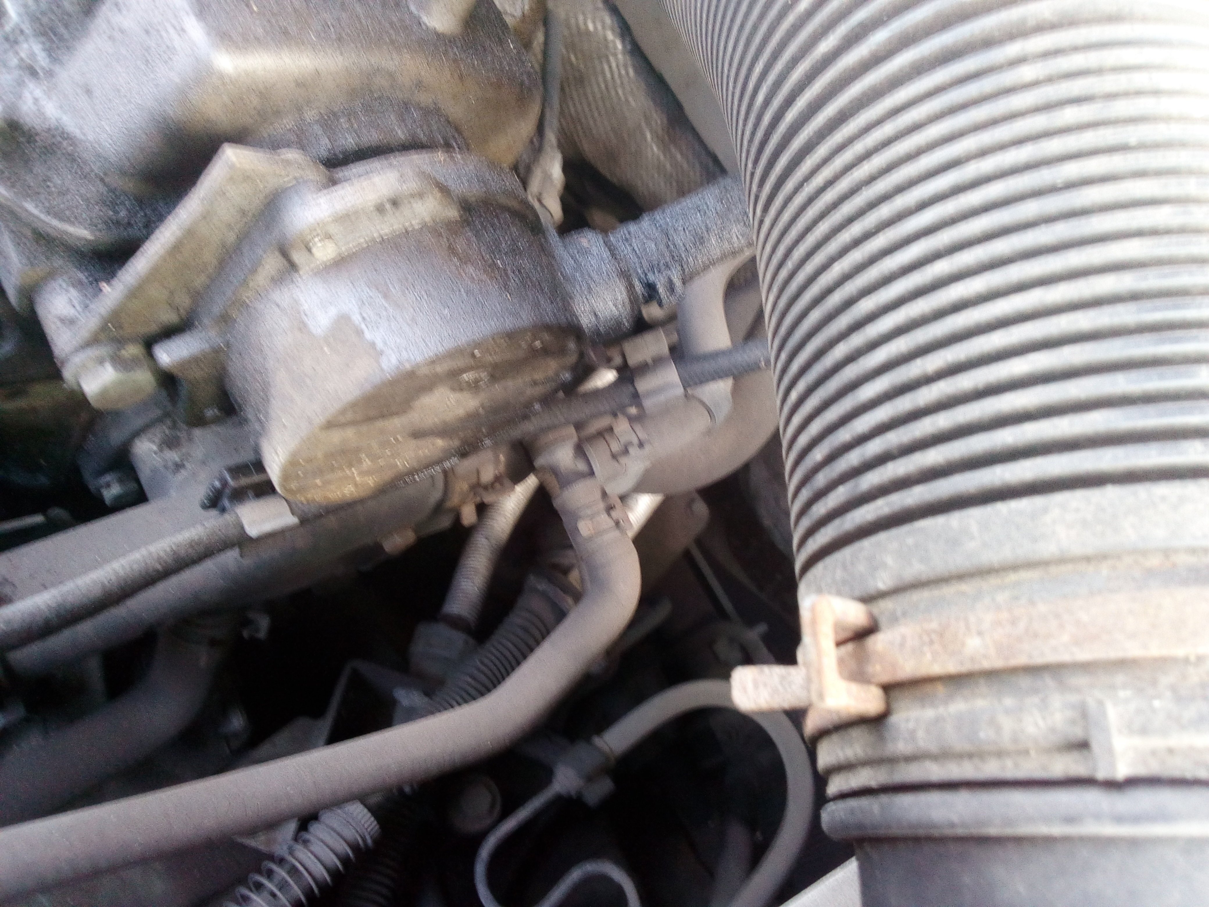

A couple of photos. I'm guessing the oily pipe connected to the air intake hose is for burning crankcase emissions and would likely be unrelated, but the round thing on the right hand side of the block (also oily) has to be a vacuum pump since it's connected to the brake servo. I presume that boost is regulated by vacuum too, so maybe worth checking the vacuum pump. A couple of days before Xmas I did have an intermittent hard pedal. Is that related perhaps?
I expect the way to check for a non obvious leak would be to pressure test, which of course I can't do. To be honest I generally leave engines alone other than servicing though I'm quite happy working on the running gear. It does seem to be a lot more complicated than the last diesel I worked on. Only really having a look as the time of year means I can't really get it in to a garage yet.

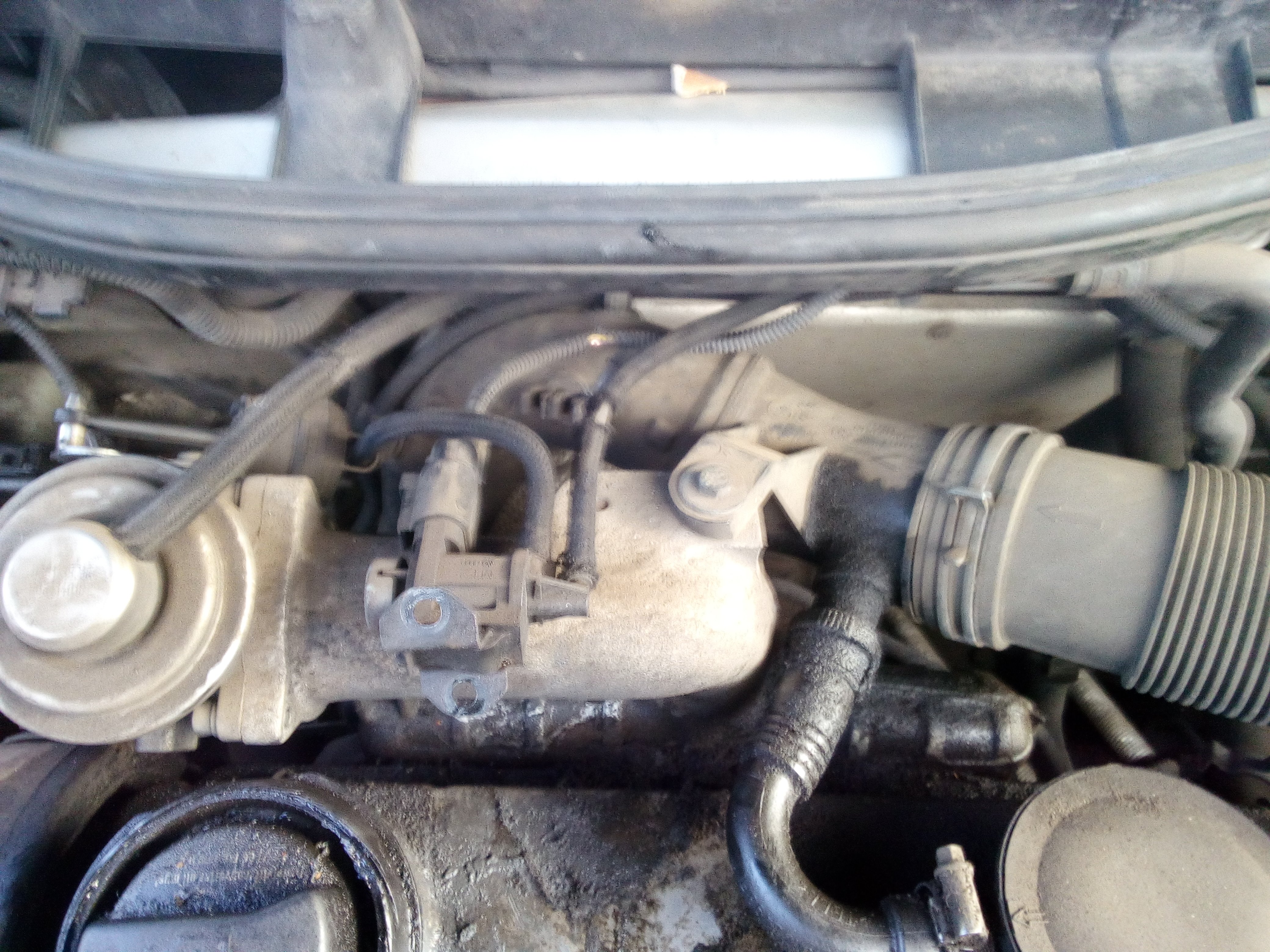

See the blackish rectangular section that runs through between the coolant header and the cam belt cover? I'm thinking you may have popped a joint in that pipe or the one below it (Turbo cold side to intercooler in RHF wheel arch and back to manifold).

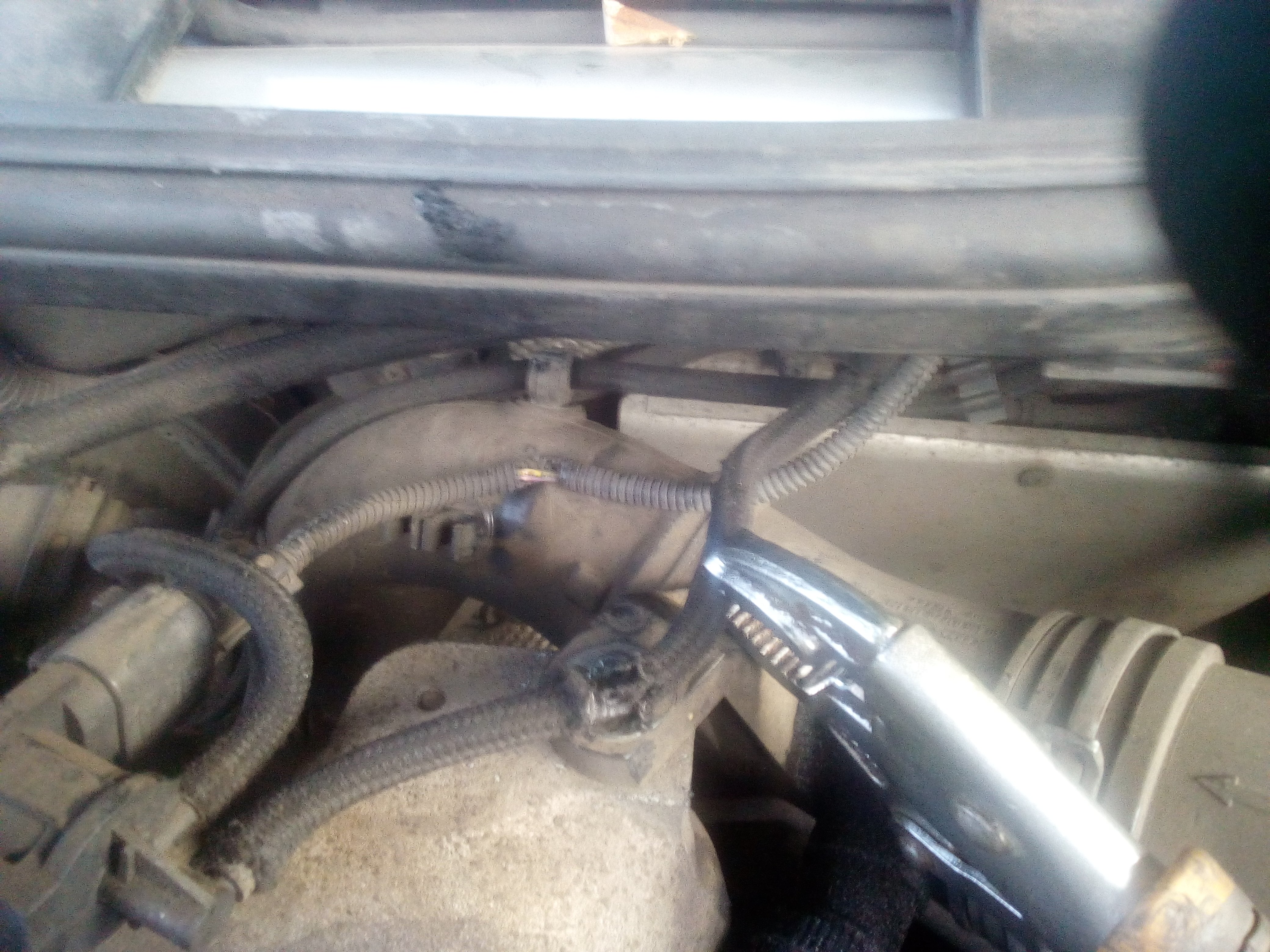

Can't see anything obviously adrift there, did notice this, don't know if this is of relevance. Photos aren't great but you make out that one of the pipes is damaged, and the electrical connection is almost worn through also. I've removed it just to get a better picture of what it is, but since it;s directly connected  to the valve/gate on the intake (is that the throttle body?) I guess it could be. If that could be a cause, is there a way to test?
I'm not sure that's your fault, but it needs replacing anyway.
No it wasn't. It was still intact though very weak so I've bodged it for now with some chemical metal.

@Wobsta That won't help at all; the fabric hving worn through like that, that pipe will be collapsing internally, so all you've done is waste chemical metal.
Yeah I know, but there's not much else I can do today. I figure it's better than nothing. stuff sticks like the proverbial brown stuff and sets nice and hard so it can only improve things I think and I have a massive tin of chem metal . If nothing else the vacuum hose will actually stay in the hose clip now since it's thick enough. It's not a permanent fix.
I think it;s just the vacuum to the anti shudder valve in any case.

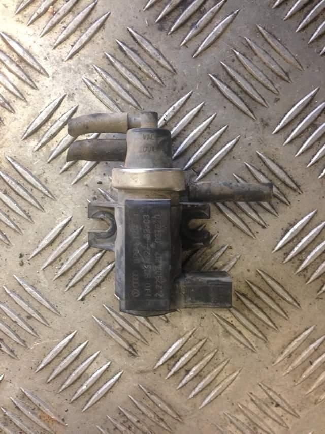

So, whipped the solenoid off to investigate. I applied 12v to the terminals, and not a thing. Should at least fee a click or hear something, I thought, but no.
The N18 I have looks like this (not mine, didn't take photos but looks the same)
So, to investigate further, I took a junior hacksaw to the metal band at the tap and released it. The top part then separates from the bottom part. The top part didn't appear to be blocked at all. The bottom half has a plunger the full depth of the bottom half with a red diaphragm at the top where the two parts join (so roughly where that metal band sits). Knowing how a solenoid works, the plunger obviously should move freely. Well, it didn't. So I removed the rubber diaphragm to avoid damaging it, and using some mole grips I removed the plunger. It was very tight, and gunked in there.
I cleaned the plunger with some sandpaper and the internal bore on the body with sandpaper wrapped around a screwdriver. Then flushed it with some brake cleaner, dried it, applied some light machine oil, reassembled, put the metal ring back and secured it with a zip tie. Tested it on the bench, got a click.
Put it back in the car, connected the vacuum gauge to the EGR pipe, and repeated the gun to 3k from idle, and lo and behold we now have over 15inches at idle and zero with some hefty throttle. So some significant differences in comparison to the previous state of affairs. I cleared the error code, and so far so good. Previously the error would com back within a mile or two, but so far no repeat. If truth be told I'd had an EML light for some time but put it down to the MAF sensor. Clearly I got that wrong. But for the first time in a while I have no EML showing.
My guess is that the initial state of affairs I described was caused by the solenoid sticking in the open "idle" position, so that all the boost was dumped out through the open EGR. All seems to be OK for now. I guess it will need changing at some point in the future, but who knows, but might run for 2-3 years yet by which time the car will likely be deceased.
