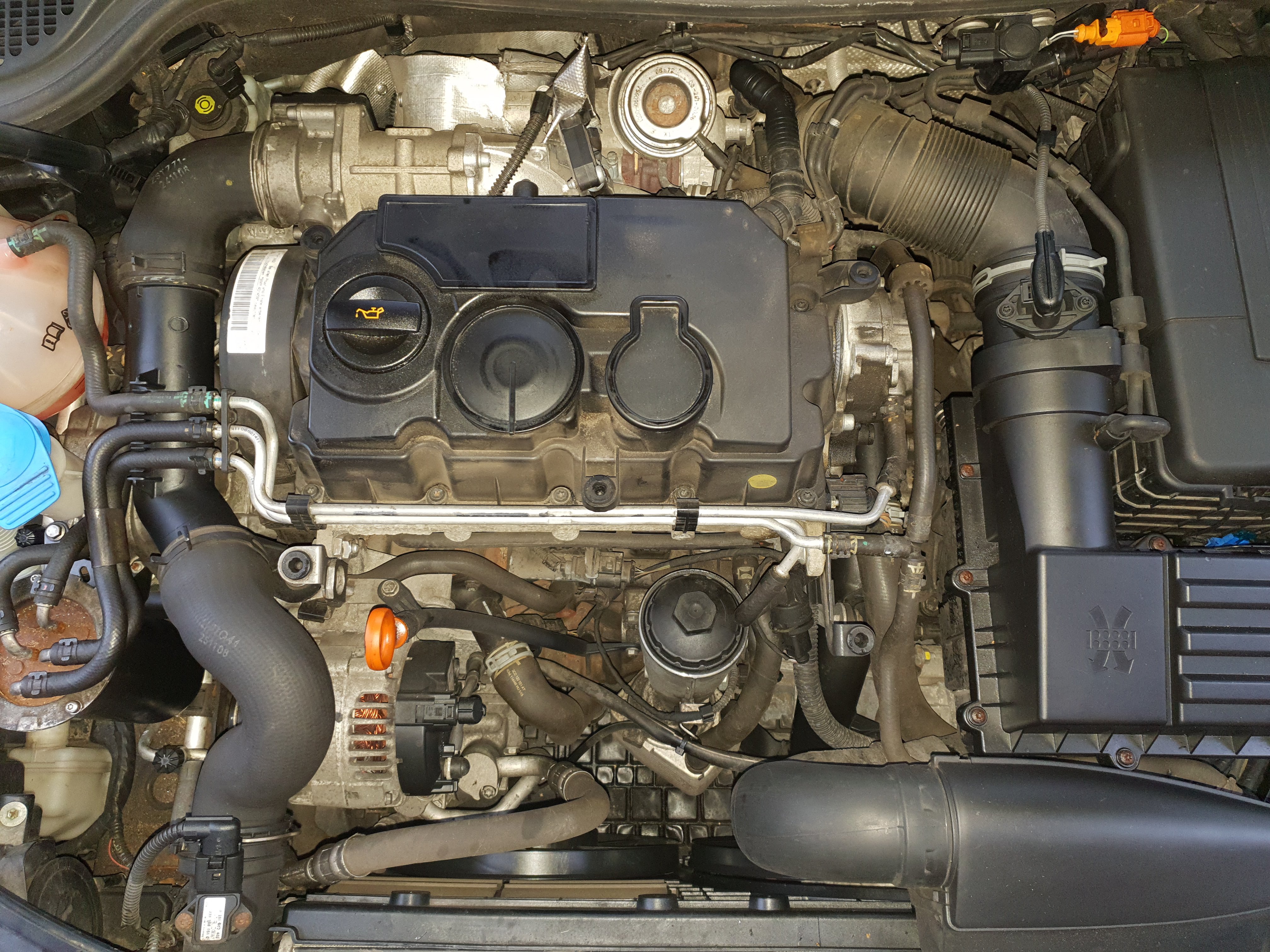

And having removed the engine covers, it seems the EGR isnt at the front of the engine after all, and I cant for the life of me figure out where it is. Ive trawled the net for "2.0 TDI PD EGR" and "Skoda BMP engine EGR valve" but none of the pics or videos Ive found look like my engine. Can anyone tell me on the attached photo where my EGR valve is?
Thanks in advance
It's very probably buried at the back underneath the turbo/exhaust manifold.
