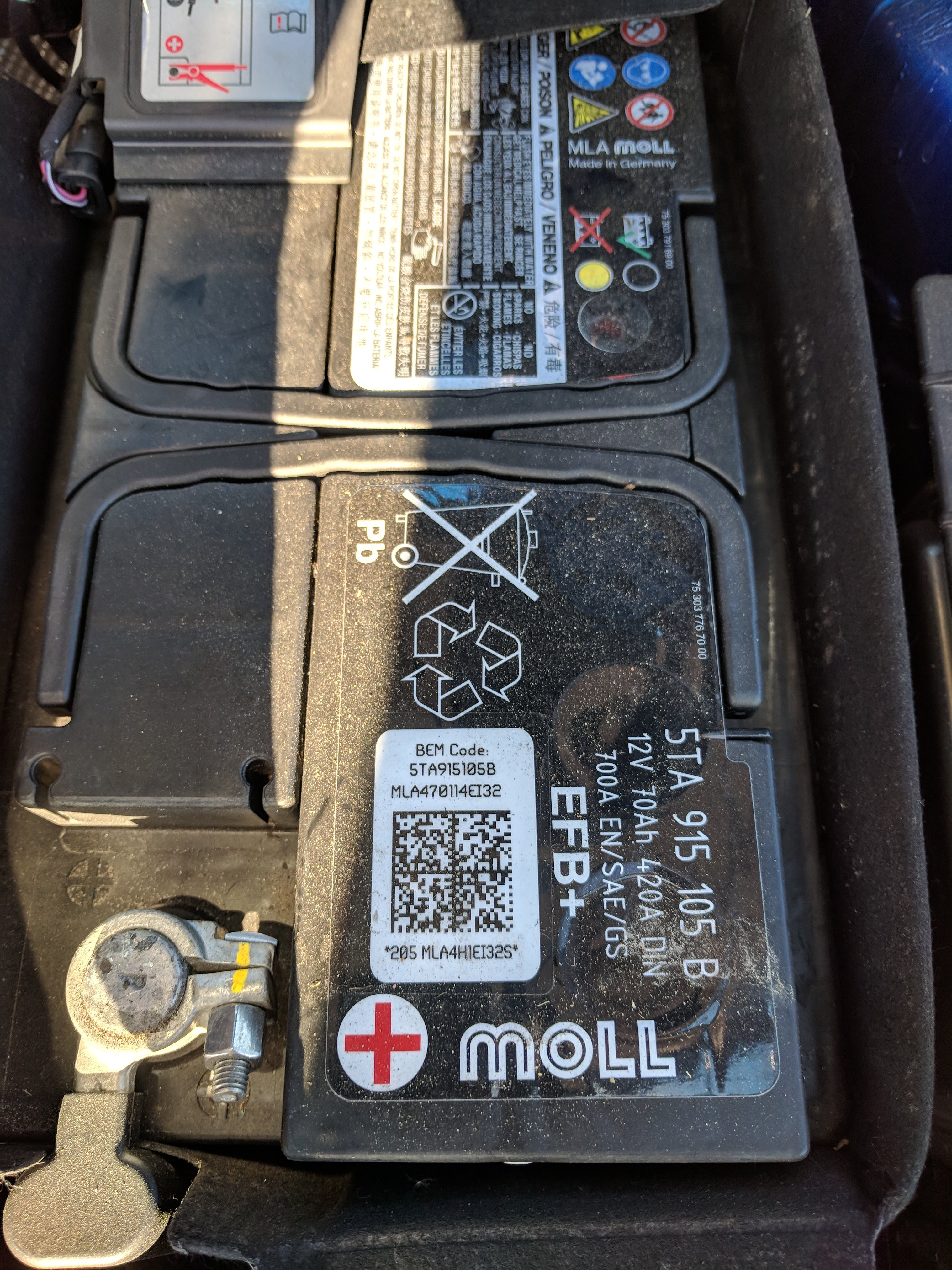

A quick battery test was done this morning, the battery confirmed to be defective and will be replaced under warranty, they still want the car for two days to test though.
Battery is a Moll, I don't know if it was part of the faulty batch.
