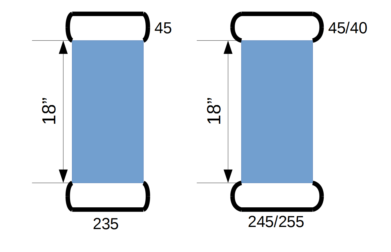

If you fitted a wider profile tyre, could you increase the extent to which the tyre 'bulges out' on either side of the rim. So, for example, stock is 235/45/18, say I went for a 245/45/18 or even a 255/40/18. Would I achieve something like below? FYI, both these options would keep the overall circumference within 1.5% of stock.  The aim is basically, to increase the recessing of the rim within the tyre to give more protection from kerbs etc:

Tyre manufacturers have been playing with that as kind of rim protection. I've found many Dunlop tyres with profile 45 and less have rim protection: "With rim protectors built into the tyre, you’ll enjoy greater protection against curb damage.".
Lots of Vauxhall Insignia's run 245 tyres on 18" alloys so can't see any problem as you observe the same tyre maximum speed and weight rating with a 245/45 choice. Many Octavia Vrs owners have gone for 235/35R19 tyres to replace the original size of 225/35R19 because you get more grip and more choice as more makers offer the wider size.:thumbup:

@iperry : Switching from 235/45/18 to 245/45/18 still complies with Manufacturers specs and tolerances, but 255/45/18 don't. You should then have 255/40/18. But lowering the profile doesn't really match with "avoiding kerbs", I think. ;)
Besides, the lower the profile is, the stiffer it gets. This then means... hard to 'bulge out'.
Finally I think there could be another risk with 255: The larger the tyre gets (with stiff profiles), the more the rolling path may get 'concave' (a bit exaggereted), and then the more you lose grip, I assume. :unsure:
