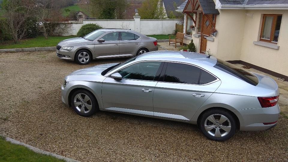

It's had three services in 15,000km so all good there. Oh, and the car is now sitting in my driveway.:biggrin:
:heart:Brilliant silver, much underrated colour.....
