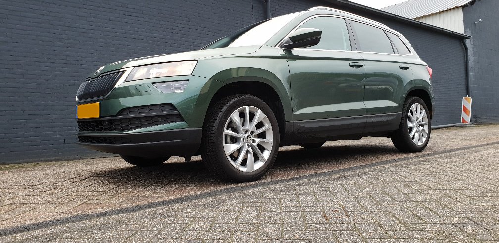

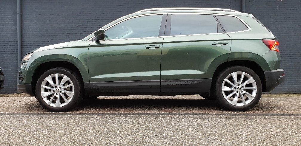

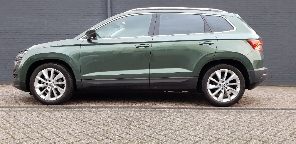

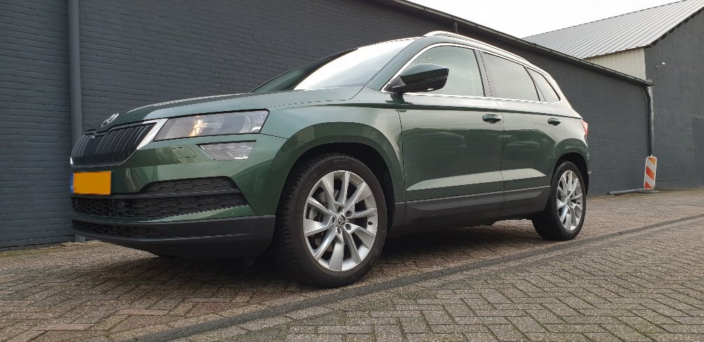

Since December 8th I drive around in a Karoq with Eibach Pro set. The car sends much more firmly and is a lot more stable.

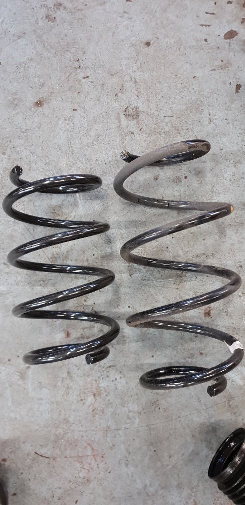

Herewith pictures from before and after the installation of the Eibach springs.
Edited by Witte Yeti

The car now sends a lot tighter and is also more stable because of the stiffer springs. The reduction by the other feathers is 3 to 4 cm.

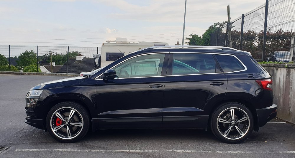

Springs are installed. As well as Koni FSD shocks and 340mm front brakes :)
