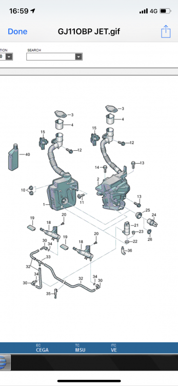

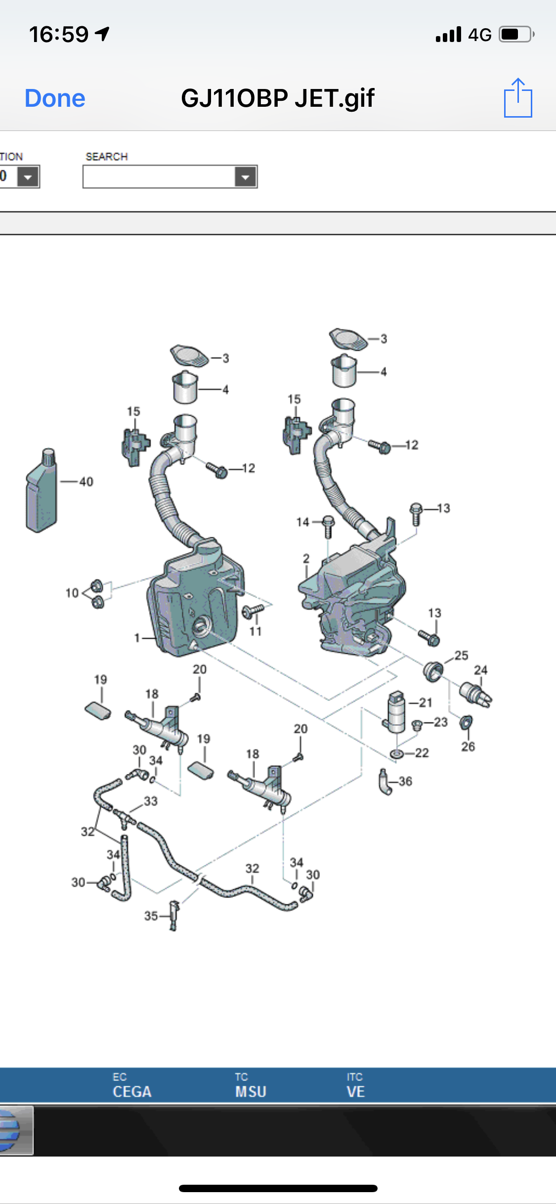

i just need to know the part number for the nossle that pops out of the bumper and any other bits that then feed onto the piping from that point.

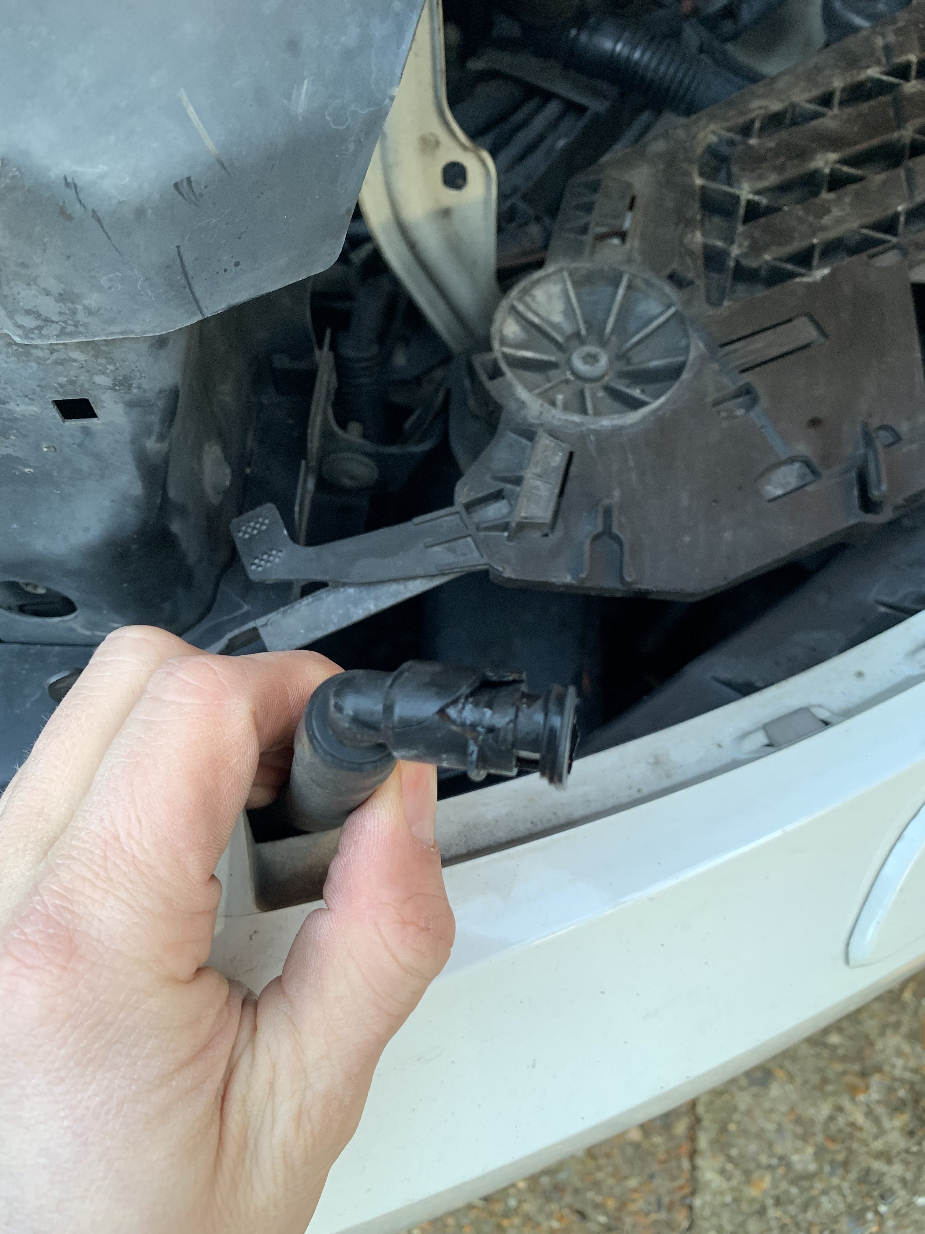

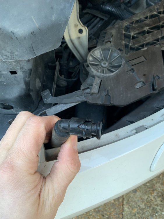

The pump is undamaged it was near side front that got damaged albeit I thought quite minor damage but clearly it’s snapped something plastic as it no longer has pressure to pop the washers up from the bumper
You should check which parts are actually broken, then you should be able to find the relevant parts in the parts manuals that have been posted. It does sound like the nozzle, but what about piping, is that intact and connected right, and the housing?
Alternatively, you could remove the broken part(s) and the part number might be written right on them.
So I can see a little elbow joint into the actual headlamp washer is sheared.
from this diagram I need parts 18 & 20 and 30 and 34
does anyone know the part numbers as Skoda won’t provide them to me. Probably knowing I want to go elsewhere and find them cheaper!
Edited by phil08
Diagram with part numbers for a 2011 Octavia here.
