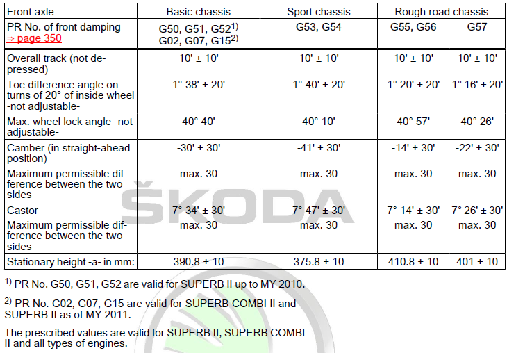

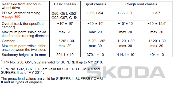

Alignment settings
front_suspension_settings.png.90c0eff1b93e17db1cfe79640eed4100.pngrear_suspension_settings.png.9c534cbf48e20d4a5d85bd23b2438dfa.png
