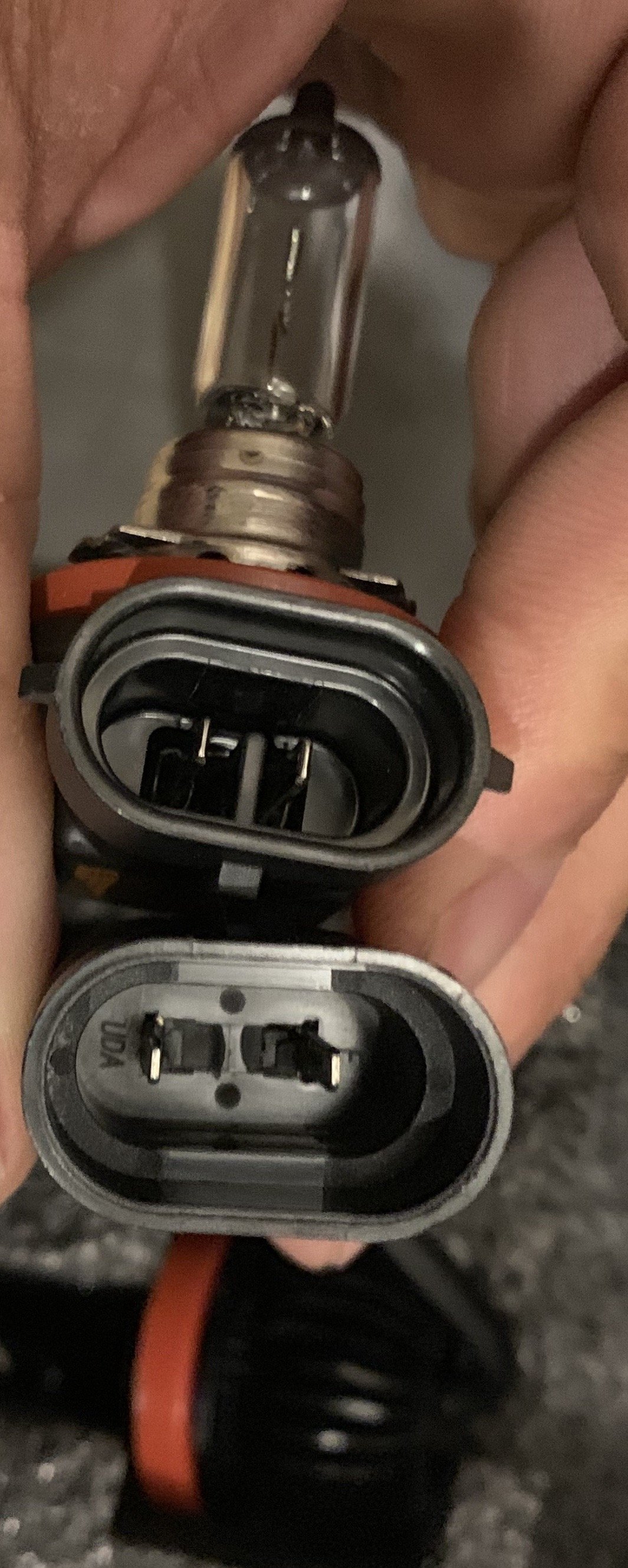

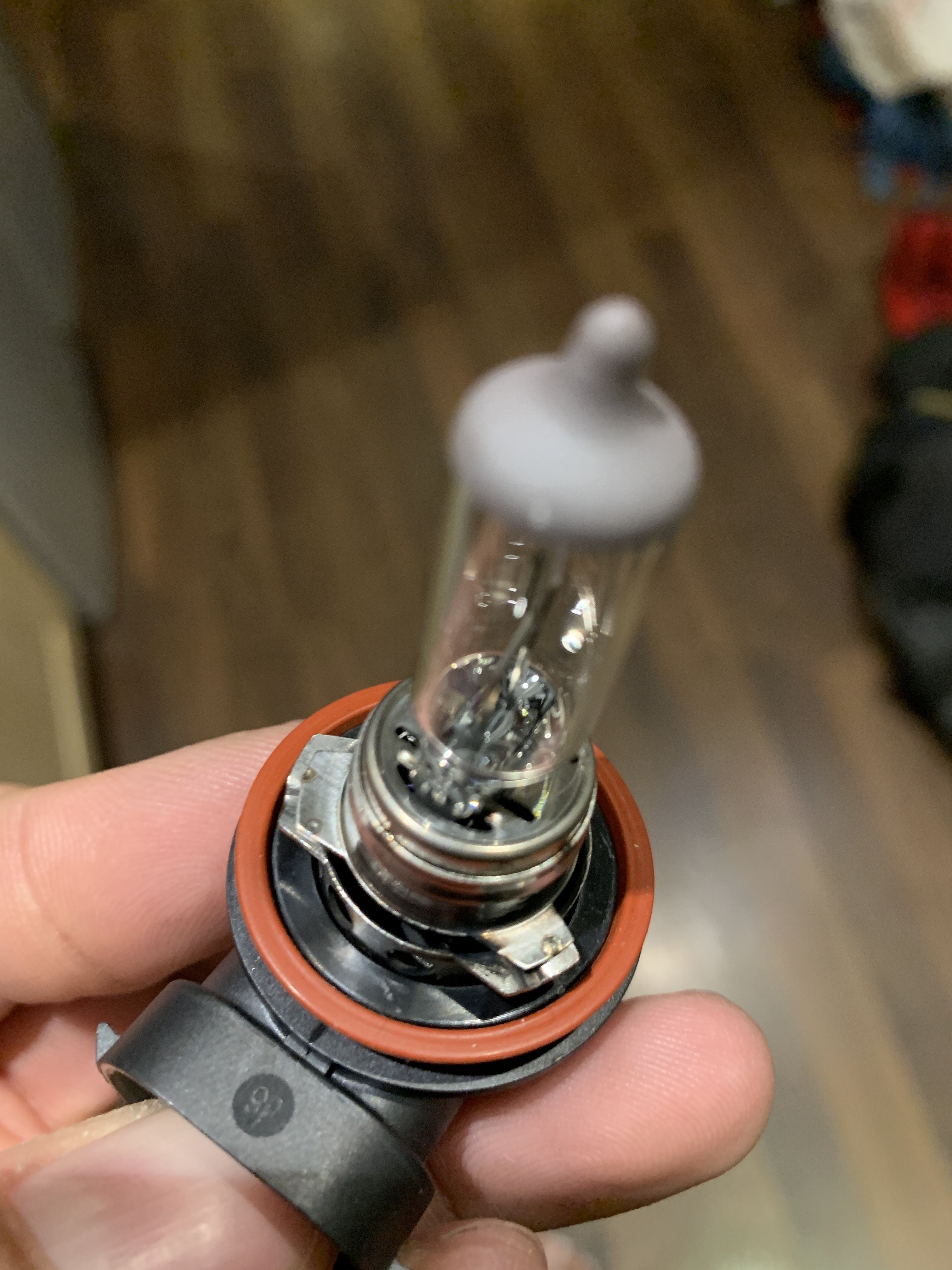

I’ve just gone to fit LED kit to my fog lamps the last halogen in the vehicle and after research found it to be H8 so ordered a H8 kit , the original bulb looks like a H11 soldered to a H8 socket but the plastic connector isn’t H8 as you can see below in pic . I quickly knocked up a temp loom but trying to find a proper adaptor any ideas ? Almost looks like 9006
top is original bulb
