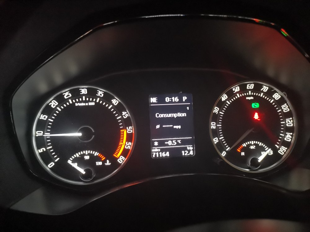

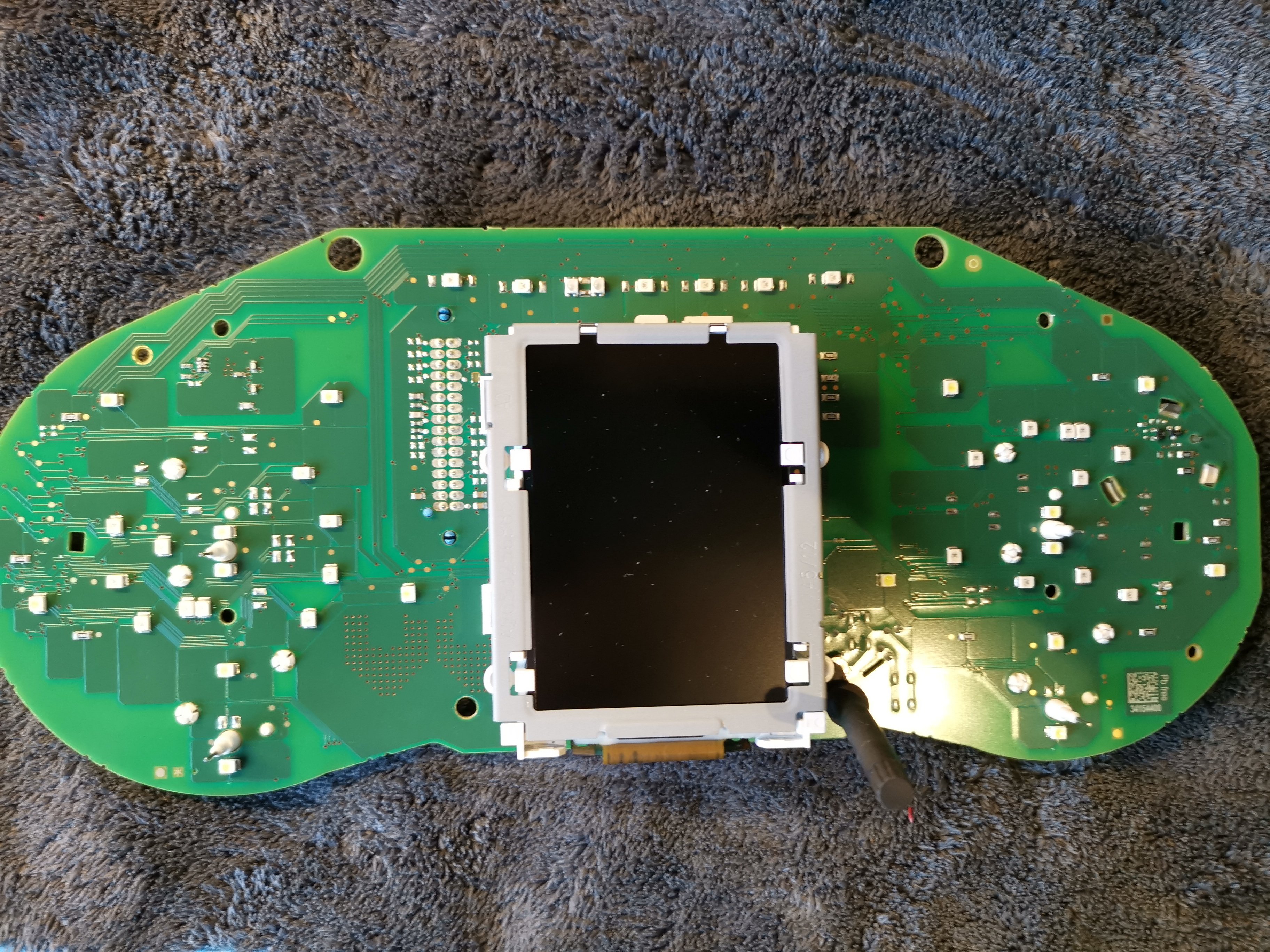

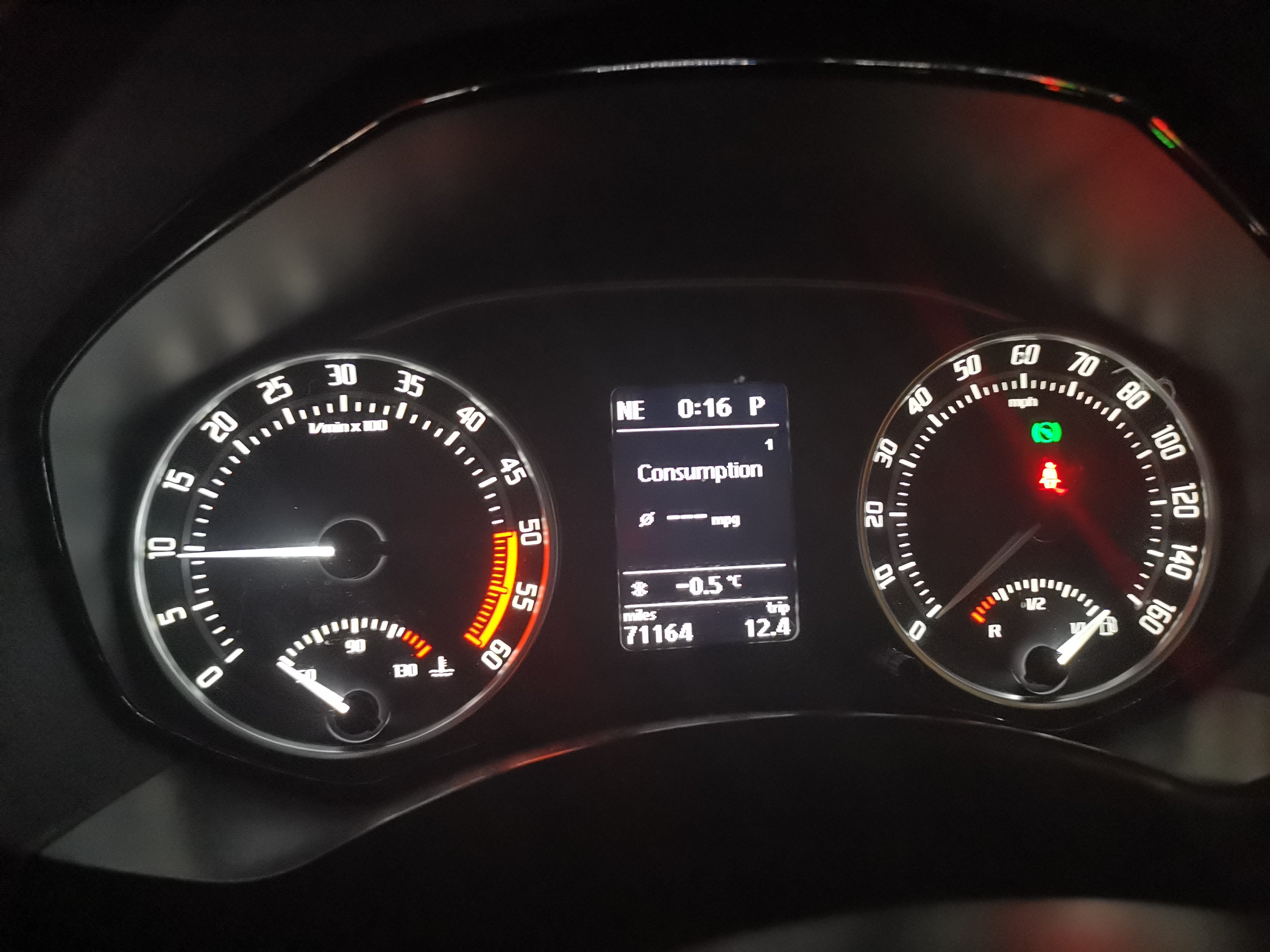

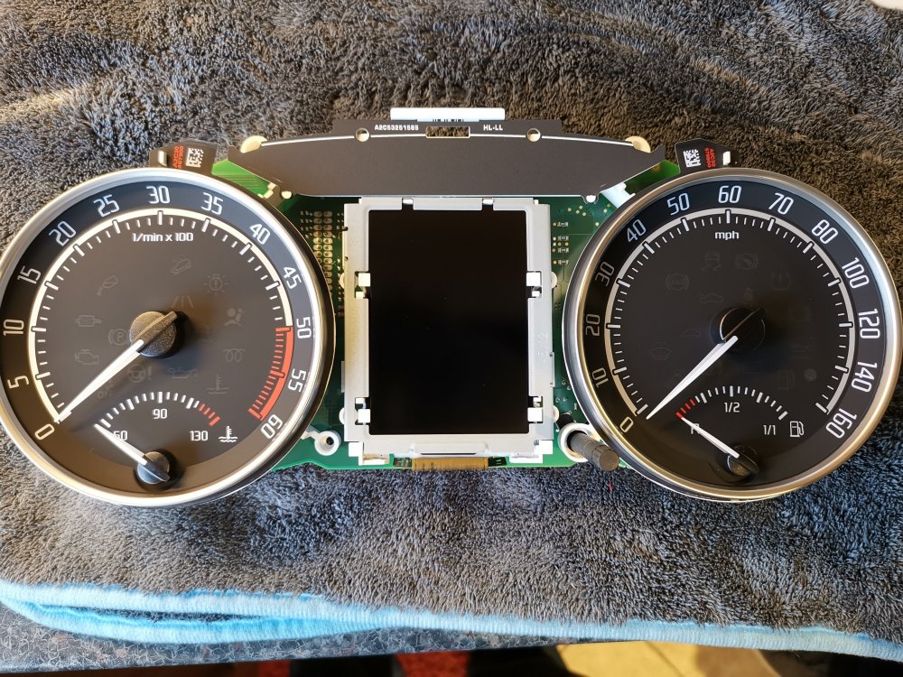

Well took the bull by the horns today and took the dash out to change the speedo needle bulbs. Replaced the rev counter ones at the same time so they would both be the same brightness. The guide in the files section was really useful, all went well and the only fiddly bit was getting the needles back on, push too hard and they make a clicking noise doing the sweep, don't push enough and they don't sweep or they fall off. Bulbs are fiddly wee beggars to solder onto the circuit board as well but they were cheap at £6 for 25 of them.
