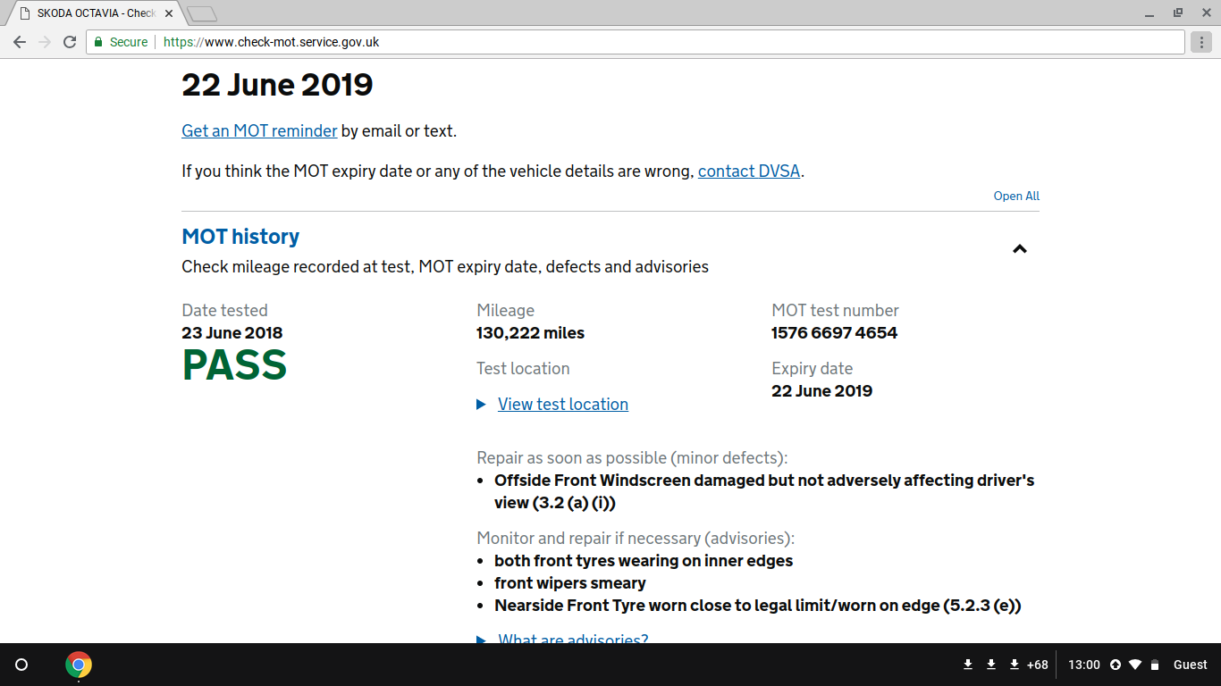

Here is the last MOT.

Looking at tyre ware on MoT I'd want a full 4 wheel alignment to have been done.

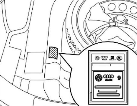

As mentioned, this car will also have been subject to the VOSA recall for the injectors, which on some cars had terrible ramifications. Check for poor cold starting, rough idle when cold, contamination of the engine oil with diesel (rising engine oil levels). There should be a sticker in the spare wheel well it it's had the recall done...
