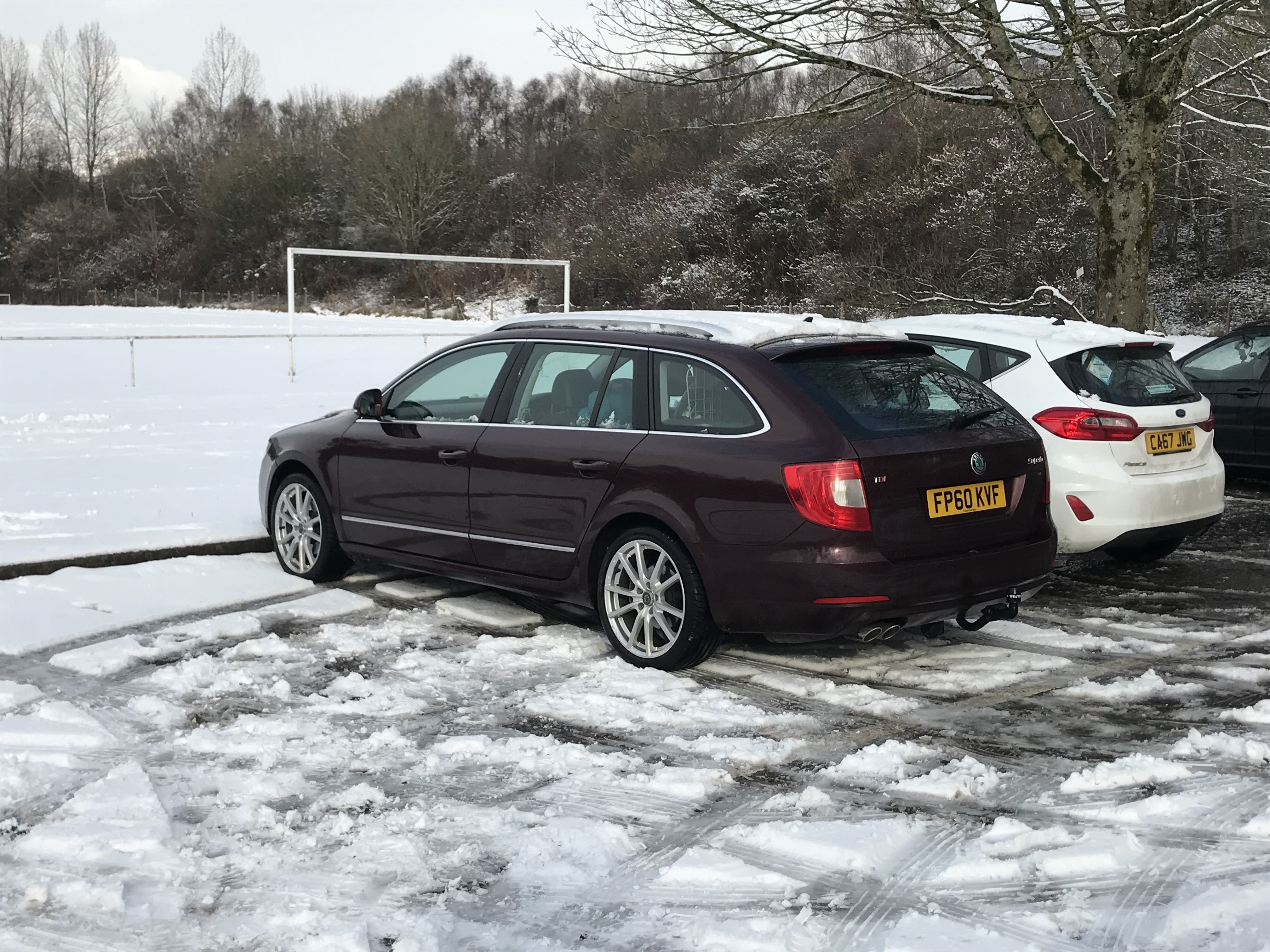

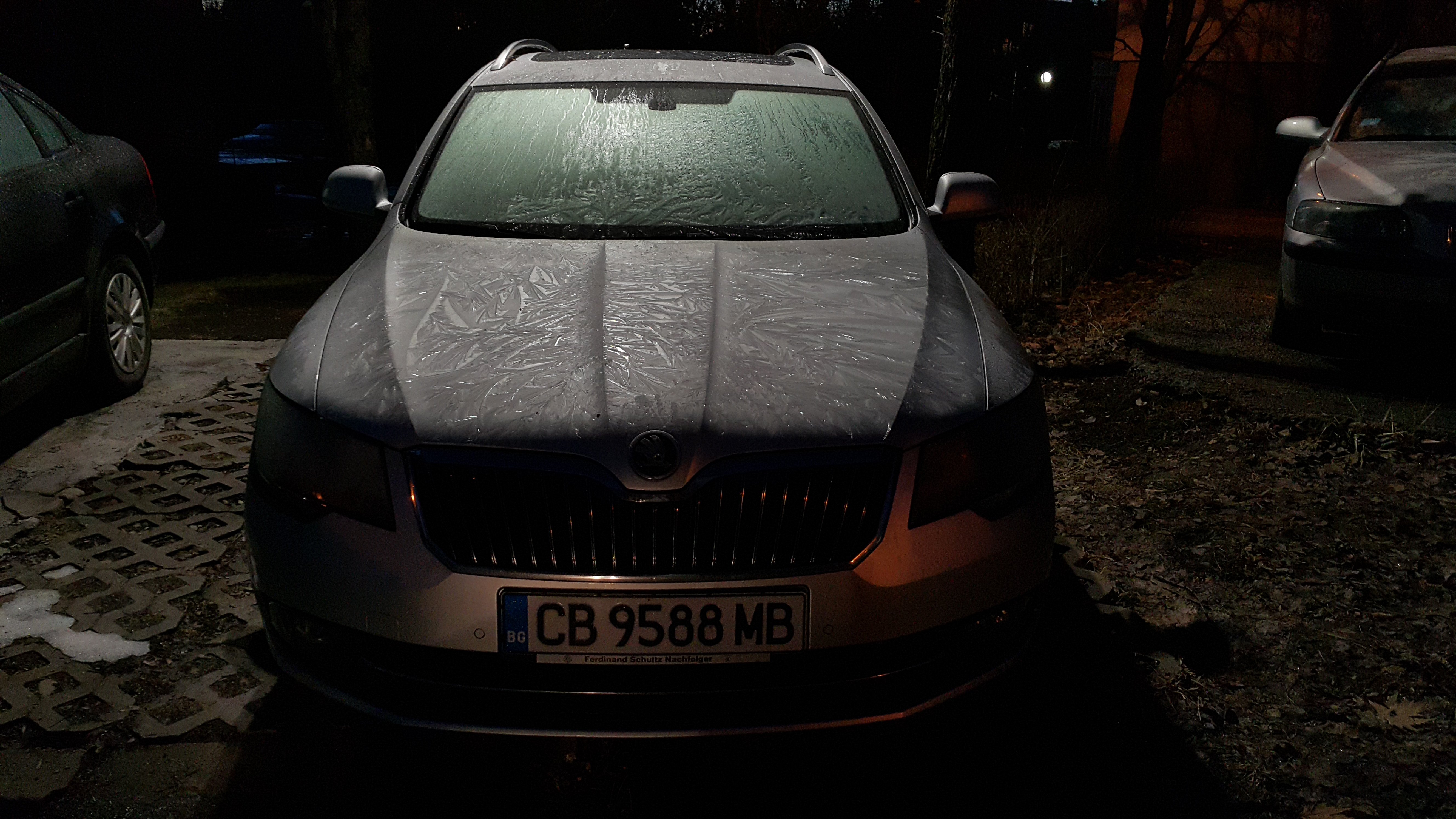

To "Jonnys19882" - It is a dark red Beauty :) Here is mine, from this cold morning..
They look good in cold weather B)
