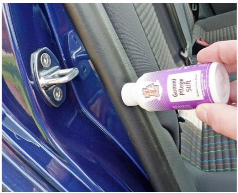

Are you sure it is the trim that is squeaking? As the car contorts slightly as you go over speed humps the doors can move against the rubber door seals and squeak slightly, again a relatively common issue, although not exclusively with Skoda.
Gummi Pflege is brilliant. A quick wipe with the in-built applicator along the door seals and it's cured, at least for a year or so...
As above, I get these squeaks but have put it down to the seals moving over the flexing chassis as it only happens when the chassis contorts in certain situations. I had used a product to lube the seal which seems to fix it but will now look at the product suggested by silver1011.
If I push the bottom right corner of the door pillar large black plastic it squeaks and it also squeaks going over any bumps in the road etc. The drivers door is now starting to do the same, but it’s over the entire length nearest the door edge. I’ve ordered some of your suggested product, to rule out the seals.
