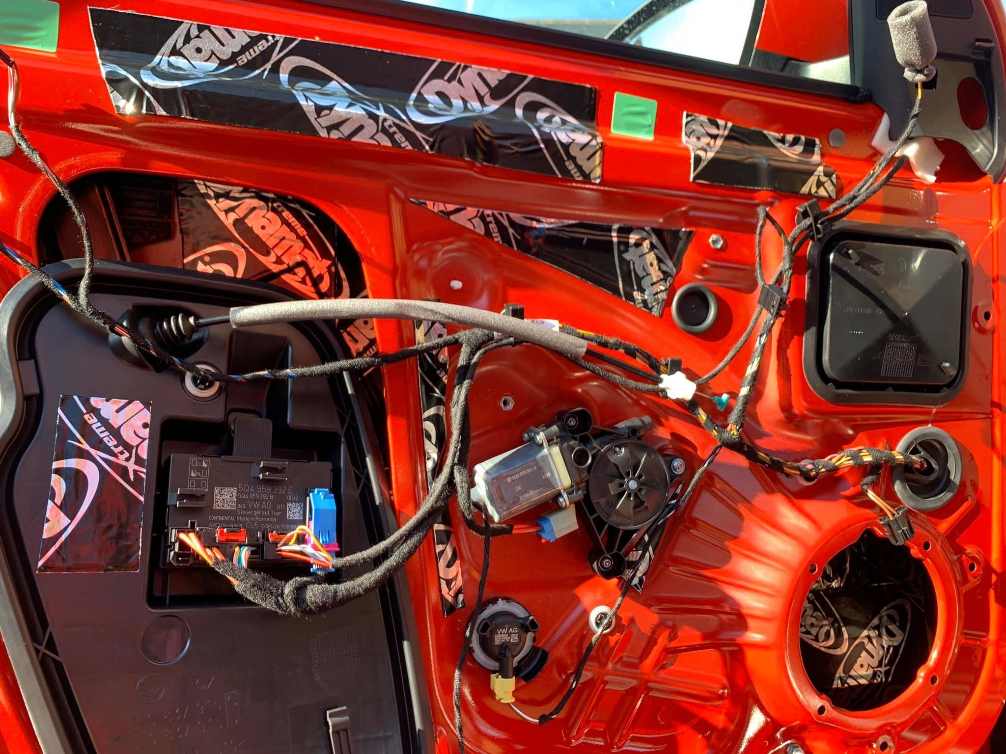

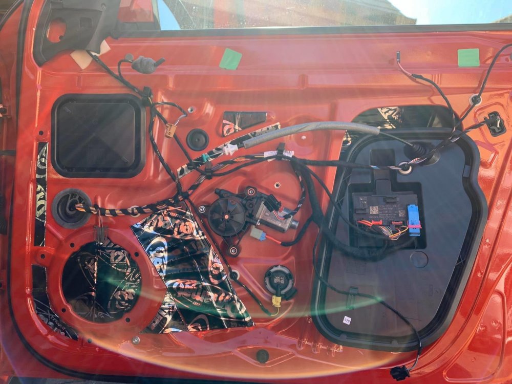

I’ve started Dynamatting in preparation for an Audio-tec Fischer Match system: https://www.audiotec-fischer.de/en
I’ve done the Dynammatting in stages, with bonnet, boot floor, spare wheel well, tailgate, under rear seat & front doors done so far...rear doors and quarter panels (thanks Sasha!), hopefully completing the job this weekend.
Just doing the front doors last weekend has made a massive difference to the crappy standard system, so worth spending the time to do if you’re going to upgrade the speakers.
