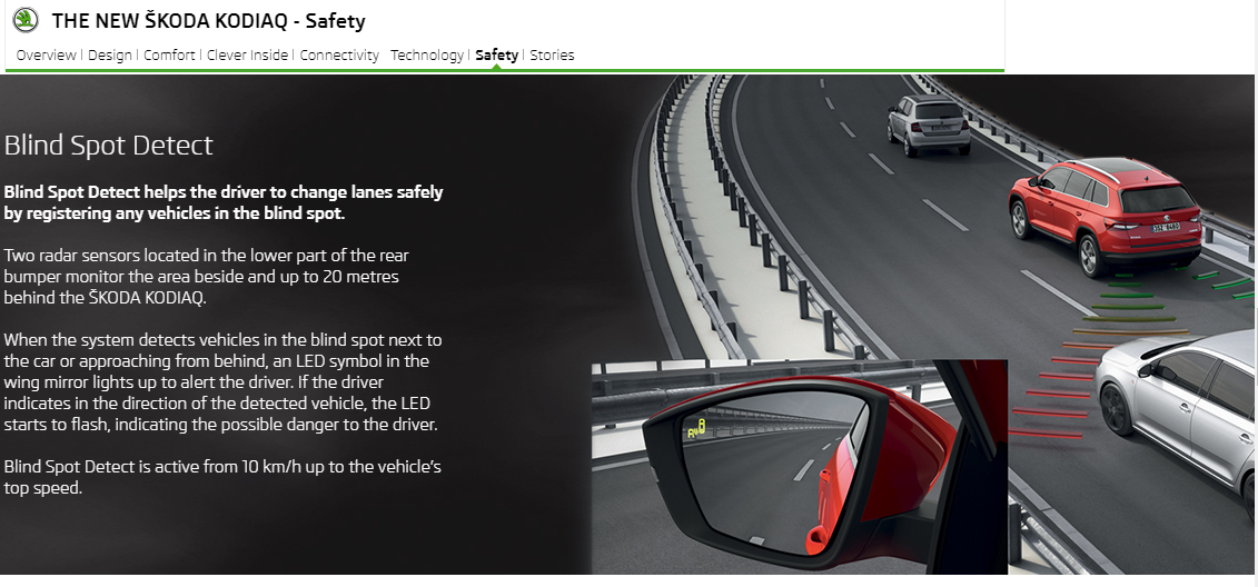

This is a quote from VW's website that describes the system's operation:
The system is designed to alert you only when necessary: stationary objects or oncoming vehicles do not trigger warnings. It also ignores vehicles which are more than one lane across, so you're not distracted with frequent warnings.

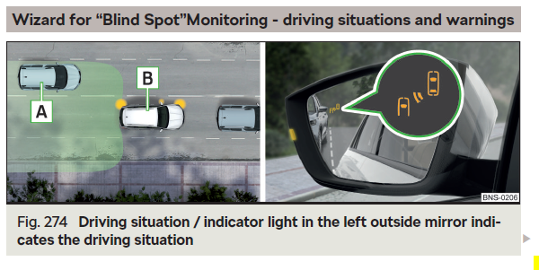

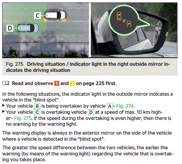

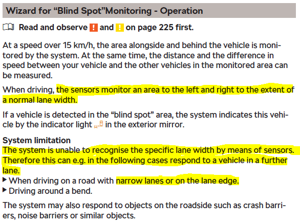

This is from the Kodiaq's manual:
› Wizard for “blind spot” monitoring - operation
At a speed of more than 15 km/h, the area alongside and behind the vehicle is monitored by the system. At the same time, the distance and the difference in speed between your vehicle and other vehicles in the monitored area are measured.
When driving, the system monitors an area the size of a normal lane width to the left and right.
If a vehicle is detected in the “blind spot” area, the system indicates this vehicle by the warning light  lighting up in the exterior mirror.
The system is only supposed to register the presence of a vehicle that is less than 3.6 metres from the vehicle. A standard motorway lane is around 3.65m wide. If a typical car is 2m wide, that leaves an average gap between the car and lane edge of 800mm. Same for the car in lane 3. That's a combined width of 1.6m plus the standard lane width of let's say 3.6m. That's a total gap between the two cars of around 5.2m. that's a darned sight more than the 3.6m Hella are quoting.
In my Superb, the only time I would get a trigger from a car that is 2 lanes away, is in a contraflow/narrow lane scenario when driving through road works. Also on dual carriageways with particularly narrow lanes, such as the A3 when driving into London (for those of you who are familiar with it). This is to be expected, as the system cannot distinguish a narrow lane scenario and adapt accordingly.
The slip road issue is at the point where you merge with the traffic, so still in the slip road itself, but the car thinks it detects something directly alongside, when in fact it's still 2 lanes away.
