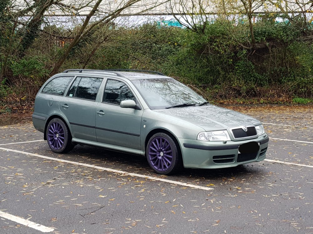

The majority of uk 4x4's were produced after 2001 and actually have the ko3s turbo, but are only tuned to 150bhp not 180bhp like the vrs. The gear ratios are lower and the 4x4 is certainly worse on fuel, would deffo have benefited with a 6th gear! . Stick winter tyres on and are amazing in snow! A remap and 200bhp is easily available... here is mine.
