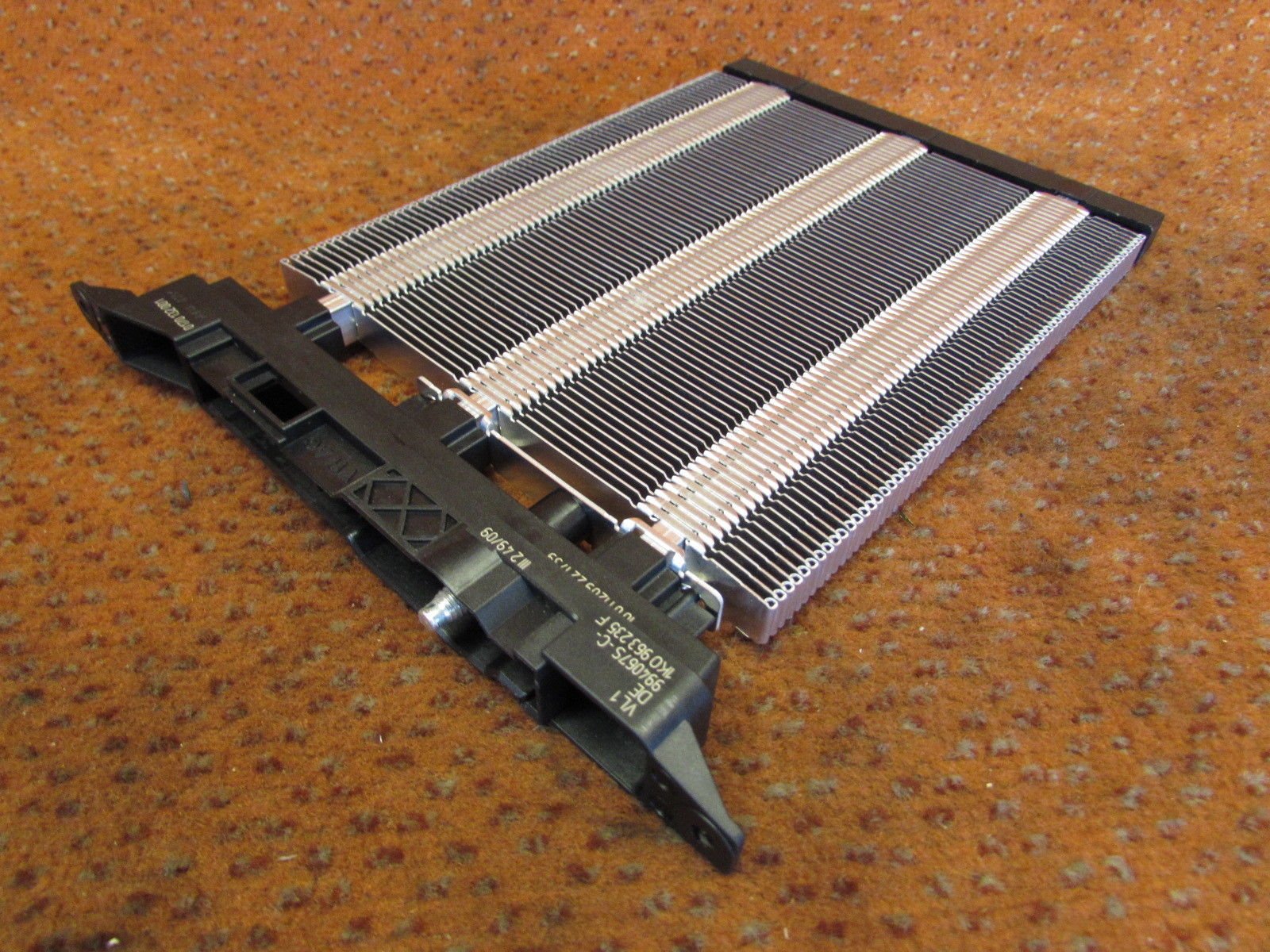

fit a PTC heater fr heat instantly:cool:
That's interesting. Presumably an auxiliary heater, do you have any more info'?

@Gdcobra
I will look for the post later today once I get a sleep:sleepy:
Had a sleep
PTC Install with help from @wokwon
7th last post is the pdf file telling you how it is all done.
I want to upgrade mine later with the full canbus controlled unit rather than mine that I rushed and fitted with a switch.:sweat:
