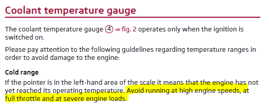

I'm no engineer, but I try to set off as soon as possible but keep the rpm's low until the engine is more or less up to operating temperature.

2) Keep the revs below 2500 when changing gears & accelerating  and cruise in the 1500-2000 rpm until warmed up.
3) He was quite keen that being warmed up meant the oil (not coolant) was up to 80-85C. If you can tell the oil temp, then wait until the temp gauge (i.e. coolant) is in the middle (90C).
