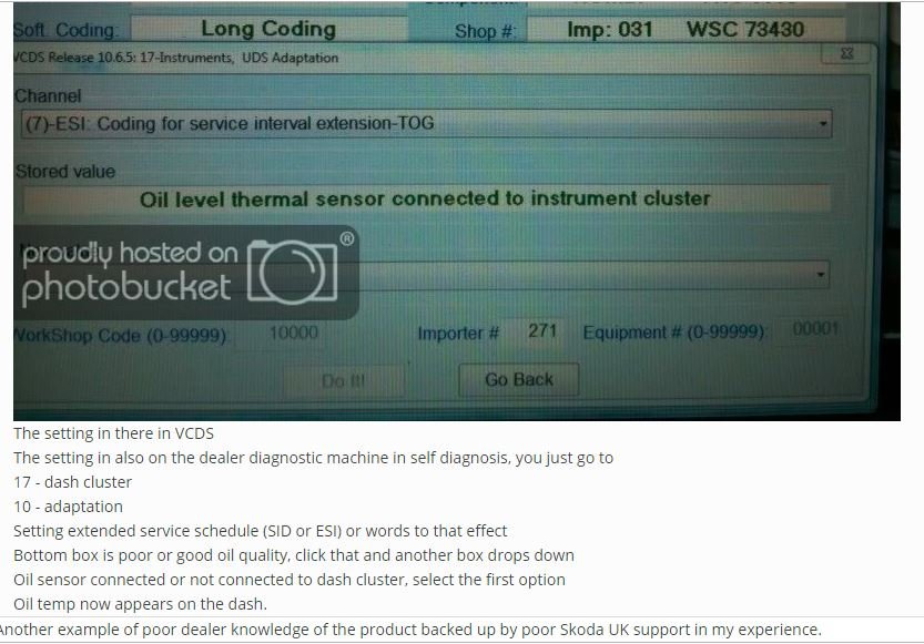

I have an octavia 2011 1,2 tsi, with oil and temp sensor in the oilpan, and with the little instrument cluster (803K). It driving longlife, and the adaptation in the instrument is set to "Oil level thermal sensor connectet to cluster" just as in the picture here. And oil qiality to "good". But i have no oil temp in my cluster - but i have a digital speedometer Which shows the same as the analog speedometer, just in numbers. Its not a big one, but its there among the choices, like temt, speed warning and so on. But how do i get the oil temp to show ? The manual says it should, but the manual also not saying anything about a digital speedometer ?
