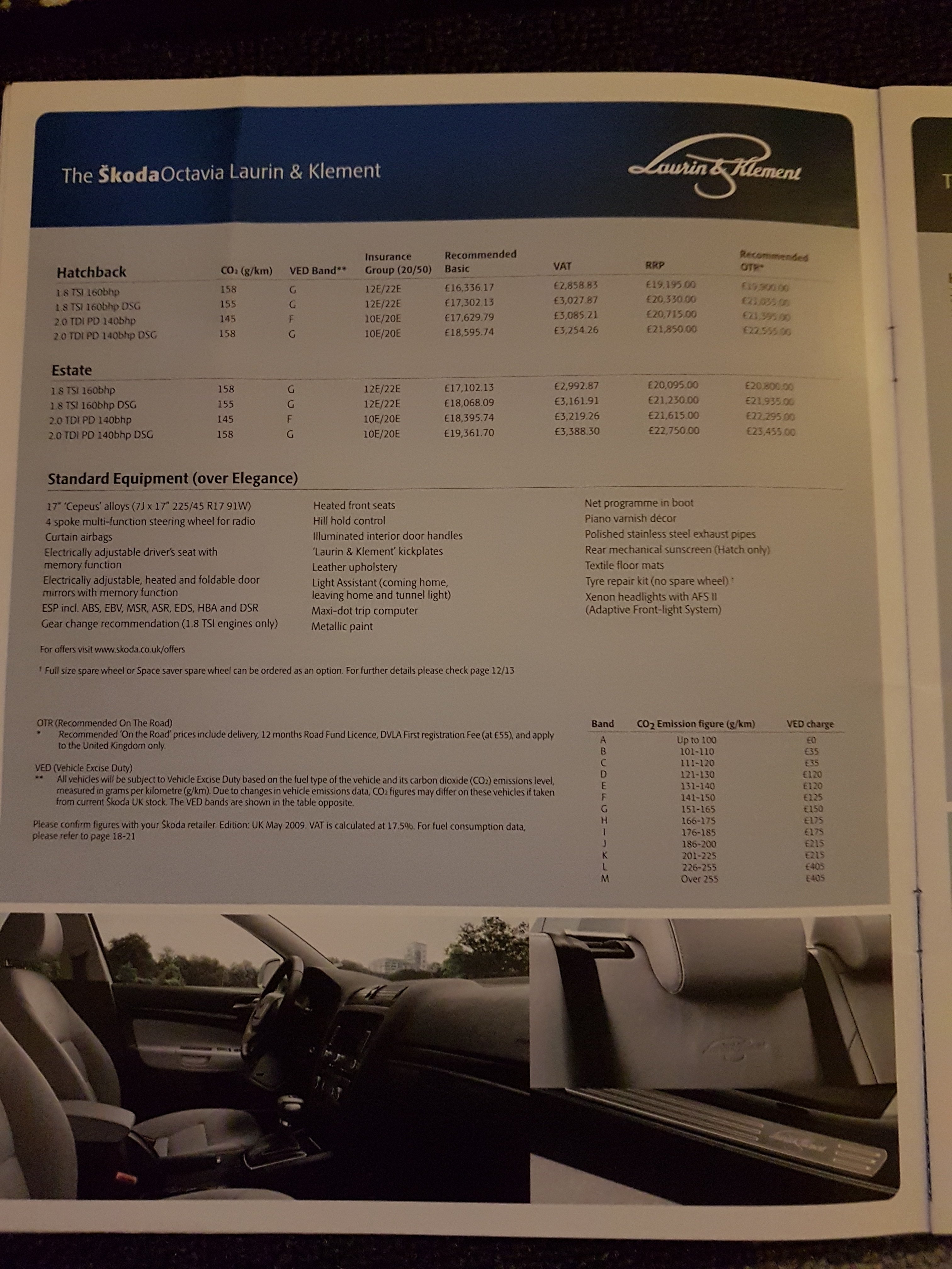

I have a 2010 Octavia brochure, I will check that in a wee bit. From memory there should be Lauren & Klement embroidered on the front seats.
For some reason I seem rather reluctant to leave the sofa,,,
No rush:thumbup: I'm just a bit perplexed, not noticed anything embroidered on the front seats,
According to my 2010 brochure the L&K came with Light Assistant: Coming Home, Leaving Home and Tunnel Light.
This is what it is also referred to in my spec and I have the Auto Lights switch.
