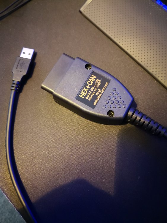

I think @Babs may have it the nail on the head. What version number of VCDS are you using and please will you post a photograph of the cable you're using to connect it to the car? Is the copy of VCDS registered?

No.1 cause of "VCDS not working" problems is a fake eBay lead!
As far as we are aware the cable is genuine, and as you requested here is the image of the cable and the version of VCDS is 18.2. The cable has been used previously on a Mk5 Golf and an Audi A3 8P and there were no problems with them and all of the coding was stored.

@Miket65 The HEX+CAN is an old interface now. It doesn't support working with some modules in cars after 2015. I believe Ross-Tech run an upgrade program if you want the latest cable. Your vRS II is older than 2013 so it should work fine with the cable you have.
