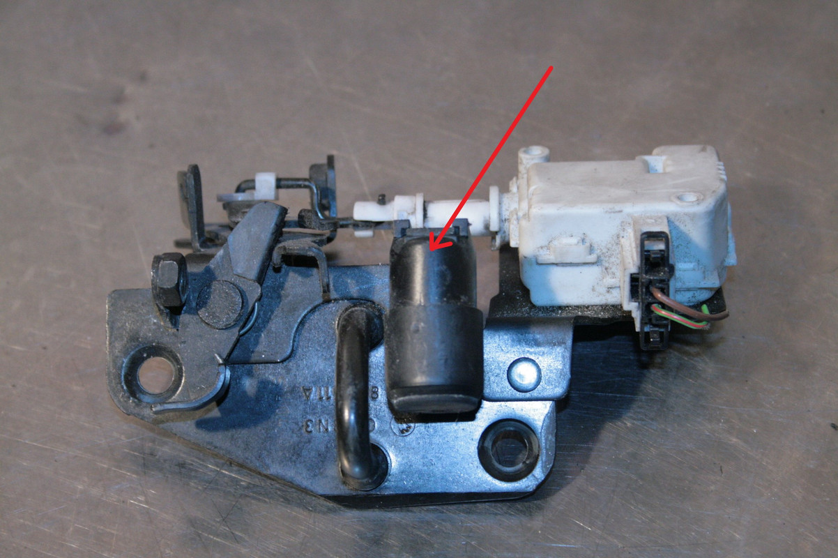

The only other issue I have with the car is a very dodgy boot release mechanism. It's one of those where you have to pull a lever in the driver side footwell. I often have to pull the lever a few times, lift the boot (it doesn't open), go back round to pull the boot release again AND only then does it open. Although sometimes, especially when icy it just wont open at all.
There are a few moving parts to the mechanism. Would anyone be able to offer any advice on where to start with say lubrication or any other advice would be most welcome.

There is a spring-loaded plunger which pops the boot lid up. Give it a push and check it's still springy.

The spring loaded plunger is very springy which is good. I'll try some silicon spray first. and i'll wipe the boots seals with de-icer.

Had this on mine, didn't work from inside or off the fob, in the end I checked the switch contacts with a meter and you could see there was a signal going to it so I just replaced the boot lock plate entirely with another used one, been fine since :D
