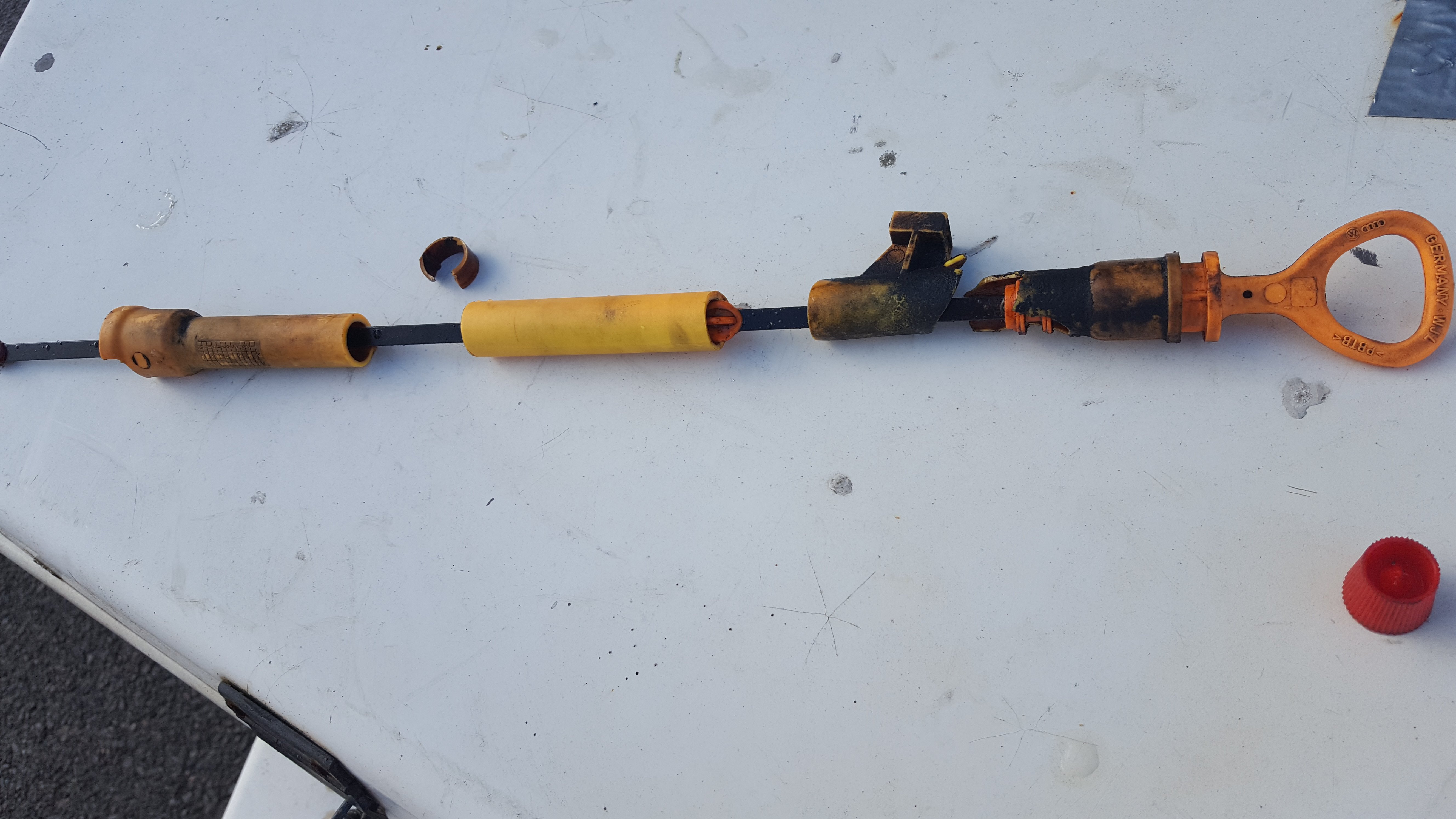

You have just jogged my memory by mentioning the CCV system... I didn't think much about it at the time but my dipstick holder spout cracked and broke shortly before the starting problems began.   Would this affect crank case pressure?
Edited by Blueb4sunrise
Yes, you basically have a good amount of un-metered air getting into the engine via the crank-case which is making it run lean. Get a new dipstick and see if it helps

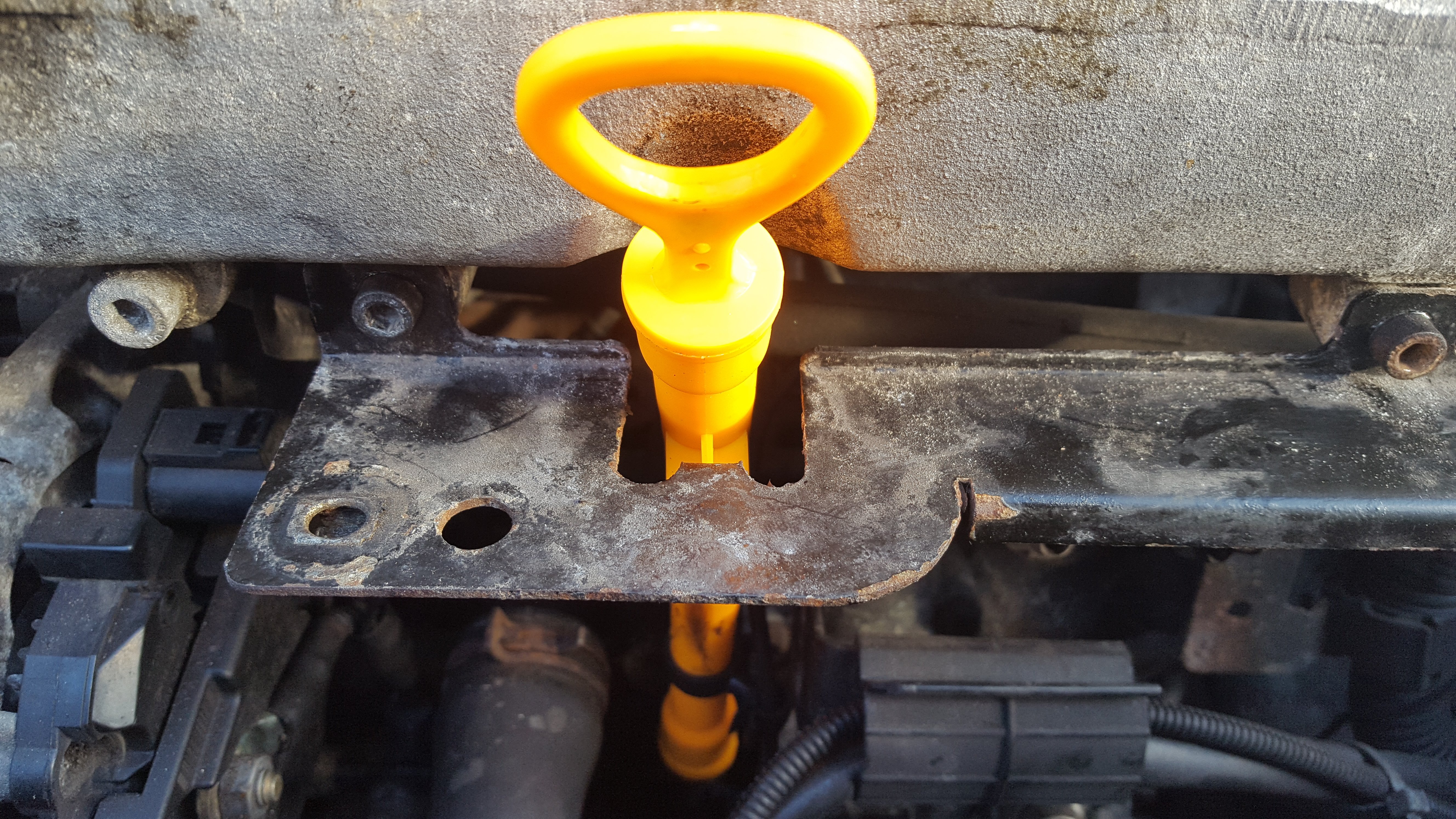

I ordered a dipstick and guide spout from eBay.  I will still go ahead and get the VAGCOM on it and see if there are any other niggles.
Thanks for your helpful comments.
Out with the old and in with the new dipstick assembly.
It needed fixing anyway but it didn't help the situation.
