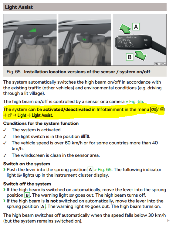

If you have " Auto Lights " the light switch should look something like this
Yes, I do have the Auto lights switch and it is always left in that position but I did not think that controlled the auto light dimming,  only when the lights illuminate in rain and dark weather etc.

The only automatic dimming of the headlights feature is the HBA (High Beam Assist), which automatically switches from dipped headlights to main beam and vice-versa.

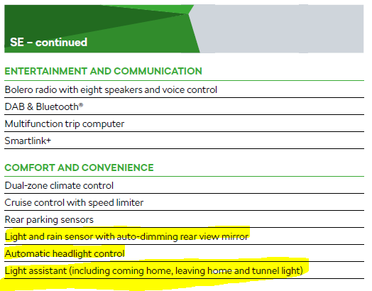

The SE L gets everything the SE gets plus more.
The SE already gets the light and rain sensor, automatic headlight control and the auto dimming rear view mirror...
What doesn't help is that they also claim the SE (and therefore the SE L too) get's "Light Assistant".
Which by all accounts is different to "Light Assist", or otherwise known as High Beam Assist (HBA)...
Confirmed by the fact "Automatic Heam Beam Lights" are a factory cost option on the SE L...

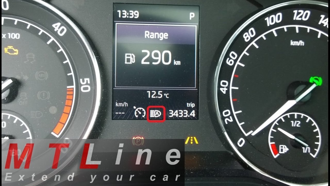

If you have HBA and it's active you will see the symbol in the Red Box ( under the Temp 12.5c
Bingo! Many thanks, no symbol has ever appeared so I presume I do not have HBA. Strange that I have a rear view dimming mirror and auto wipers, as the three seem to come together as a package?

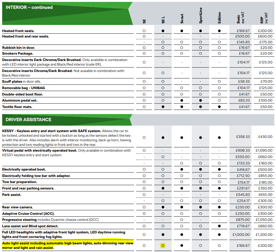

Only these three features are standard on the SE L...
Light Assist (High Beam Assist) is the £200 option...
