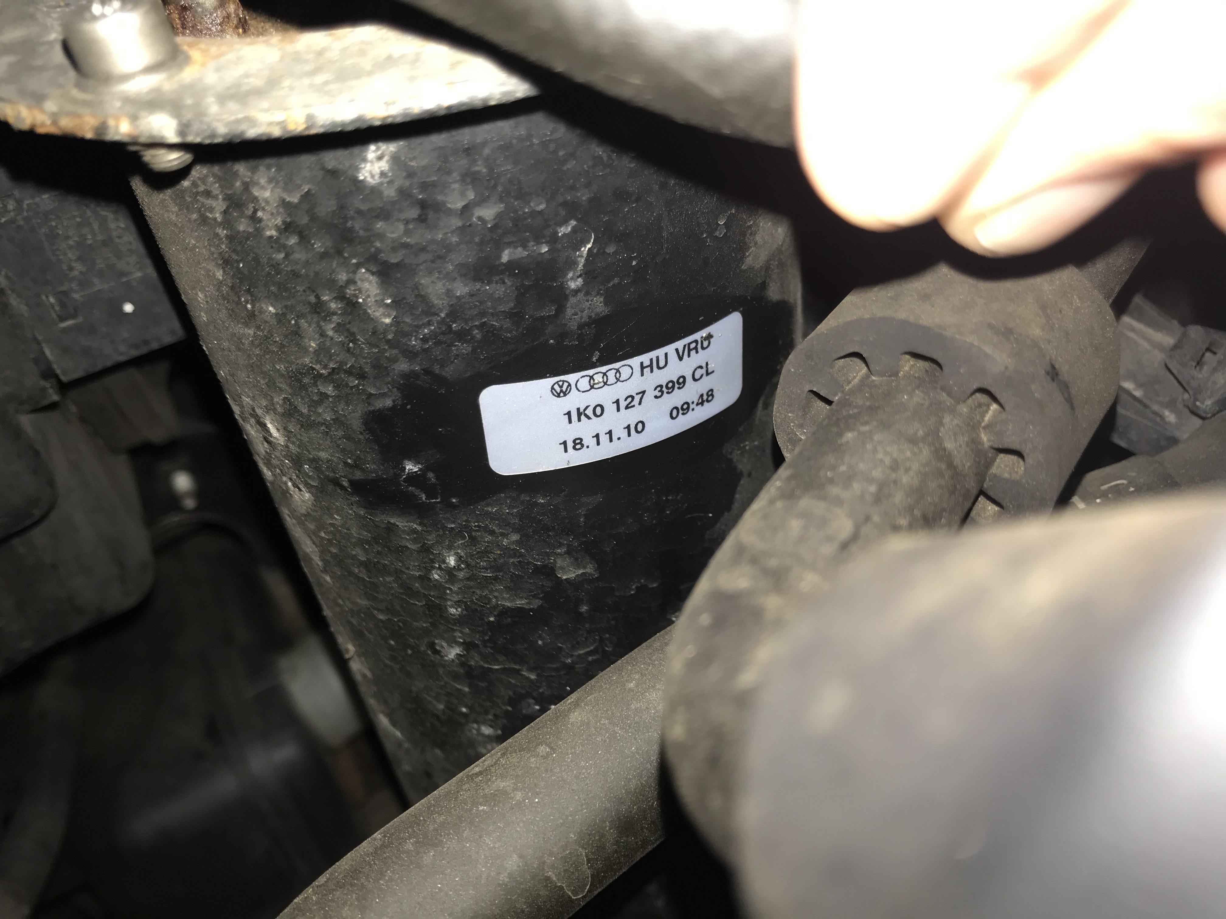

Thanks dmarolj! My knowledge of mechanics and VCDS is not very good. Sorry if this was covered in your post but I couldn’t see if mine could have either hhc and xds. This is the number on my pump.
any help appreciated
1K0 127 399 CL is a fuel filter housing not an ABS pump ;)
HHC should only hold for about 2 seconds, any longer requires an electronic parking brake.
I stand corrected .. thankyou
