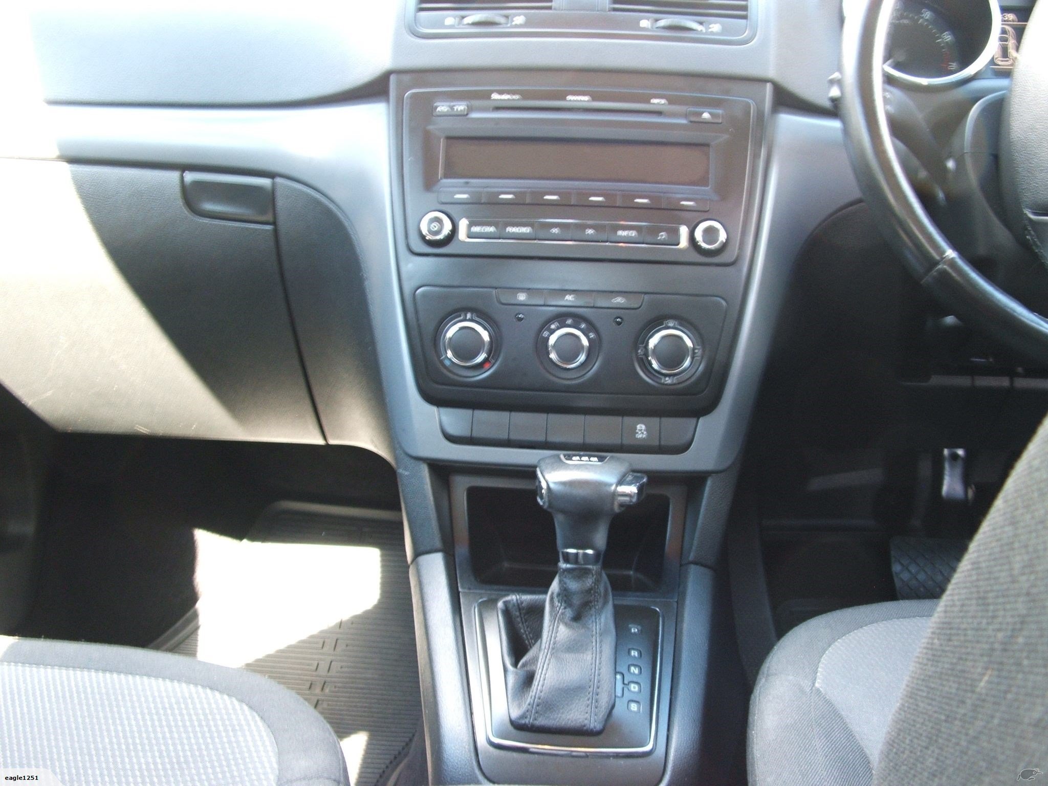

May seem like a daft question but is the photo you posted of your car?
No it's not but it is exactly the same. Thats a pre-facelift car, ours is 2017 facelift but it has the same controls
Edited by bazbo1
The reason I ask is that, and I stand to be corrected (!), that the photo showed a layout I thought was pre at least 2015 yet you say your vehicle is 2017. Did you buy in from a Skoda dealer?
Nevertheless the condensation problem you are having is very weird.
In response to some comments on this topic on the other forum, I have found Skoda NZ very good to deal with unlike some of the problems people have had in the UK.
that photo is a pre 2015 vehicle, but we have a 2017 with the same controls. the radio , gear lever etc are all different but the dials are the same. it's just the non climate control version.
