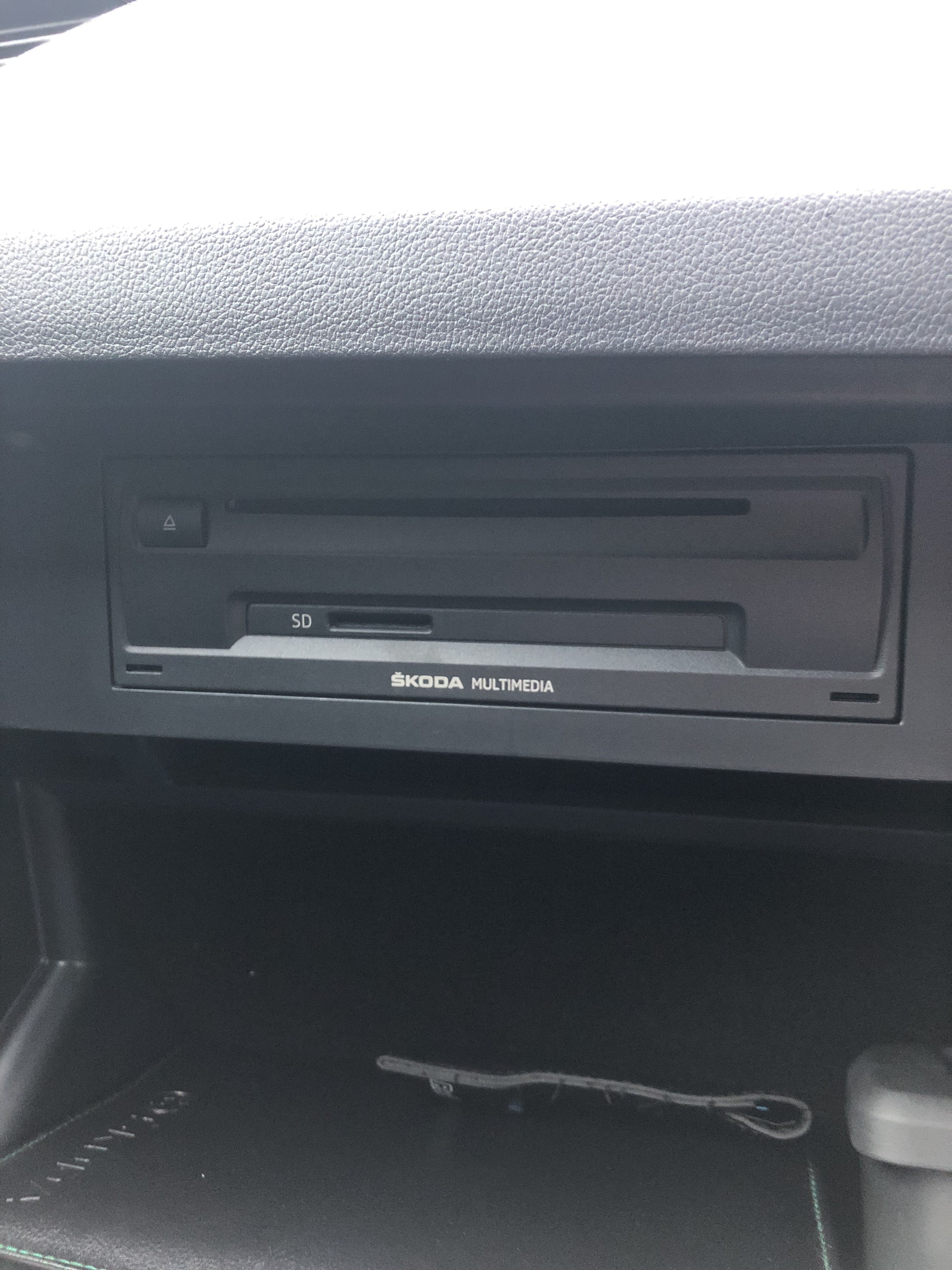

I don’t have smartlink, but I do have the bigger Columbus display and the unit in the glovebox with 2 SD card slots and a CD drive.
Must be MIB1 - mine is a 2013 VRS.

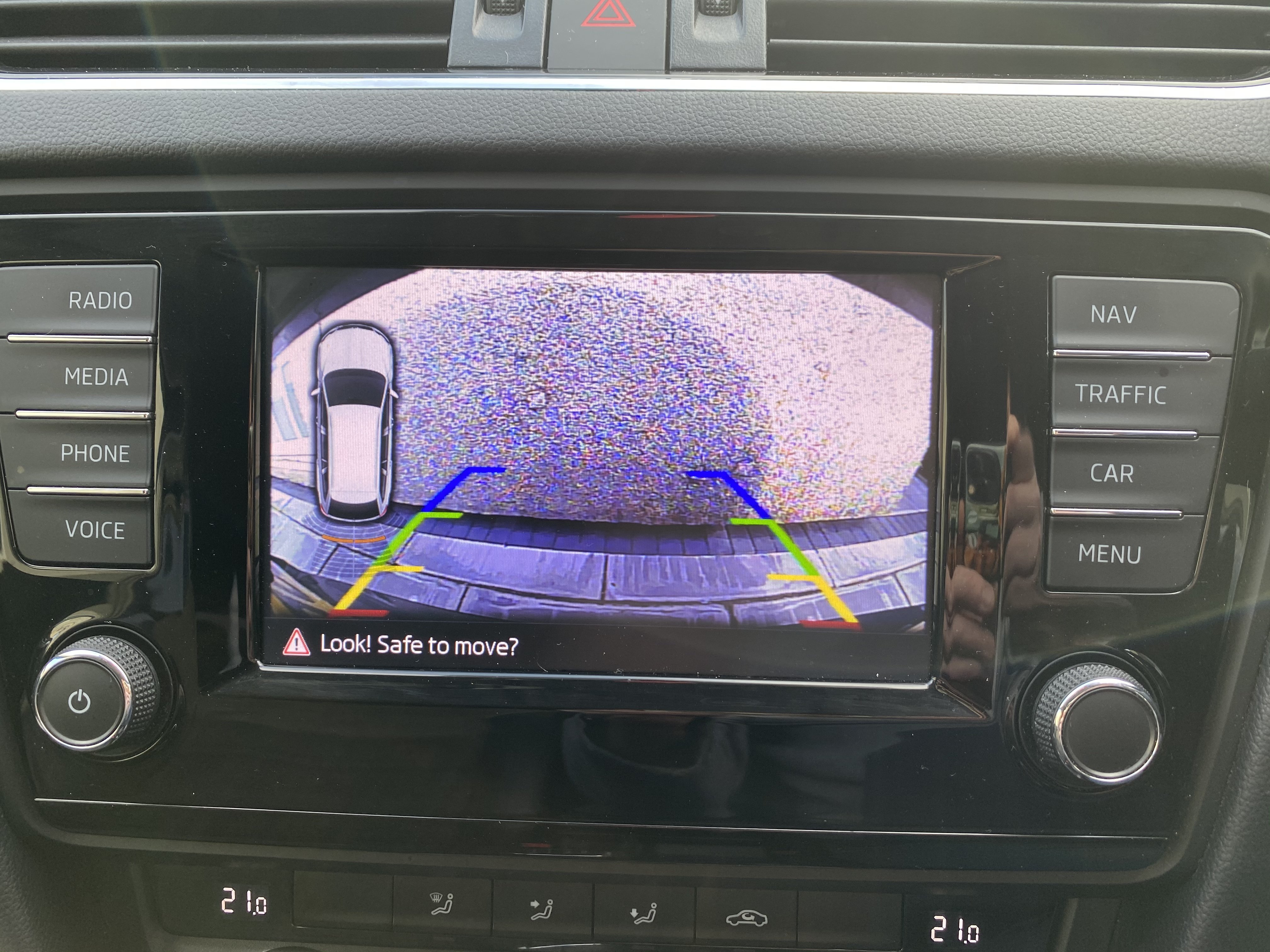

Hi StuFan,
This is the unit i currently have.

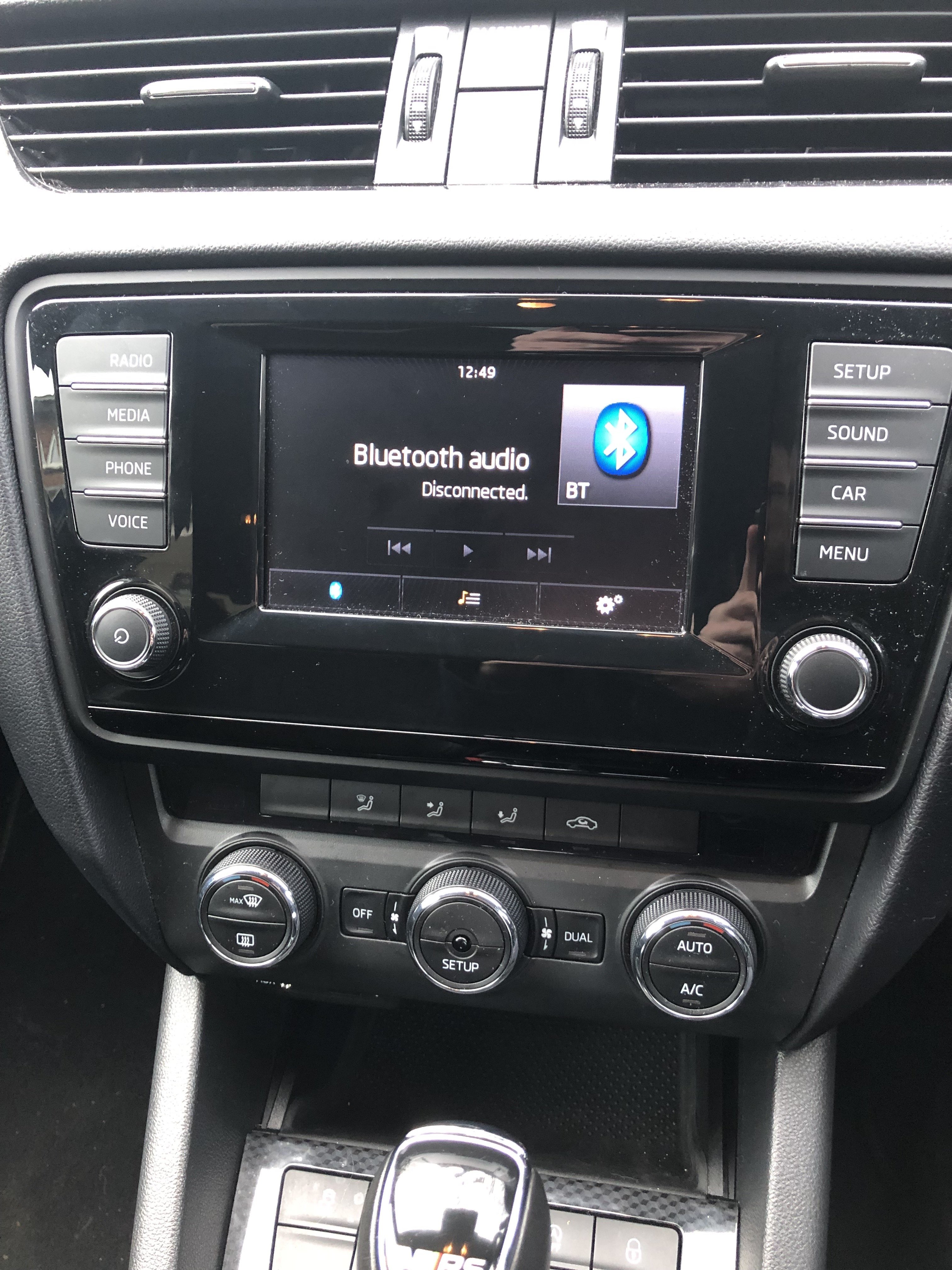

Hi Sasha,
This is the unit and screen i currently have in the car.

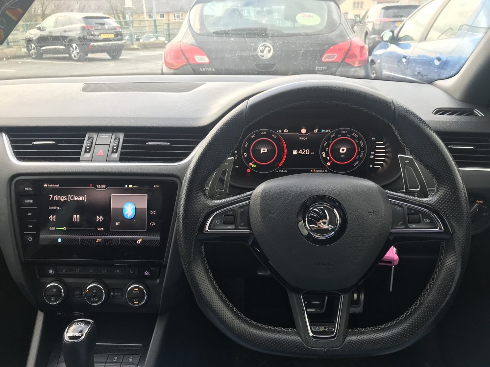

Yep. I forgot to add that week 22 2015 build was the change over date from MY15.5 to MY16. At least if you want to do a MIB2 upgrade you won’t have to change the screen. I recommend it though. I have the MIB2.5 Columbus in now (MIB2 unit re worked to MIB2.5 spec) and the bigger 9.2 inch screen and it makes such a big difference IMO.
Nice Sasha!
Loving the Virtual Cockpit as well.
Did you re-work the MIB2 unit to 2.5 yourself or did you have to get someone else to do that ?
Sorry for the late replies everyone, been a busy couple of days.
You have the part numbers correct, alternatively the 5E0919606 8 inch PFL Columbus screen also works with it. I didn’t touch the new radio, it came prepared and ready from the genius that is pab567 on here and he is the man I recommend for radio work. If you get an Amundsen or a Columbus he can help. Please stick to a 5Q0035874A Amundsen made by TechniSat, not a 5Q0035874B unit. These can’t be worked with. Also with Columbus units, stick to the ones made by Harman.

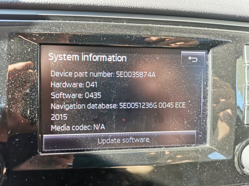

Just stumbled across this and your very helpfull and in the know, i have seen a  5E0035874A on ebay would that be a straight swap for my mib2 and is the smartlink activation tied to the screen or the head unit, my unit has 2 sd's and no cd but i would like a bigger screen
If your radio part number is 5Q0035874A or B then it’s a MIB2 Amundsen (certainly looks it in the picture there) so you will be able to swap the screen with an 8 inch FL unit (5E0919605M is the one you need) without any mods except cutting a locator tab away on the screen connection plug. The screen is just a screen and displays what the radio commands so any features the radio has are tied to the radio. If you have SmartLink now, changing the screen won’t take it away. If you don’t have SmartLink now, changing the screen won’t add it. The APP button won’t work but you can access the traffic menu and the SmartLink menu through the main menu as you do now.
