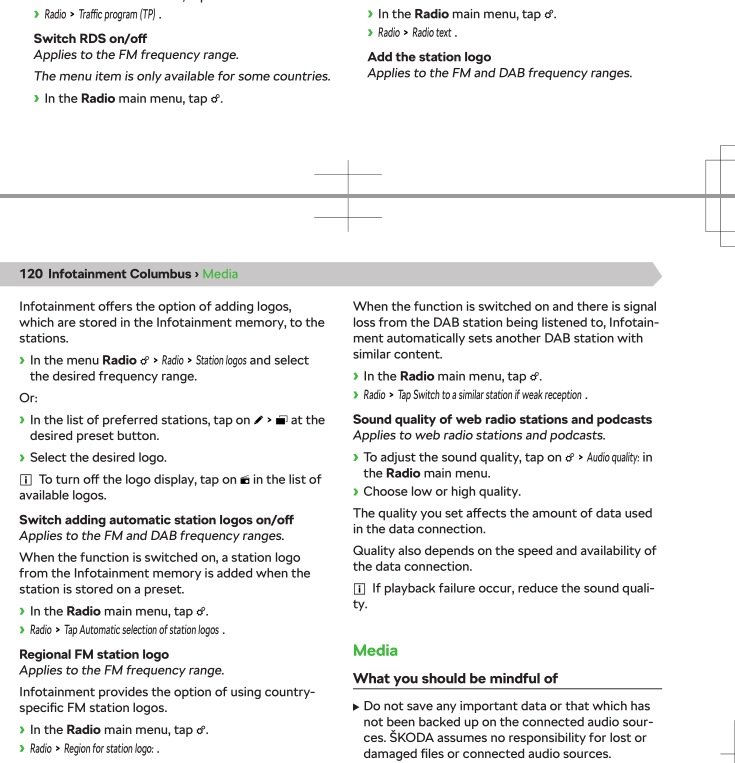

I have tried this method from the manual, but the device just doesnt see logo files on the USB.

No, you can't add them manually like older units. Where did you get the manual from, it can't be for your car

Well that was also in Seat manuals. It's those technical writers of old that computer companies use to write like ICL. There is a spec but programmers don't write to the spec so the two  don't tally.
It's the back door into mib units for toolkits in mib2 so management twigged to protect mib3 from hobbyists they had better prevent usb import. That's what is thought. The source of why the technical spec is at variance to the software.
It is for my car. Here is the cover page of the pdf.
They didn't do a re-print. It's whatever newer pdfs say but they may not be right. The issue effects all Vag cars. In the UK missing logos tends to effect the commercial stations more than the BBC. So yes it's a pain for mib3. Phonostar seem to have the license to maintain the logos for Vag via that download. The download isn't available for Seat but is for VW and Skoda. Seat get them over the air, that file is an update but if isn't  "uptodate" it's no good. Its all locked down on encryption signatures. Case of Vag over engineering it since that are frightened of hobbyist programmers that might write better code than them. Petty.

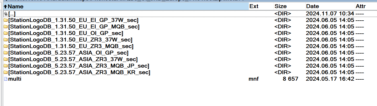

caught v1.31.50 for Mib3, size and content hugely increased
1,13 GB
previous v1.31.48b had 162 MB

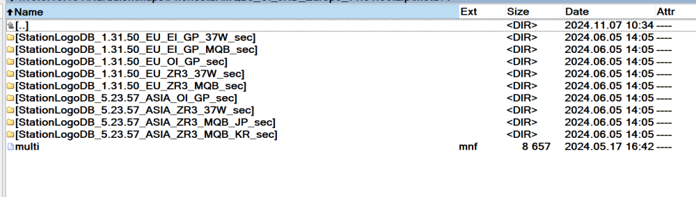

I've tried now to update logos with latest zip file, but update doesn't start at all. I have followed instructions from phonostar.
7zip is the best extraction tool, Vag recommended. Because of the encryption signature any noise in the file or wrong placement in how it's presented and it won't be seen. It's like mib2 high map presentation you have to get it spot on. A lot of posts in the past people were incorrectly presenting the file or it was scrambled by Mac OS. CleanMyDrive if using a Mac. They place a character sequence in each line which blows the signature encryption. These are just stumbling block in file preparation which stop the upload being seen.

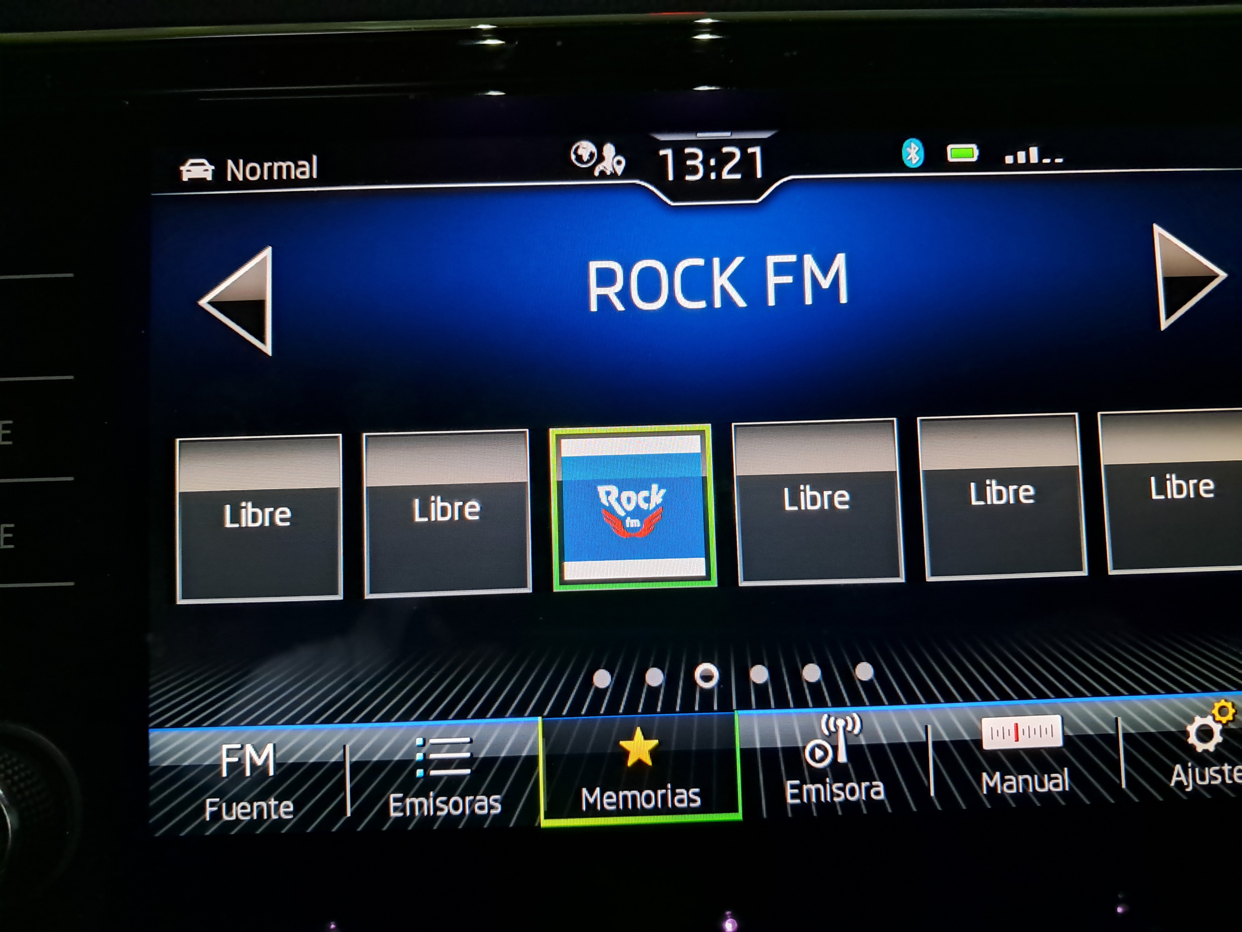

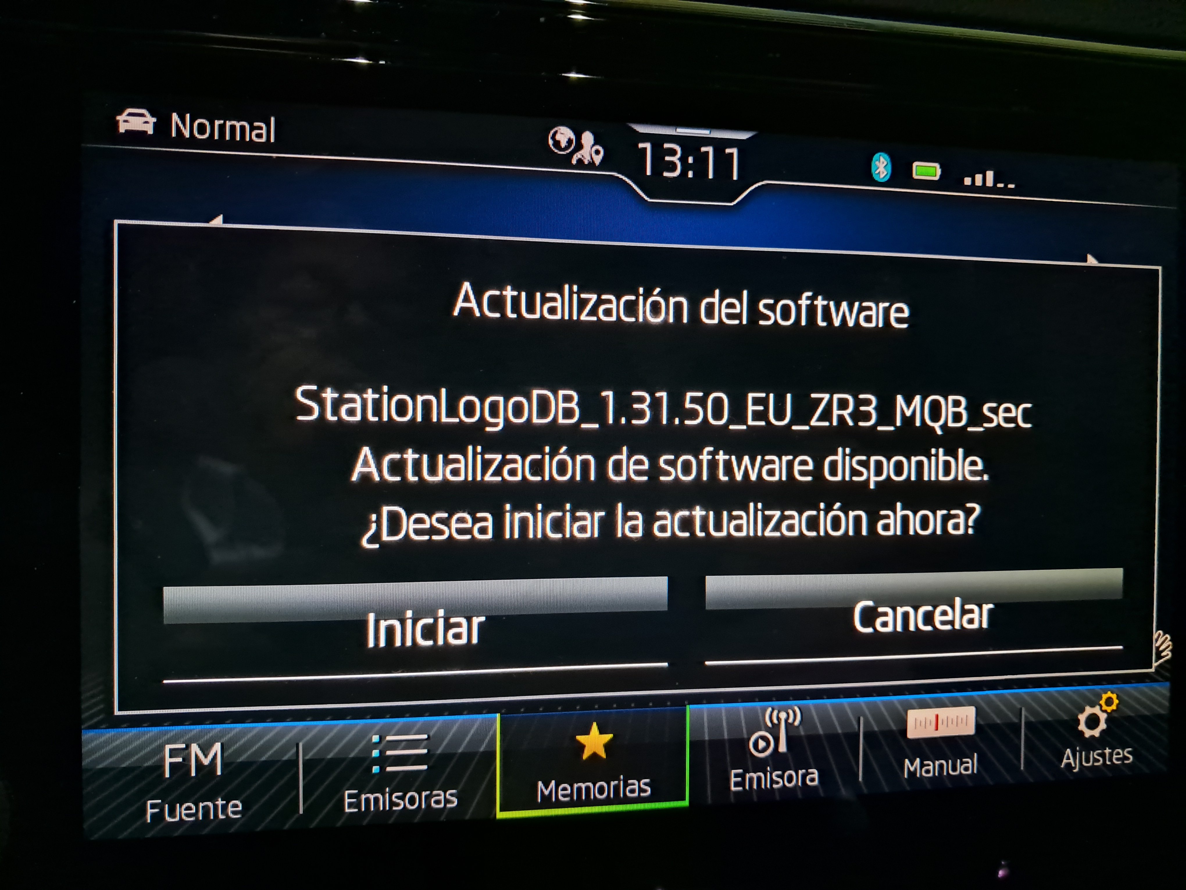

Hi friends.  Updated my superb FL RSDB
and finally appears my wished station  logo.
Great.

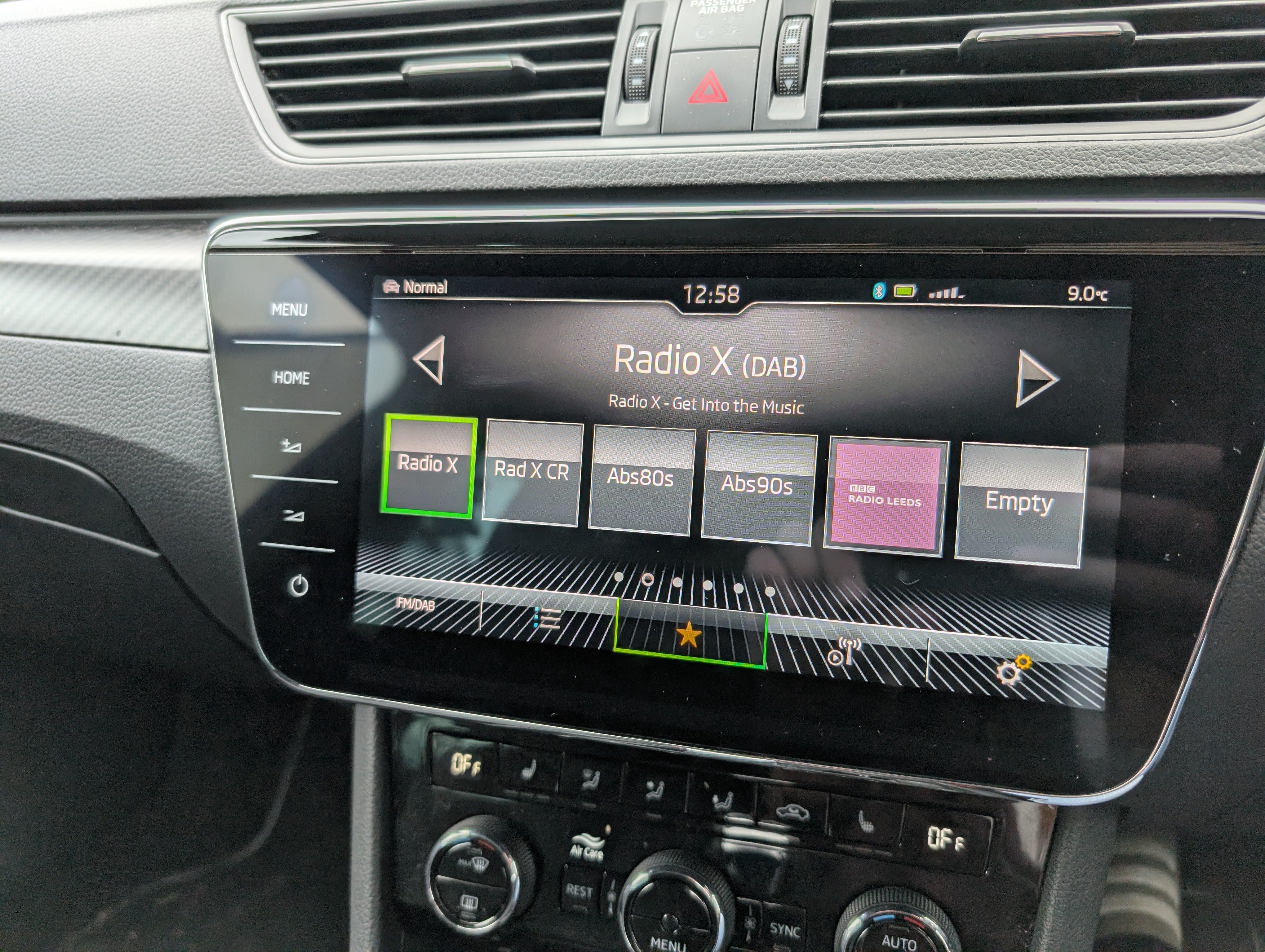

Just update mine to v1.31.50, used 7-zip this time. No logos for Radio X or Absolute stations yet  :sadsmile:
The database radio file uploaded ?... but they just haven't added the logos in ?. It's not that it didn't read the database ?.
It read the file and said it was completed. I guess it doesn't have those logos in the database
El 11/12/2024 a las 13:32, Vegarz dijo:
Hola amigos. Actualizé mi magnífico FL RSDB
y ultimente aparece el logo de mi estación deseada.
Genial.
Vaya, ¿puedes explicarme cómo lo hiciste? Llevo mucho tiempo intentando poner el logo de RockFm.
Gracias
Simply.
Go to first post of this tread and download the update that you need.
Done,
Thank very much  @MartiniB @vegarz
