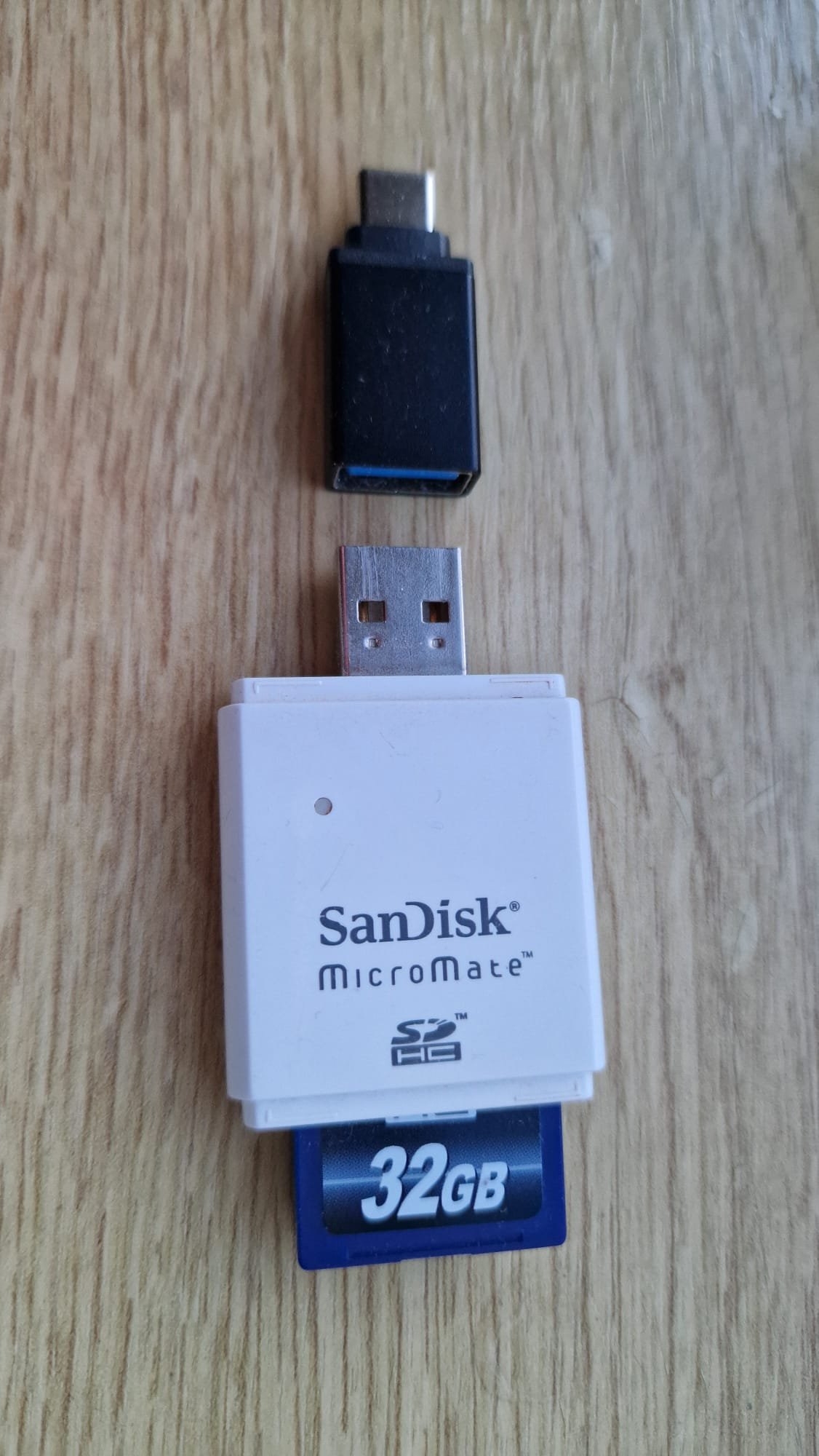

this combination works, Type-C adapter came with ŠS Mk3.FL 2023
Ah but one adaptor isn't like the next... that's the issue. On the Seat side a Retrofitter fitter that was selling firmware updates had one client with one of the ones that didn't pass data... I asked "what was the solution". The guy said 50% of them don't work with data. Then as I said or didn't one guy said get one with a "flashing data light". Seems an awful hassle, a Sandisk reversible dual stick is the answer or if you got a modern laptop just a USB C stick. Other than that it's pop luck with adaptors or find one that says in the spec for data.... you might even find one with a data light 🫣.
It will be the "charge only" one that are sold only for charging. Not all pins wired. Chinese parts bin which people drop their hands on.
Edited by Tell
So that came with the car when you bought it, Is it hidden somewhere? Mine is a 2022 model
1 hour ago, Tell said:
Every ŠS Mk3.FL came with one... 😉. I joke. Perhaps his dealer left it in by accident.
maybe, but small plastic bag had Škoda emblem printed on it
Type-C adapter has none
