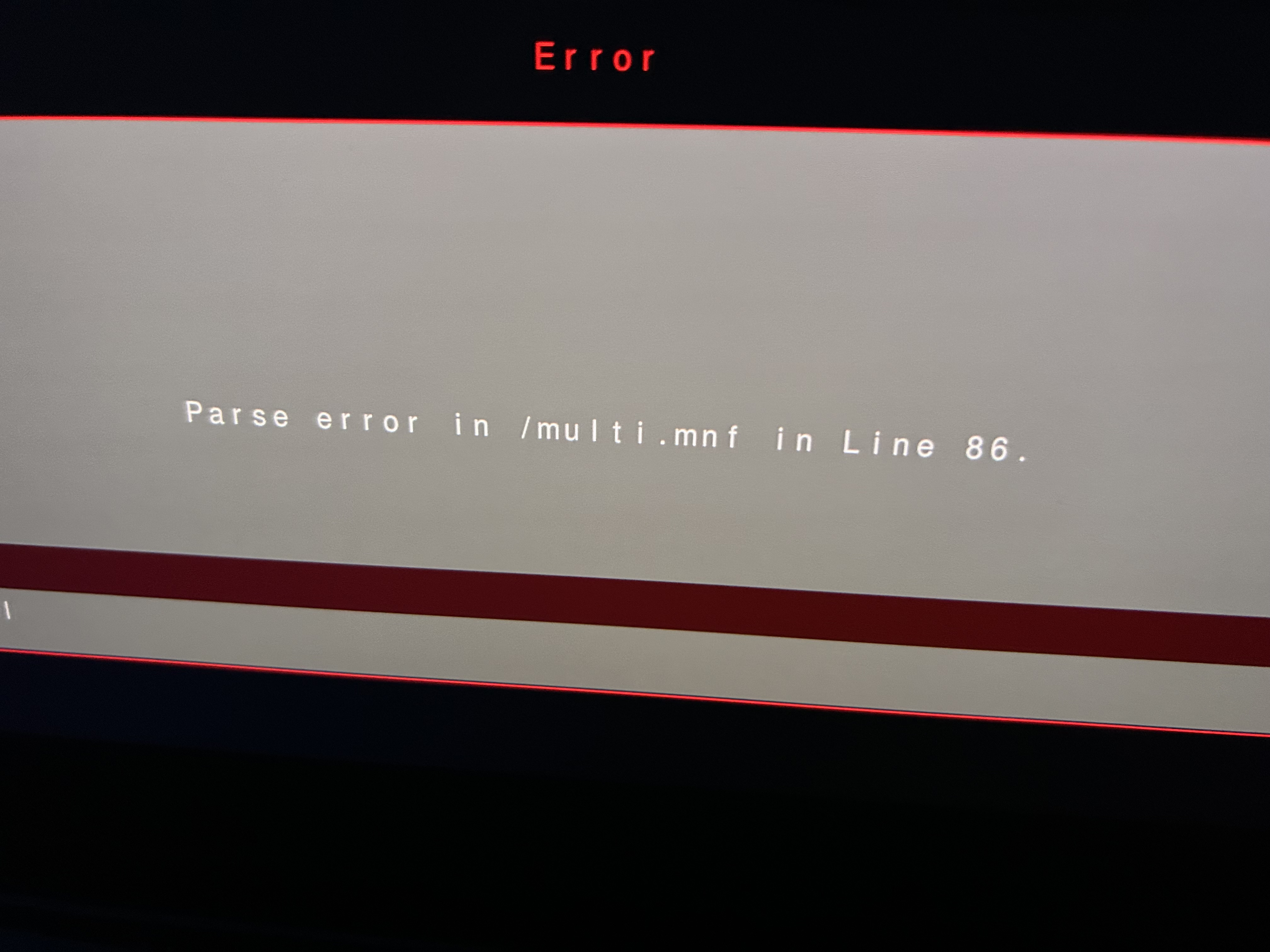

Used windows, it recognised usb-c but produced error message in engineering menu. Will try again tomorrow and take photo of error screen
14 hours ago, Tell said:
Now we get into whether it read the USB and whether the radio serial file incremented. As been said there as missing radio logos still in the file or put another way, not in the file. A further chance that the part code of the unit isnt in the file. It was in MartiniB's why it worked.
This is where I like to say do it this way rather than take the high road. If you used a Mac you'd need to use CleanMyDrive to get out Mac rubbish which will trip validation.
Didnt work. Update screen not shown when usb connected.
in engineering page , usb c detected but error message generated
Over to MartiniB... perhaps it didnt find the part and fell off the end of the script. Historically VW didn't always get all the part codes in for the unit variants of mib2. Possibly a variant of mib3. Worked on MartiniB's thou. It seemed to me they had padded out each VW part with a Skoda part... or it was suppose to be run under a different option.
Did you follow this PDF
https://www.phonostar.de/download/vw/MQB3_Stationlogos_CustomerUpdate.pdf
Line 86 is closing the parentheses... feels like the old days of Algol 😉... just wondered whether you followed the instructions, if you did, it probably didn't find the Skoda part descriptor of your unit... any one ?.

Yes followed PDF.
14 minutes ago, Weeguy said:
Yes followed PDF.
Well it's going to be that your particular unit is left out I reckon. It's those variants that are the units. Gets a line or so from the bottom and drops out.

Where's a programmer when you need one 😂. The include list is less than the variant list so it only covers a subset of variants. That's my reading of that code. Whether your unit is on the declared list at the top, pass. But it's not on the include list for sure.
Any advance on that anyone.
The RW will be rest of the world variants. EU - EU. EE - Easter Europe etc. Other regions.
VW and SK, VW and Skoda. No Seat as we said.
You just have to try it and see whether it works or not. That's the conclusion that can be drawn from this.

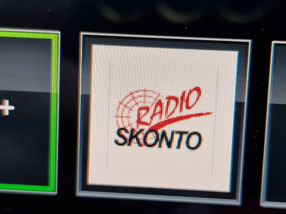

previously i have reported about Mid3 compilation contains less relevant pictures,
that weren't correct info -
in later experiments, i got this how to, for logos which are changed:
1. them must be deleted from Menu -> Logos
2. reboot head unit by long press of power button
3. add new logo under Menu -> Logos
