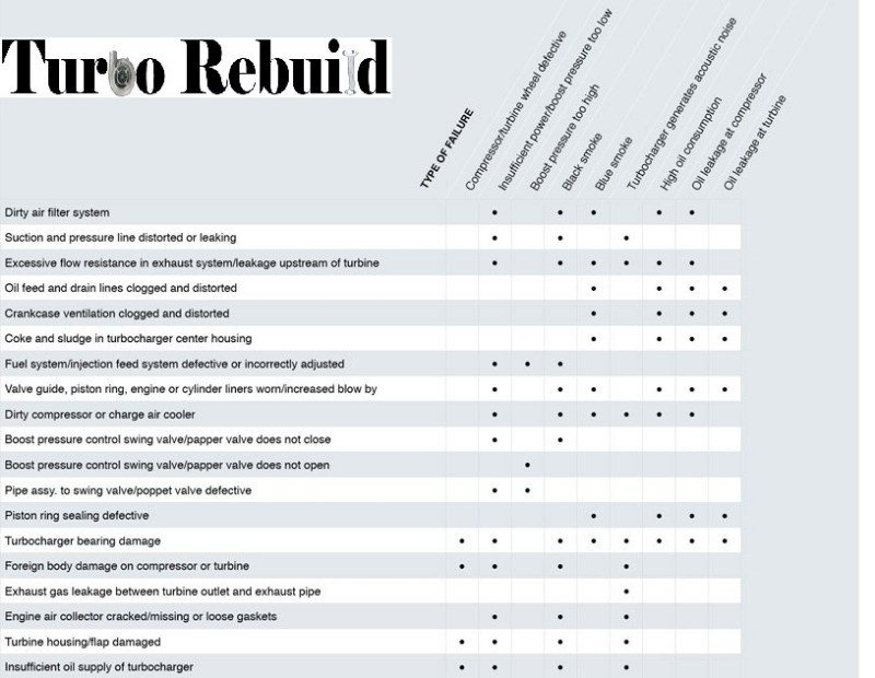

Thanks All for your reply, I also find the attached picture from Turbo Rebuild useful.
Did I miss something on their chart? Variable vane turbo mechanism sticking.
