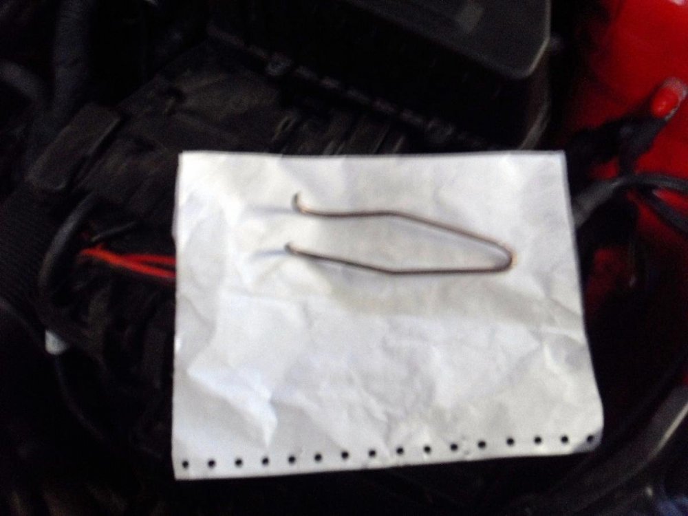

or make your own,  piece of strong wire, a wire hanger is good for this,
bent and a little turn up to hook the cap.  Welding wire is quick and easy to use.

Making one.
Similar to this DIY Ignition Coil removal tool.
Just a different turn in of the bottom.
