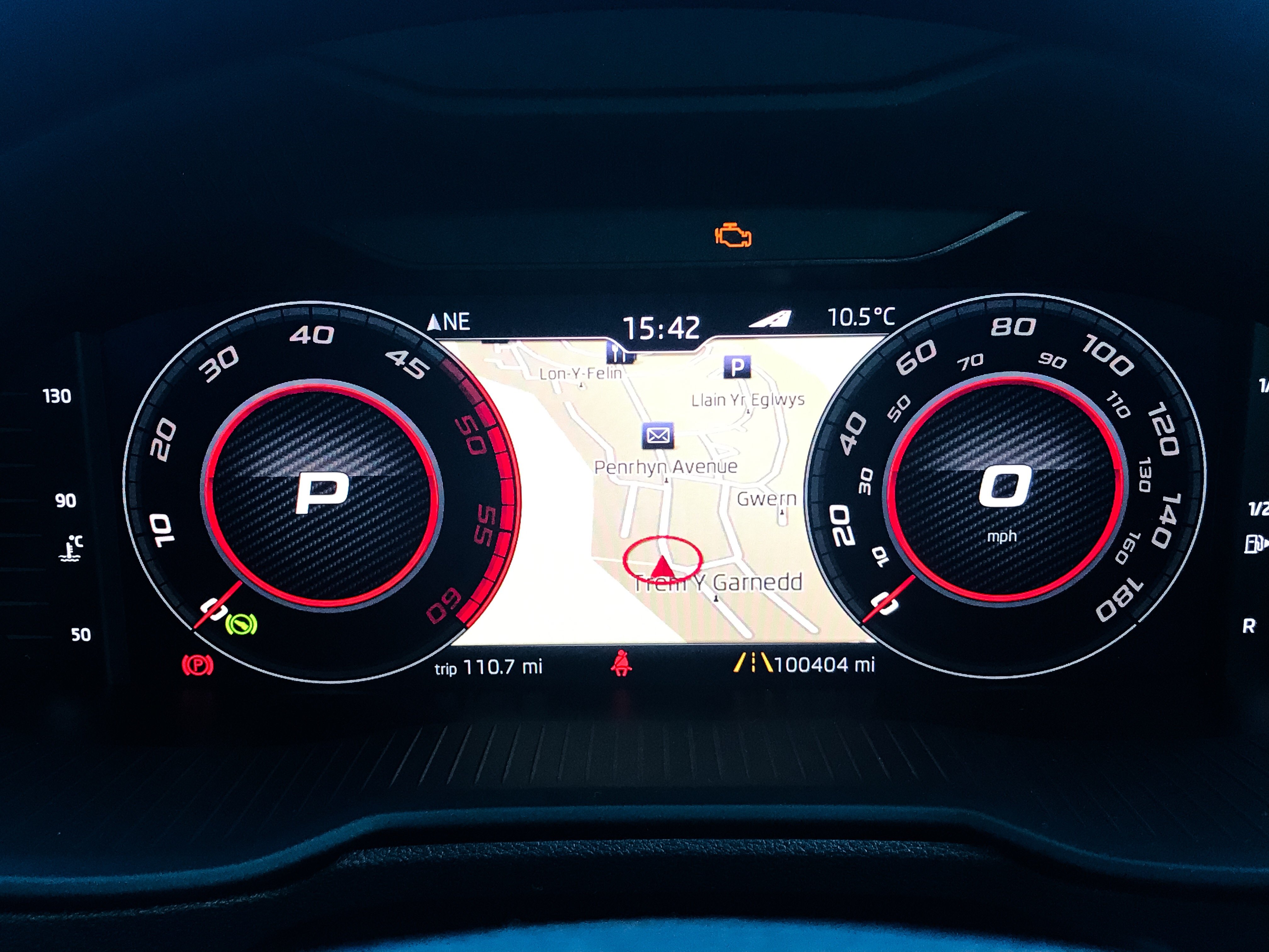

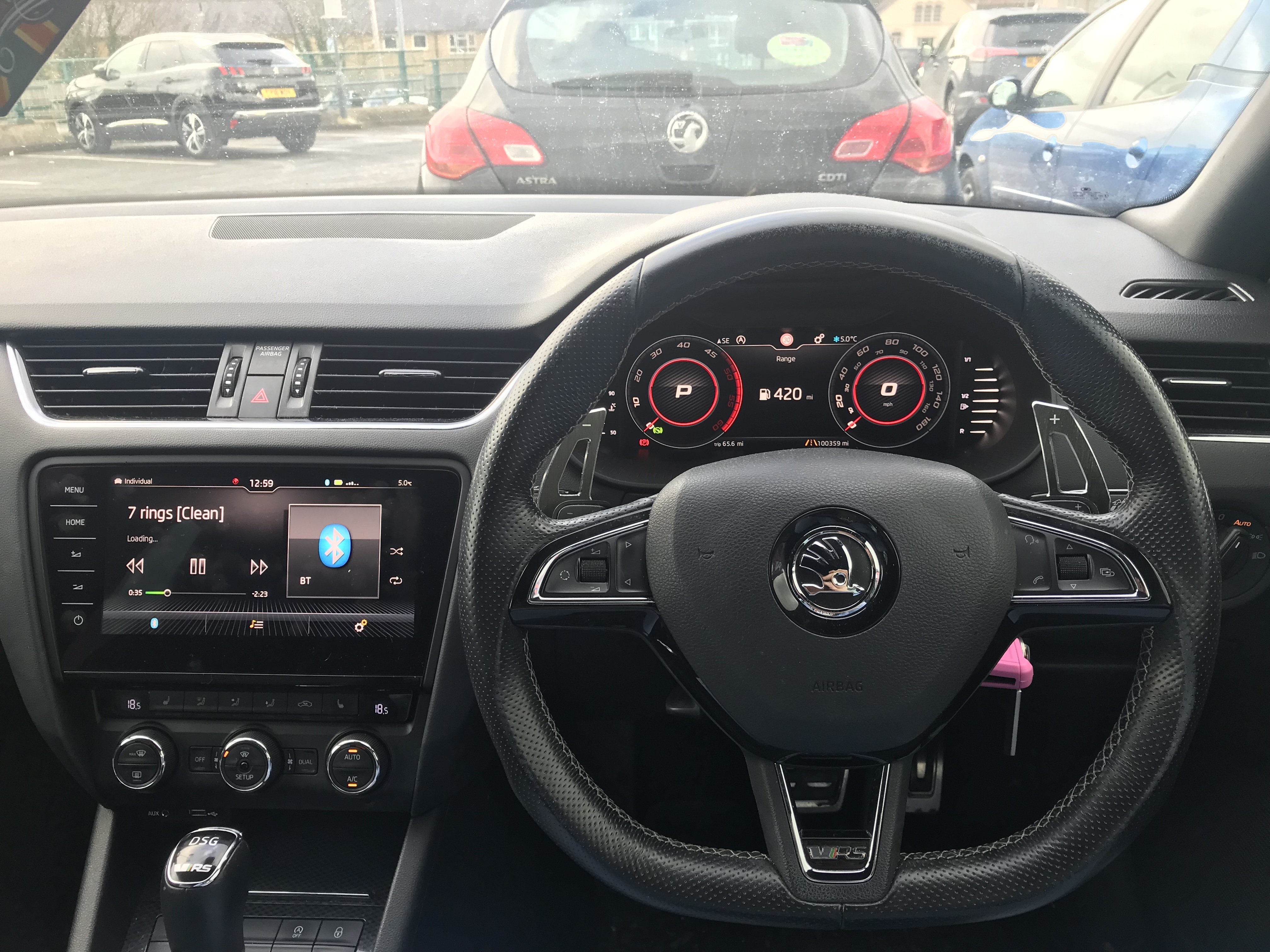

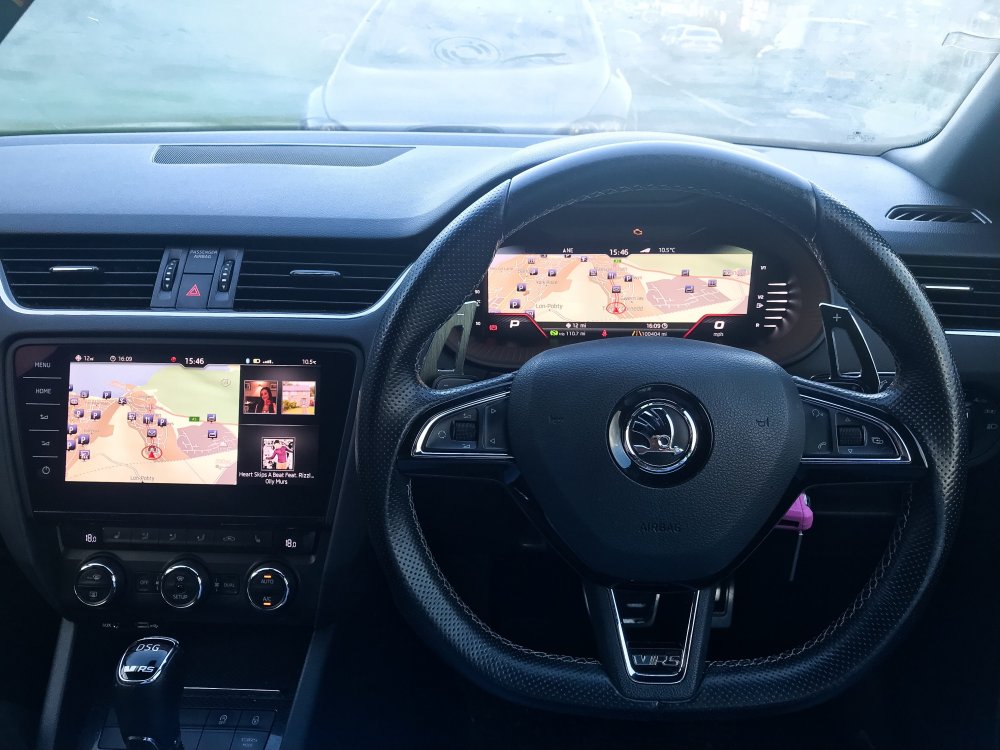

I have retrofitted the virtual cockpit into my 2014 vRS and added MIB2.5 Columbus. If you want to do it right you’ll need a navigation unit, as you have a 2018 it’ll be MIB2.5 Amundsen or Columbus if you have it already and both of these will work as they have the MOST connection. If you don’t have nav then it will still work but you also won’t get image transfer to the VC, so album art etc won’t go over either. You may have the correct CAN Gateway as you have a 2018 car, but you may need to upgrade this to a higher spec one to support the install. You will also need a new set of 2019 steering wheel controls with the VIEW button. Ambient lighting can be done too, you need a BCM High replacement and then thousands of lines of coding to get it going on the radio and cluster. To get the strips in the doors you will also need new door controllers.
Nothing is impossible, but the cost of doing that will be massive. You will also need to make friends with someone with an online copy of ODIS, as without that you can’t make any progress.
@SashaGrace I see from the pictures you did not change the buttons. Is it mandatory? or the Phone button works as the view? and just for display purposes needs to be changed? Any issues controlling the phone or now you have to go within the menus?
Edited by ccosmin
It’s not mandatory, but you do lose some functionality. The main thing is not being able to browse a nav destination on the steering wheel. The phone button works to answer the phone but you don’t need it because when a call comes through the VC displays options to scroll through with the right steering wheel control to accept or hang up etc. No MY19 Octavia’s come with the phone button anymore, just the VIEW button even with a Maxidot. So in a nutshell, you don’t need to change the buttons but you do lose some functionality.
