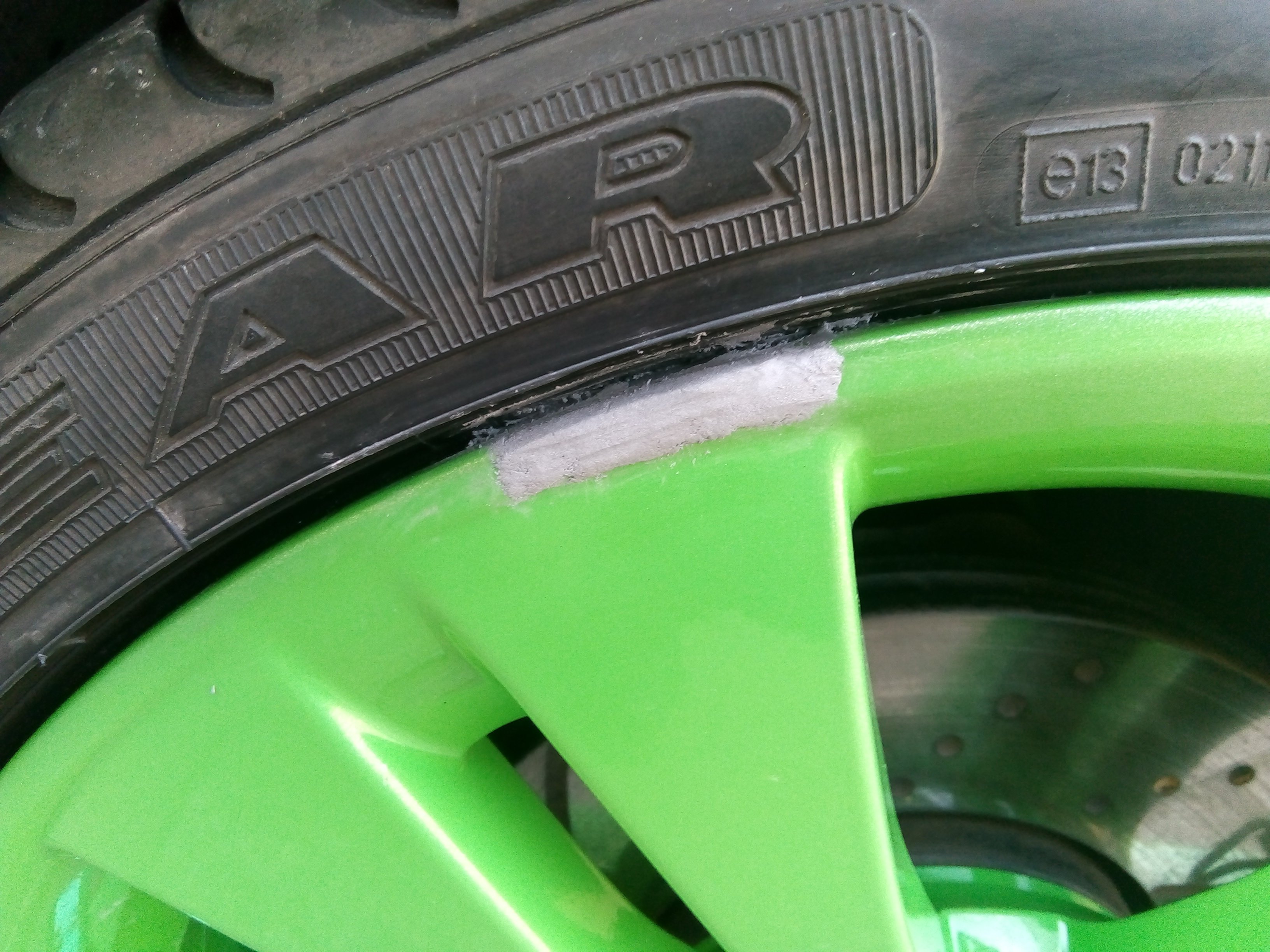

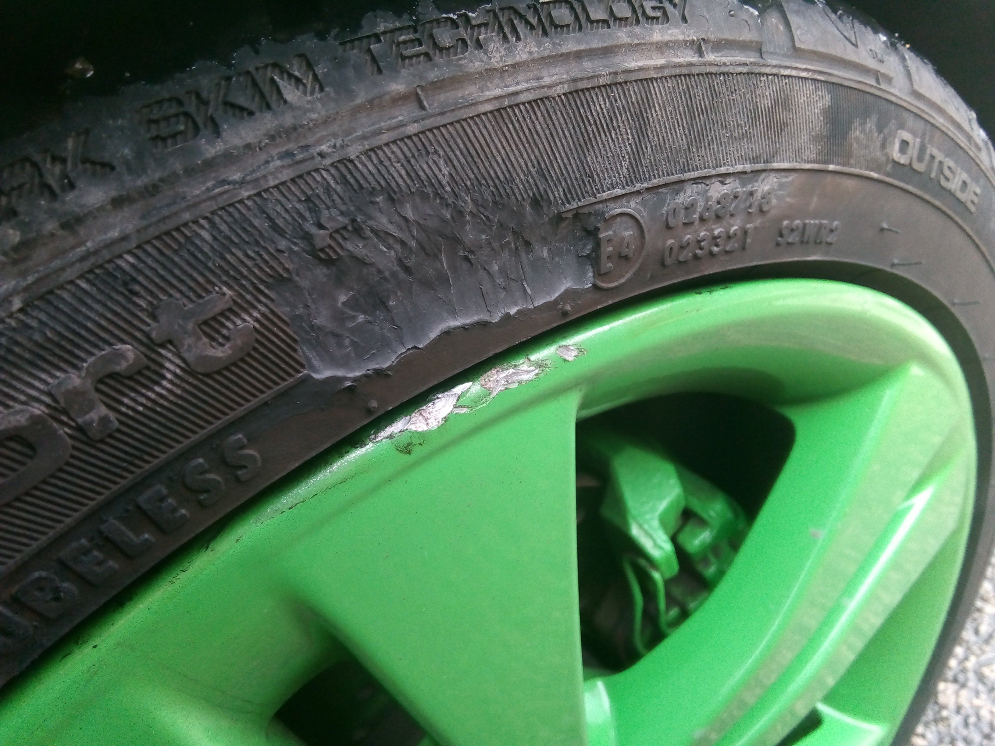

One pothole too many... and this has happened , No guides on youtube for Repairing Powder coated Alloys other than full respray.
1st Question
For the meantime, Looking at home repair using wheel repair putty. i have top coat of paint ral 6018 and clear laquer.
Will this need a fine dremel or sand to smooth out, has anyone used this putty filler ?
https://www.ebay.co.uk/itm/E-Tech-Alloy-Wheel-Repair-Putty-Filler-10cm-Tube-Awp-01/201294506441?epid=1339757949&hash=item2ede1669c9:g:6noAAOSwt~5bexiL:rk:1:pf:1&frcectupt=true
Also since the tyre side wall is damaged this tyre needs replacing and will be replaced as 2 sets at front:

The e tech putty thing is now setting, not my greatest work gonna need sanding levelish then touch up and laquer
