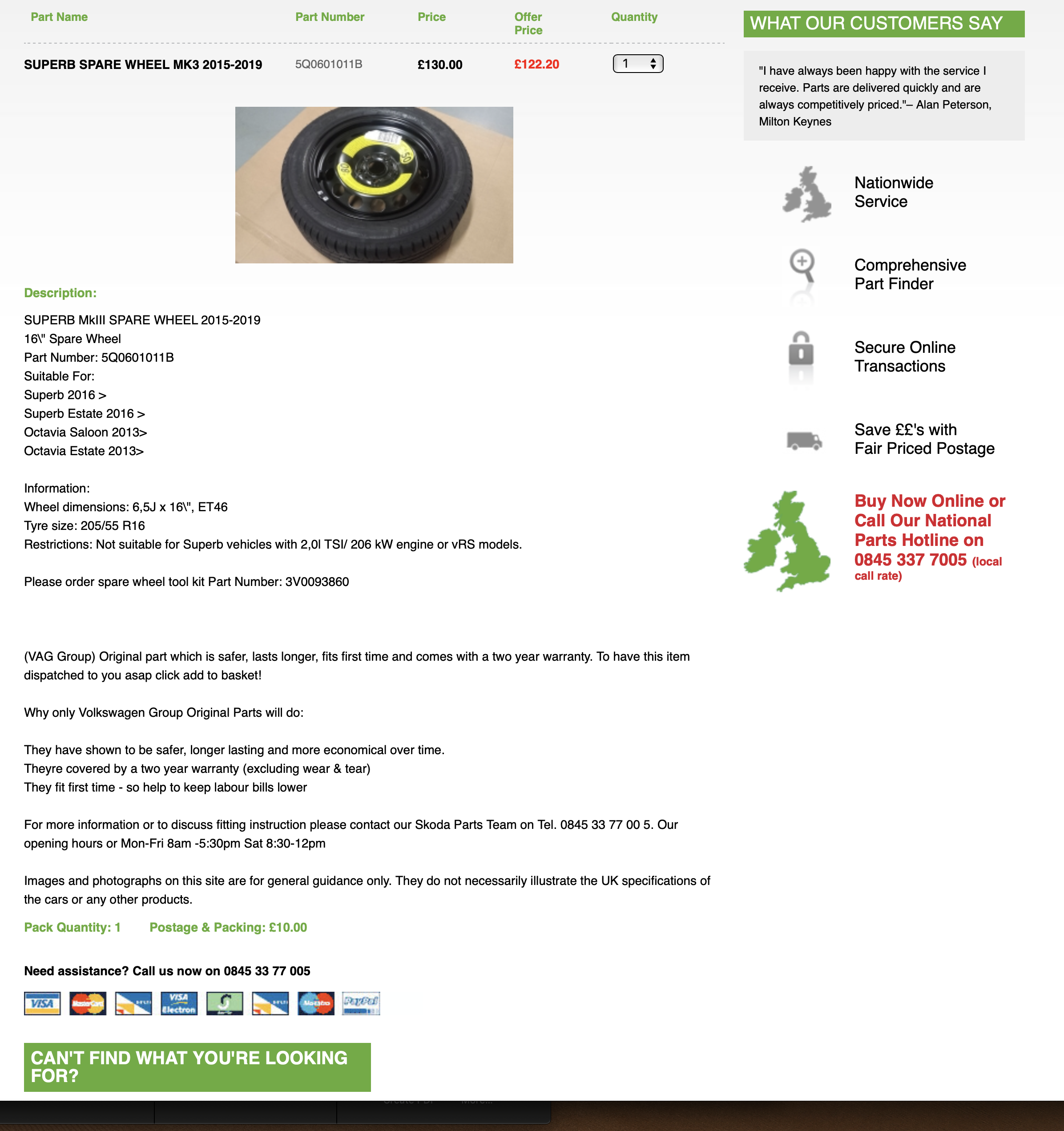

I'm trying to buy the wheel online from the link but there's no 'buy' button - anyone else ever had this issue?

as i wrote above focus also on size of tire
i weren't happy to drive ~80km distance at night with limited speed 70kmh without Cruise Control,
it's deactivated due different(5.3%) diameter of original spare tire,
replaced by full size, but not tested yet
