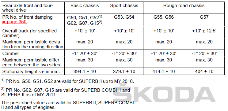

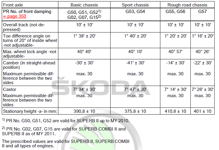

Chassis in this context refers to the suspension setup. It means different springs and dampers as well as different alignment settings.
front_suspension_settings.png.0100c56b43a6188a72553bba39921943.pngrear_suspension_settings.png.1eeea05d292a9d82ba482180ee6fbbb5.png
2UC    SWP   Sports version (suspension = 15mm lower). There are also std, rough road and comfort options according to the online parts manual.

front near as damn it 395-400mm centre to arch, rear stands at a very sporty 370mm  :)
build spec says standard suspension so now i know why with 3 bags of sand in the boot the towbar dragged on the gentle slope to driveway whilst reversing in !

I just went out and measured the ride height on mine, both rears at 380 mm on standard (basic) chassis so looks like it's time for me to get new ones. Any opinions on Bilstein?
