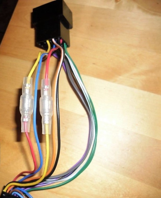

Yellow and red.

I will post a video for you.

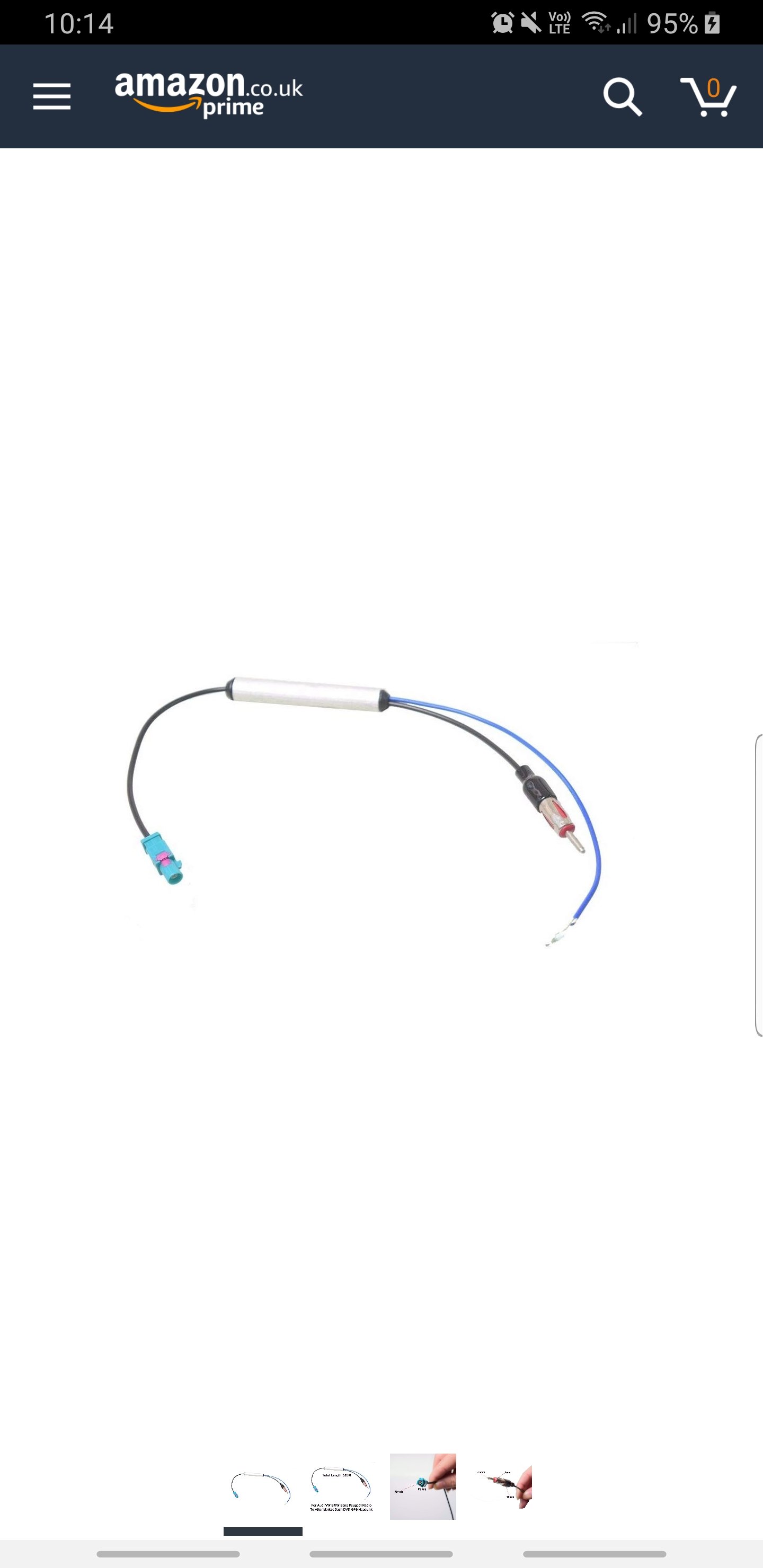

Are you sure you've ordered the right booster? There are different ones for different connections. For example PC5-90 and PC5-52.
Edited by TMB
I typed in signal booster for 2004 skoda fabia signal booster and picked one that said its from stock radio to after market with a signal booster.
Cheers mate, iv sorted it now iv ordered then one of the link you have sent me.

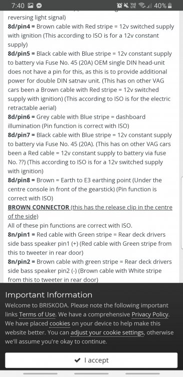

Hi TMB i dont have red or yellow on my iso connecter, there are 2, black and blue wires and a brown and red one. I know i have to connect the brown and red wire to one off the black and blue ones, but im unsure which one.
Cheerz
  • Sponsor
Black/blue wires are both permanent 12V off fuse 45 as far as I can see. The Brown/red is off the 'S' contact of the ignition key, via fuse 10 (live as soon as the key is put in, I think).

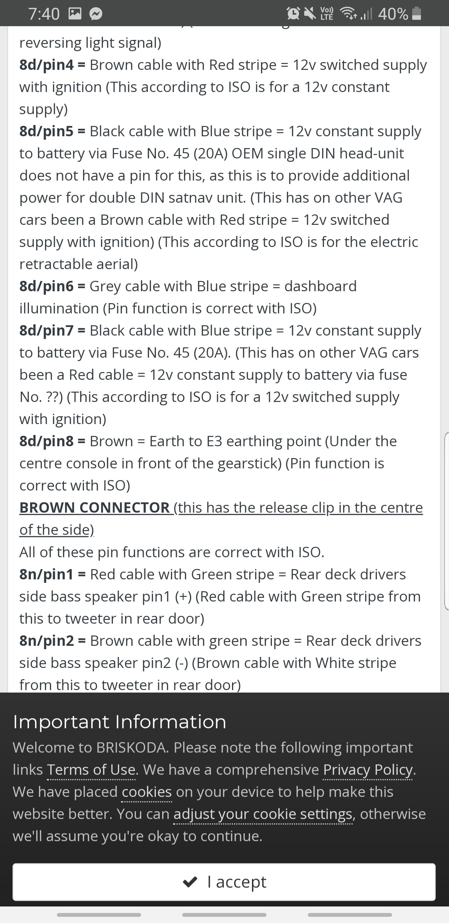

No but i used this picture off another post and its right
  • Sponsor
That's the pinout of the car connector though, isn't it, rather than the mating connector in the back of the radio.  You need to know what the radio needs on each of the 8 pins.
