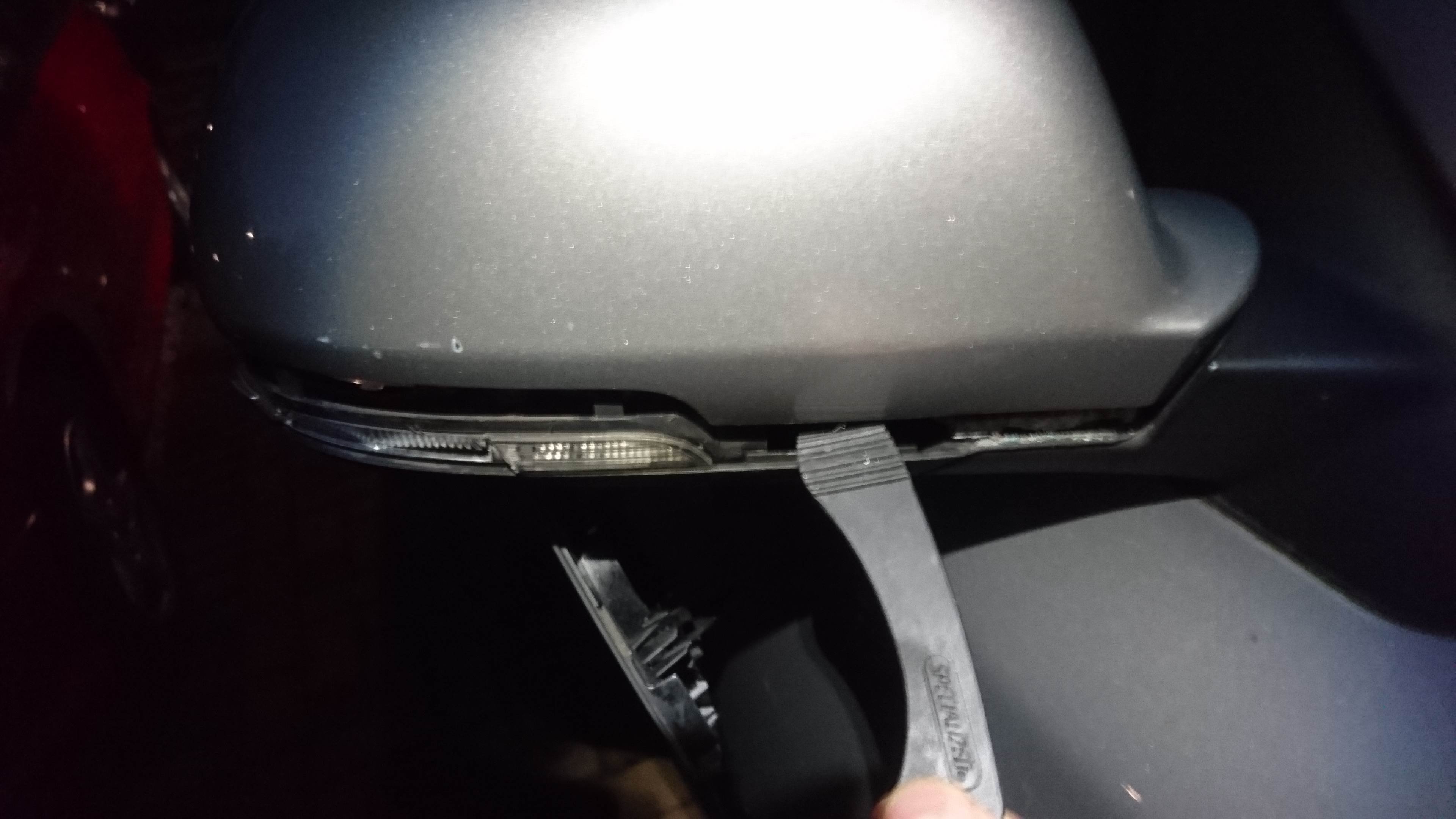

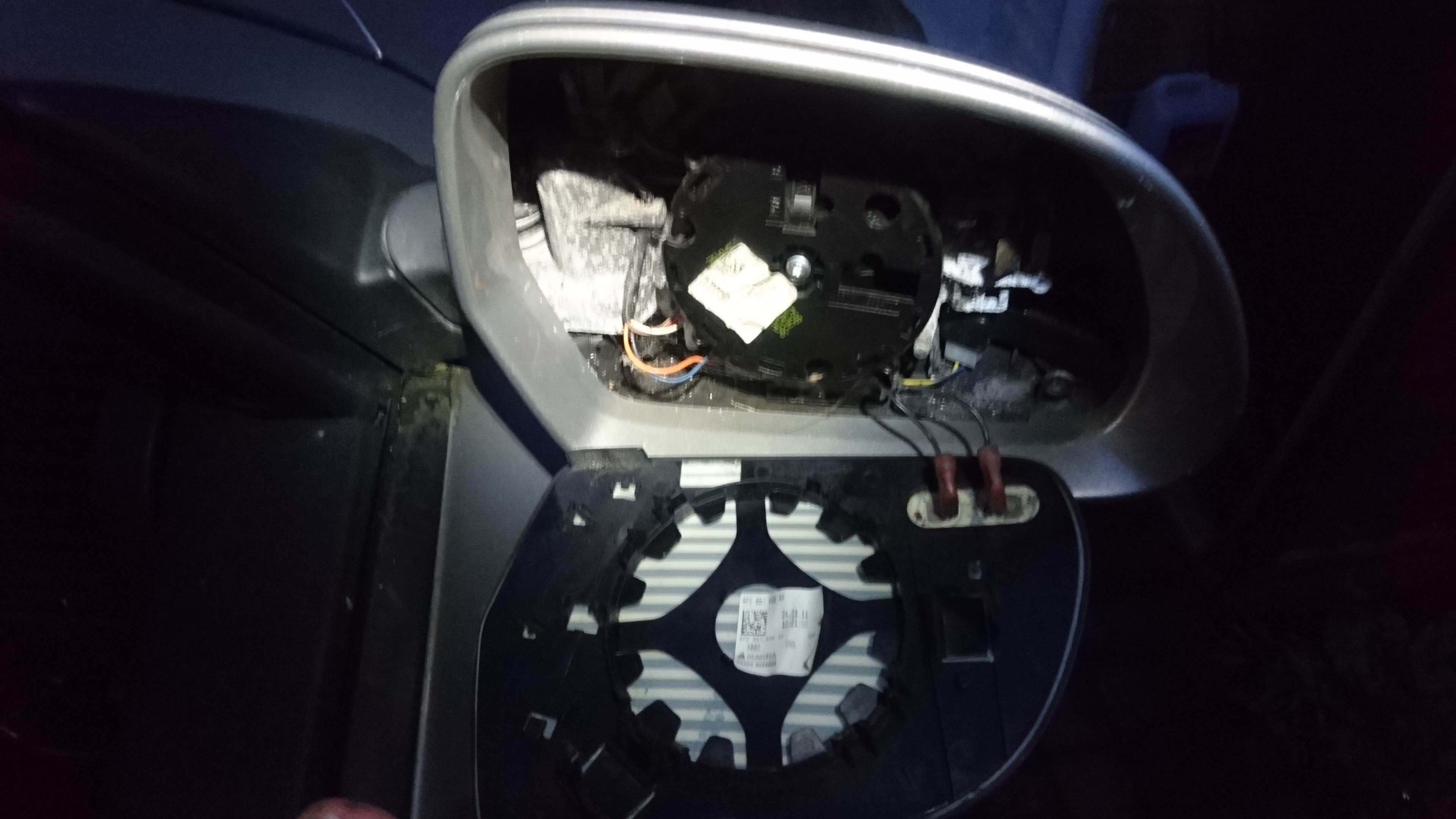

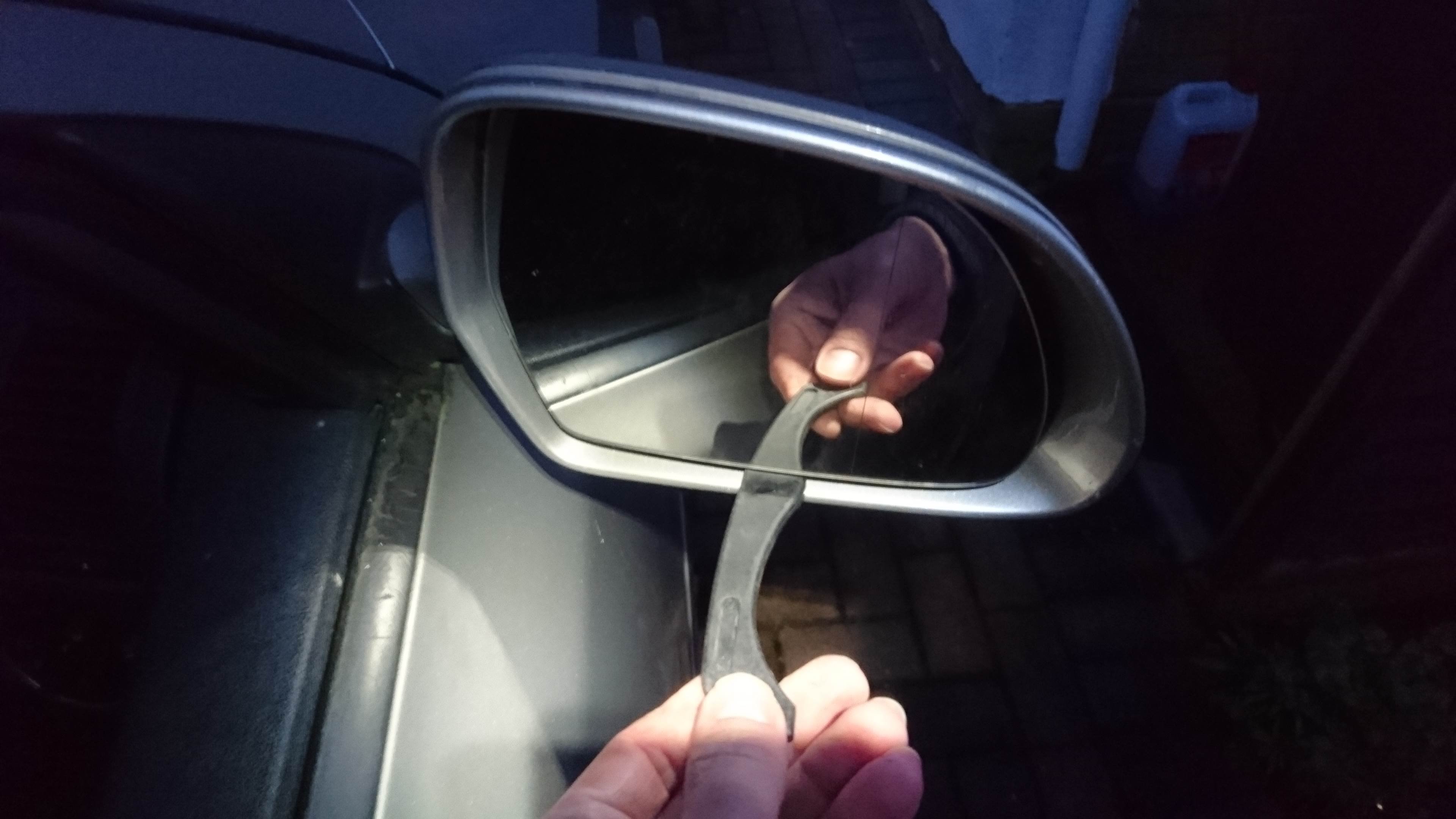

1. Tilt the mirror fully upwards, then using a plastic pry tool in the created gap gently lever the wing mirror glass off. There are two main clips holding it in and a few smaller ones connecting it to the movement mechanism
2. (if you have it) Mark one of the 2 wires connected to the heated glass so you can re-attach later and disconnect them

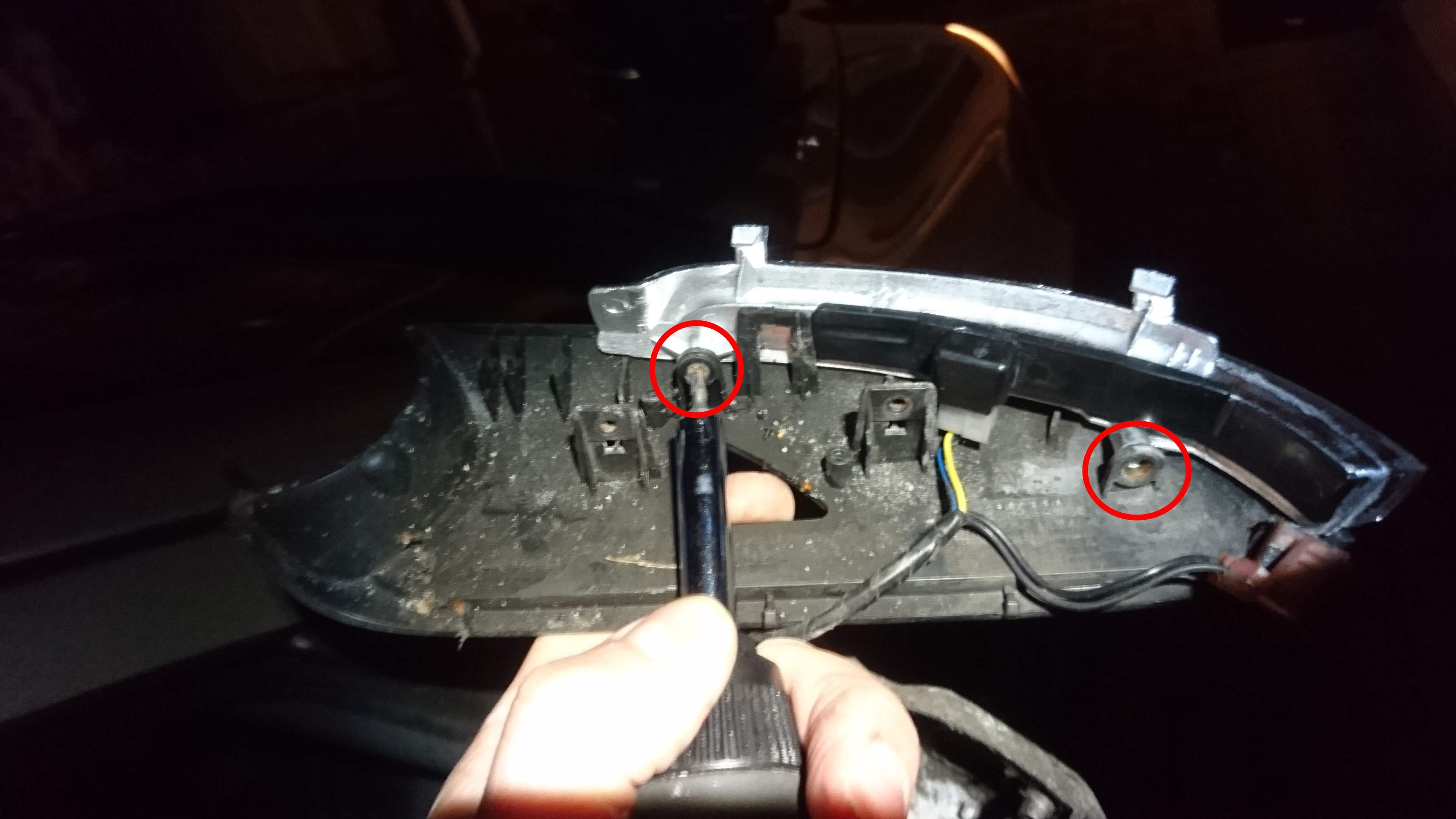

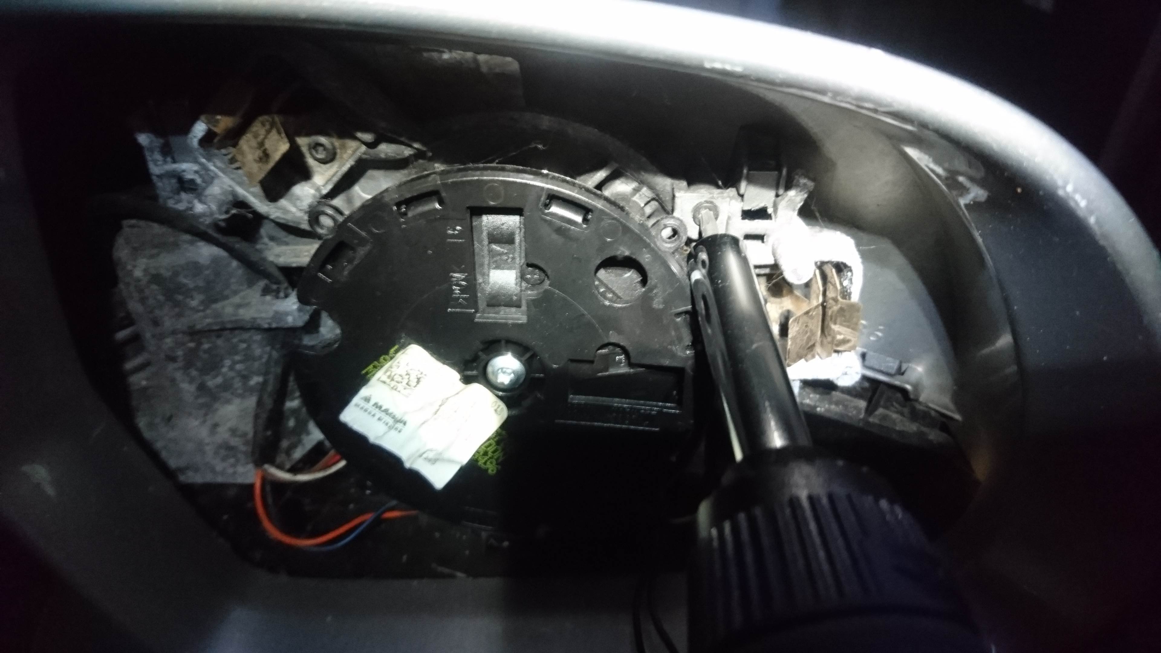

3. Next up is two T10 screws, one on the inside & one on the outside that hold the rear plastic on
IMG_20190318_184147_res.thumb.jpg.5643e7347c5f1aae39884e7448612757.jpgIMG_20190318_184201_res.thumb.jpg.f4387ba6d3edd6760f5d6bc0ae3f8039.jpg

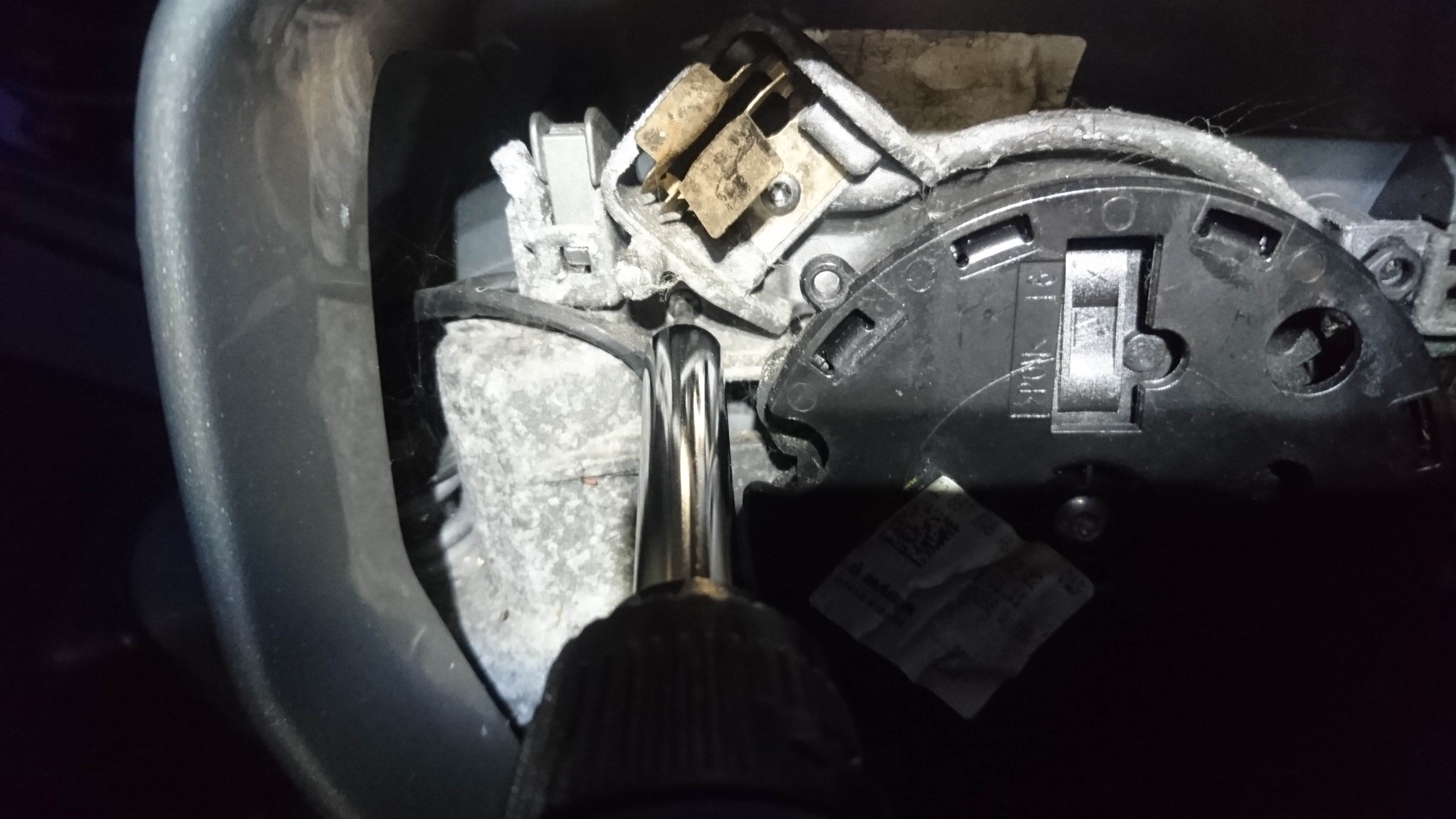

At this point I removed 3 further T10 screws holding the mirror movement mechanism in place, however as I found out this wasn't necessary

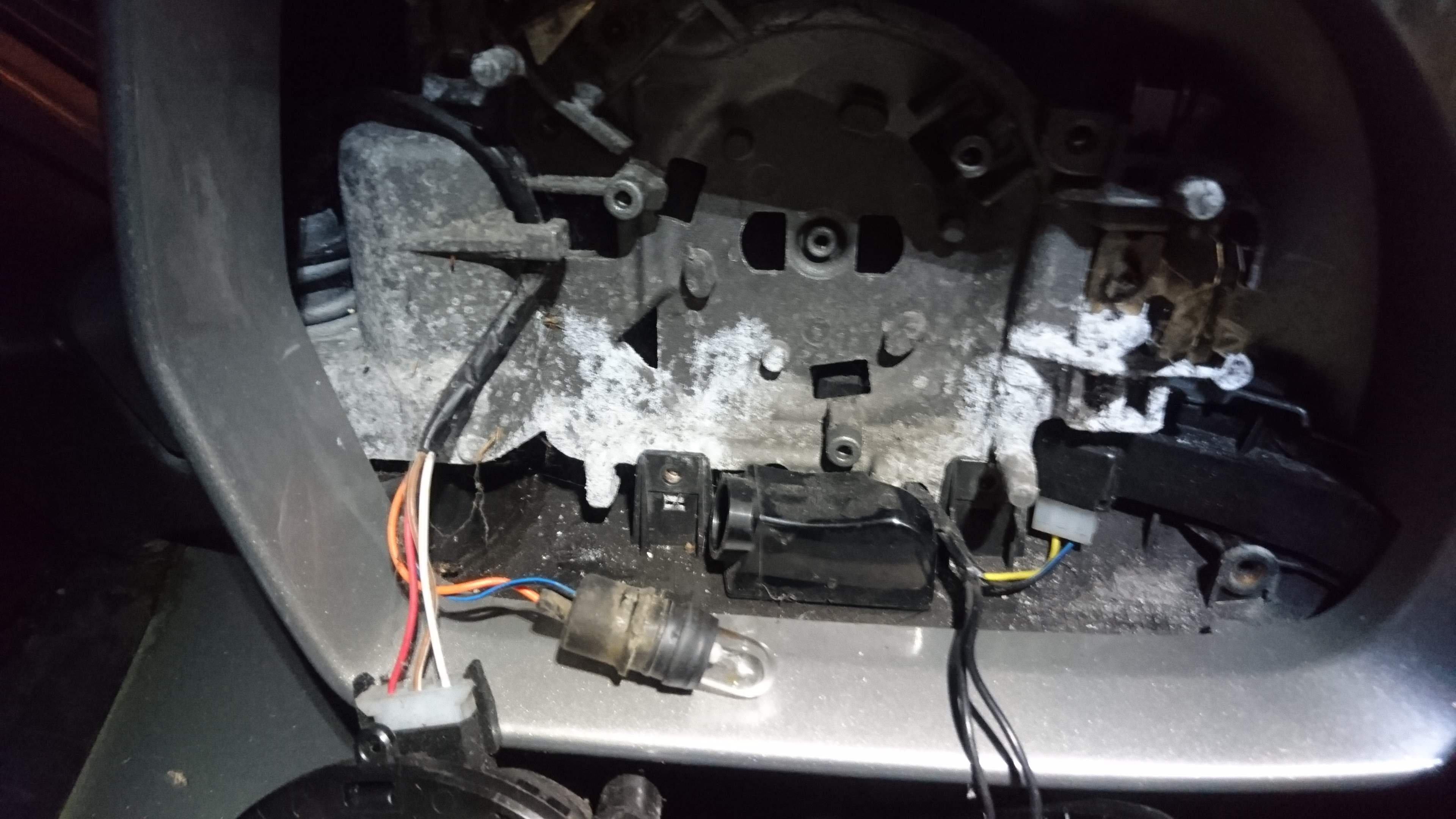

5. Pull the bulb out of the puddle light bracket, I found a light spray of WD40 made it much easier to pull this out (and re-insert). The bulb just pulls out of the rubber fitting.

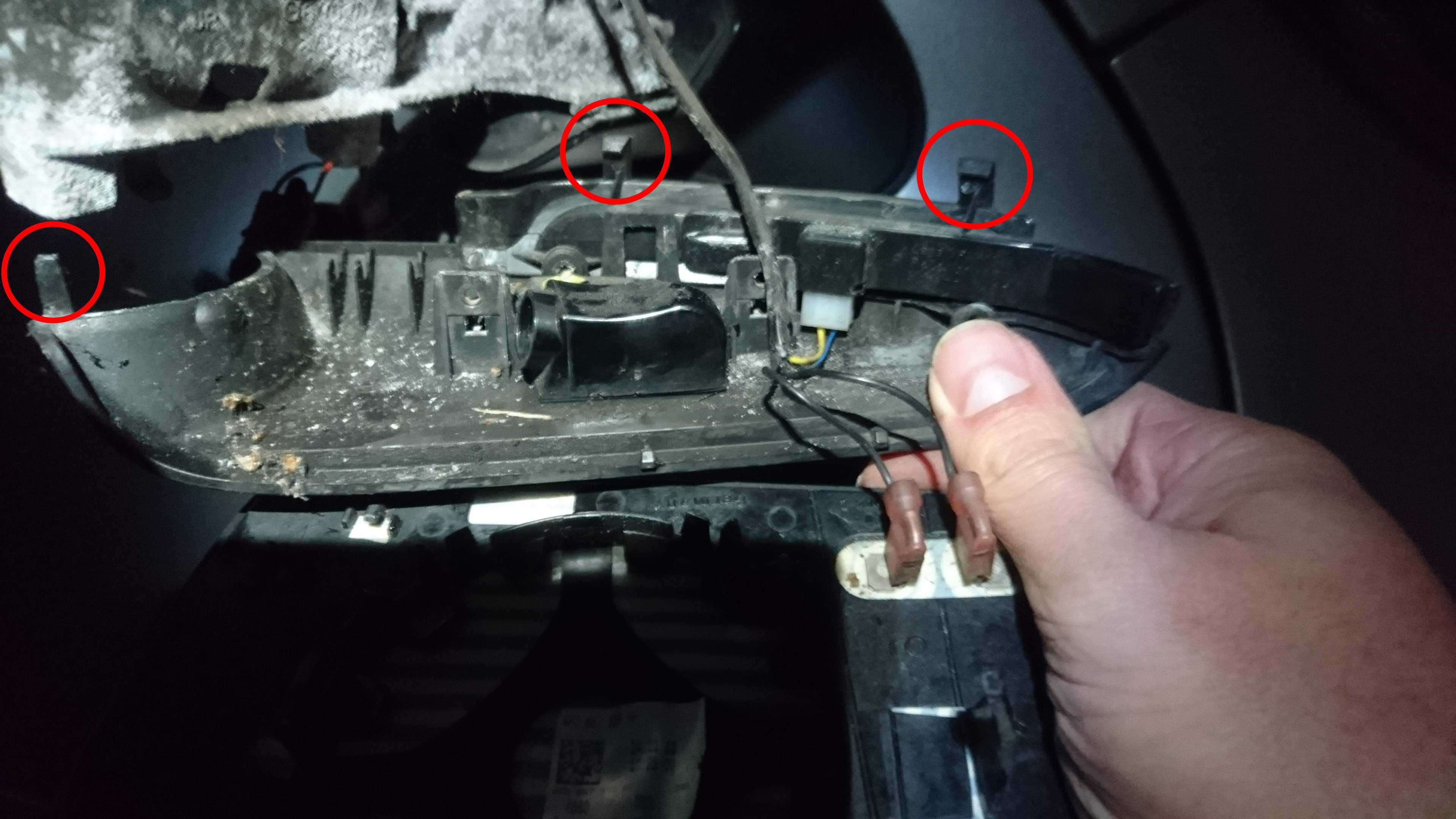

6. The lower section is held on with 3 clips highlighted in red, I used gentle downward pressure and the tyre lever to pry it off. Now 2 more T10 screws are accessible that hold the puddle light assembly on.
7. The final 2 screws that hold the indicator assembly in are now accessible, remove these & the indicator can be unplugged and swapped for the replacement unit
8. After testing to make sure the replacement indicator works, reassembly is then the reverse of the above, being careful to line up all the plastic clips before sliding everything back into place. A spray of WD40 was applied to all the electrical connectors for good measure. Note that the power cable for the indicator and puddle light comes down the front of the mirror housing, before coming back under for the puddle light.
